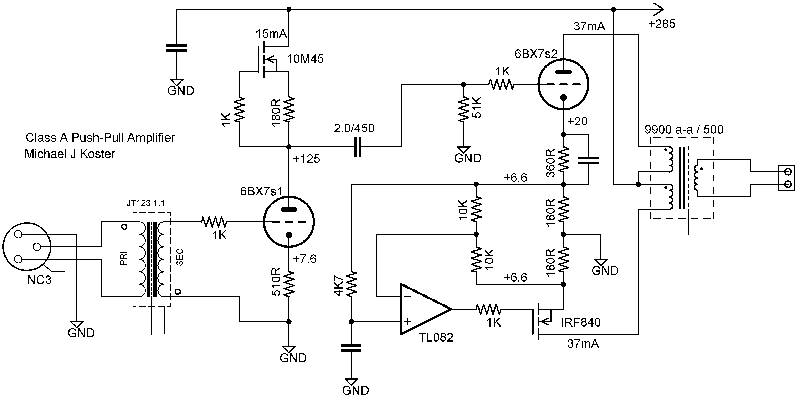

I've been playing with a tube/MOSFET hybrid of an unusual design and I thought I would share my experiences. This group seems to be receptive to wacky ideas.
The idea was described on this forum some time ago by forum member smoking amp. It would work with either a MOSFET or a good NPN darlington, like a horizontal output from a TV circuit.
Basically, the idea is to build a push-pull amplifier using a tube on one side and a MOSFET current mirror on the other.
I've implemented it using a cathode current bridge and an op amp driving the MOSFET to self-null the bridge for AC signals. The result is an exactly opposite signal current through the MOSFET, which is applied to the other end of the PP transformer primary.
The DC balance is done simply by LPF'd positive feedback to the op amp + input where it provides a DC reference for the bridge. This may not be the best scheme for transient response as the transformer gets unbalanced by the "distortion current" at high signal levels while the LPF settles. Maybe tune it but that's another story...
Anyway, I've tested it so far on a resistive load and it's very well behaved, with essentially SE harmonic profile. I used a 6BX7 because it's predictably non-linear ;-)
100mW .95% THD
250 mW 1.5% THD
1W 3.1% THD
4W 5.5% THD (Design max power)
with the residuals mostly 2nd harmonic (f2) with a "waterfall" series of f2, f3, and a little f5 until higher power, when the higher order harmonics show up at the onset of output stage grid current.
I think I'm done on the bench and ready to hook it up to a speaker to see what happens with a reactive load & through speaker resonance. If the concept is going to break down it should show up there.

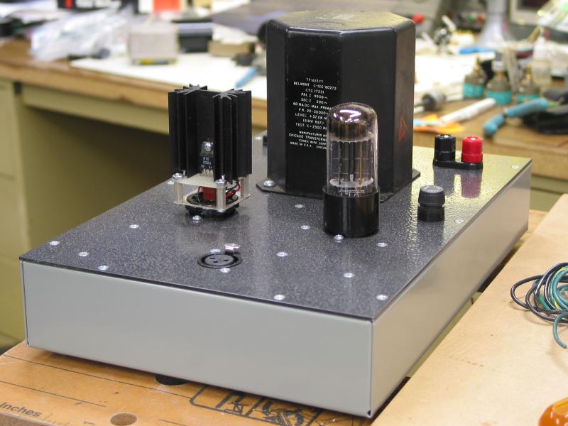

I'll post the plots and other pics but it looks like I can only do done at a time.

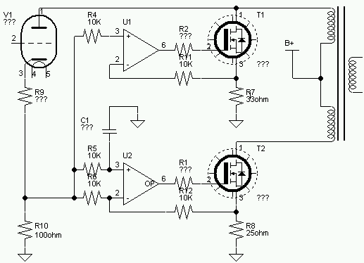

Before we get a dozen posts about the MOSFET being backwards, here's a corrected schematic.
Michael
Michael

I would bypass a cathode by cap taking from it DC only that reflects current through triode using this voltage to bias an opamp,
resistor of the same value (un-bypassed!) would use in emitter of a transistor (in source in your case), taking feedback by current from it.
Also, I would feed both triode and opamp from a phase splitter balancing signals for less distortions.
The idea I got from my previous hybrid design where I used a voltage follower loaded on a voltage to current converter. It sounds pristine clean, while if to replace a voltage follower by a triode there will be a "SE triode sound" instead from a small push-pull transformer.

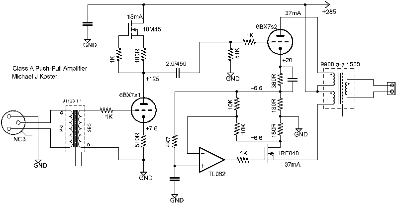

Here was the original:

Don, what about this one? 😀

Re; Wavebourn "Don, what about this one?"
Hmmm, are those diodes supposed to be thermionic ones? I think this will make for lots of distortion, since triodes are supposed to have constant Mu, not be diode functions. This looks like emulation of the problems, not the benefits, of triodes. Back to the drawing board.
Since we are on this diode kick, I have seen a patent for a SS amp where they put thermionic diodes in series with the output transistors bases (usual emitter follower output, complementary totem pole), so they would have transconductances similar to tubes. Only problem is, it is similar to pentodes, not triodes. But maybe it helps with smoother crossover.
Don
