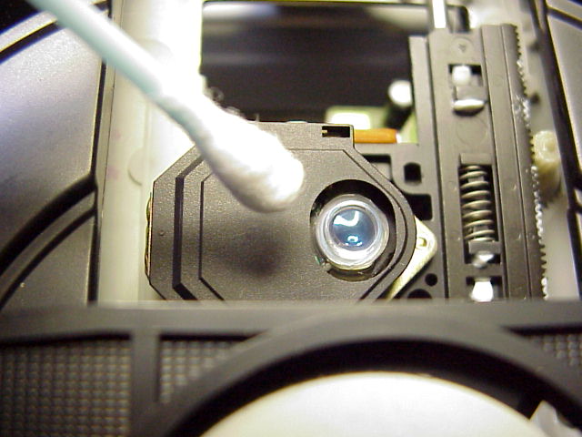

Cleaning the lens is done with a little cotton stick.
Nothing-difficult here.

Bricolo said:
a dry cotton stick?
can't it put some fibers on the lens?
First thing to do before cleaning the lens is cleaning your ears with the stick...:devilr:
Just kidding
Don't worry about fibres. I clean them everyday with the cotton stick. You can wet the stick with a little water (just a little).
/Hugo - First cleans the lens, then his ears..:clown:
You can also go to a camerashop and buy one of those soft
brushes with a rubber ball for blowing air that are used to
clean camera lenses. That is nicer to the lens than the cotton
sticks and doesn't leave any fibres. To the contrary you can
blow fibres off the lens with it.
If you use a wet cotton stick, as Hugo suggested, I would not
recommend water, since it may leave stains on the lens. It is
better to use isopropanol. (I cannot guarantee 100% that
isopropanol is always safe to use, but AFAIK it is not harmful
to any type of plastics and I have used it myself on CD lenses.)

I personally never use anything else then a bit of distilled water.
Long ago I saw a lens melting with ISo...
I kept cleaning cause I thought the lens was so dirty I couldn't get the dirt off.
But it was the lens melting...😉
/Hugo
Yes, distilled water should be OK, of course, but avoid tap water
(or lake water or whatever).
If you really were using isopropanol and not some other
alcohol I take back my previous recommendation. I have never
heard of it harming any plastics and it is often recommended
for various technical cleaning because it is supposed to be
safe for plastics. Since the lens you cleaned must reasonably
have been made of plastic, it is obviously not always safe to
use isopropanol, however.

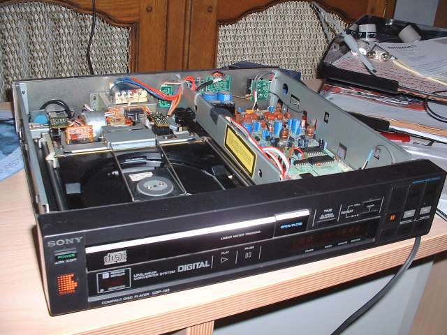

mine doesn't look so nice 😉
now, it plays original CDs, I tried a brand new CD, it has difficulties to read it (scanning for 2 minutes)
I don't know if it's because I tried to clean the lens with a cotton stick, or with I never waited 2 minutes before
oops, I told this too fast
I had luck to be able to read a cd after only 2 minutes of scanning
with another try, it scanned fot 15 minutes without reading the track
when it scans, i can hear brr brr brrr brr brr brrr, like if the optical reader is going front and right and front and right... to find the right place to start reading
is this a known problem?
If you use a wet cotton stick, as Hugo suggested, I would not recommend water, since it may leave stains on the lens. It is better to use isopropanol. (I cannot guarantee 100% that isopropanol is always safe to use, but AFAIK it is not harmful to any type of plastics and I have used it myself on CD lenses
No, this is not correct. It is harmful for the coating on the lens and in the case of plastic lenses the lens itself can be damaged.
Clean the lens with some water ( distilled is the best and leaves no stains ) with a little bit of soap in it. The soap you use for dishwashing is OK, especially Dreft is good for cleaning lenses.
Dip the cotton stick in the water and pinch it to loose the surplus of water. That way the cotton stick can't drop water in the laser.
The coils hate water. Then make circles while cleaning and continue till the lens has that blue look again. After cleaning do this again with water without soap.
NEVER USE ALCOHOL ON CD LENSES, you will "clean" off the coating ! I am again surprised that there still are people that recommend this very wrong method.
Clean the rods with a cotton cloth and use some very light oil. a drop is too much, just a little will do. Like Hugo said.
If it still skips it is probably worn out and only replacing will solve problems.
the player is able to play a cd, after having seeked for a while (some minutes in some cases)
doesn't this mean that the reading parts are ok?
My 2 cts (my newbie's 2 cts) is that the mechanism that places the laser isn't accurate
