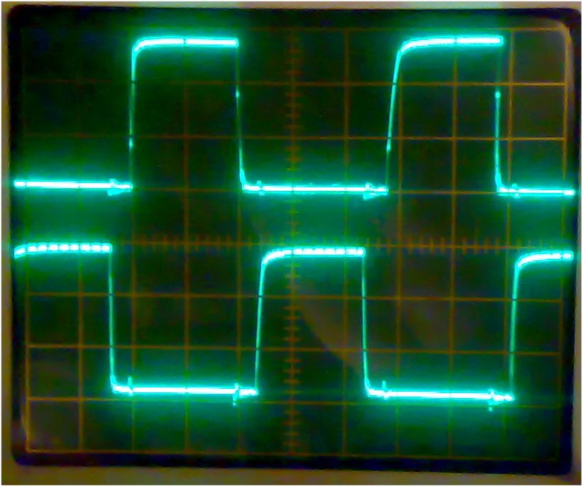

Leakage inductance of current measurement shunts introduces a zero at F=R/(2*pi*L). This effect is cancelled by adding a pole at the same frequency. An RC lowpass does the trick, F=1/(2*pi*R*C).
Ringing is another story. It comes from LRC resonators made out of circuit parasitistics. A TO-247 may easily exhibit 20nH total parasitistic L, while 12nH is the typical figure for a TO-220 with short leads. Then it comes PCB trace inductance. Transformers are evil because they exhibit complex parasitistics due to capacitance between turns of different windings, non contiguous turns of the same wnding and distributed leakage inductances.
Spikes may be a sign of cross-conduction or too fast hard switching. They appear bigger than real due to the zero in the unfiltered shunt frequency response. They also cause energy to be sotred in parasitistic RLC tanks and to be progressively released during a long period of time resulting in ringing.
Leading edge blanking allows to get rid of spikes. Consider keeping current limit inactive during the first, say, 500ns of the cycle.

I have tried with 1uF and the spikes after the low pass filter are now around 20mV. It seems to be ok but what about the speed of the current sense circuit?
The crossconduction problem seems to be quite confirmed. The mosfet starts to heat up after about 10 minutes (no heatsink).
I will try to increase the dead time
I have tried increasing the dead time but the results is always the same.
Now I have around 400ns of dead time but the results are basically the same as before.
The shunt and the mosfets still heat up at idle (with no heatsink).
Attached you will find the gate waveforms, it seems that the gates are driven very fast and with a good sqarewave.
BTW: I am using the UCC37322 as gate driver IC. This IC can sink or source up to 9A peak. The mosfets have 300nC QG (one pair of 150nC each).
