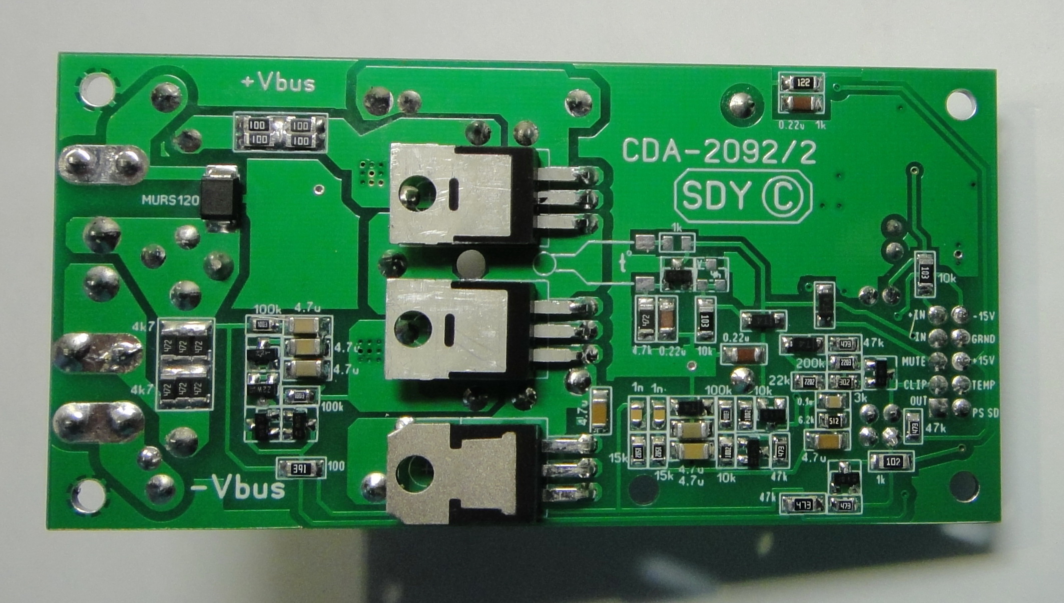

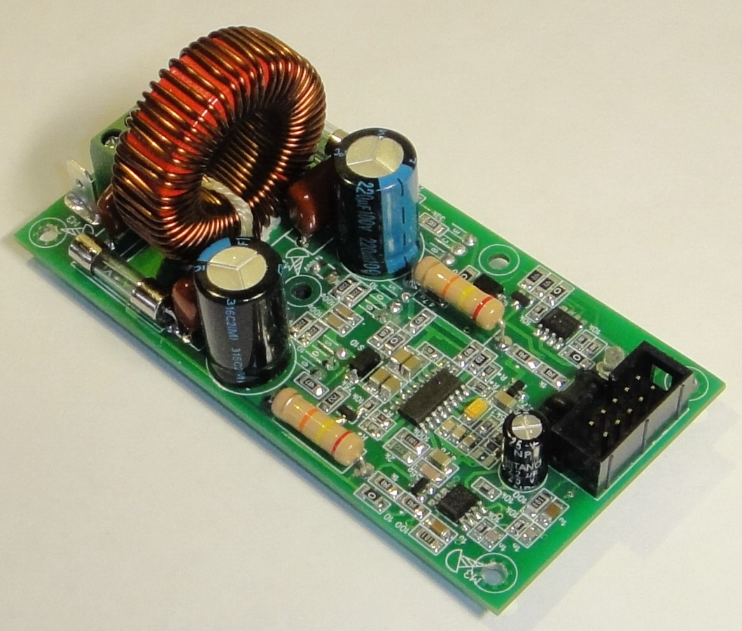

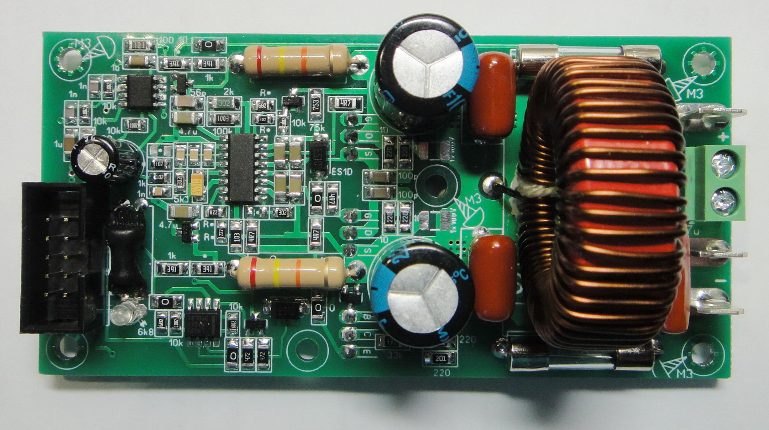

Maybe you used fake 2092 , 4227 ?
I made over 100pcs of these amplifiers , 80% with 4227 without any buffers , directly from 2092 via 4.7Ohm. DT set at maximum . Temperature of the 2092 is about 70 deg of Cel. Frequency - 300-330kHz. Many in bridge mode.
No issues.........

Dimonis, I have two amplifier modules that are for the Gemini HPS-215 BLU series powered speakers, that uses the IRS2092S driving two IRFB4227,I am suspicious that some of the values used can be wrong, will you be willing to share the schematic of your amplifier, if just the amplifier section?
Thanks.
