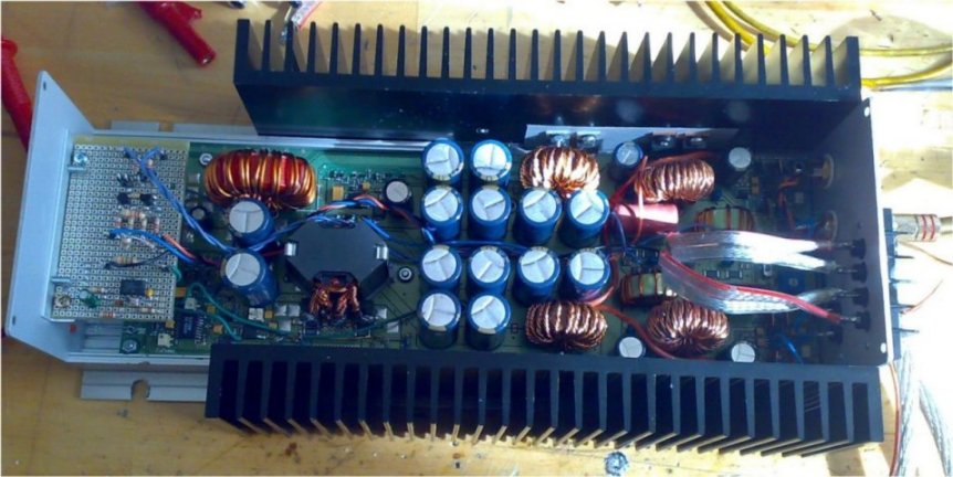

I will try to rewind the transformer using your suggestion. What do you think about the core I have chosen? You think I should go for a toroid?
Attached you will find a picture of the finished amp.
thank you

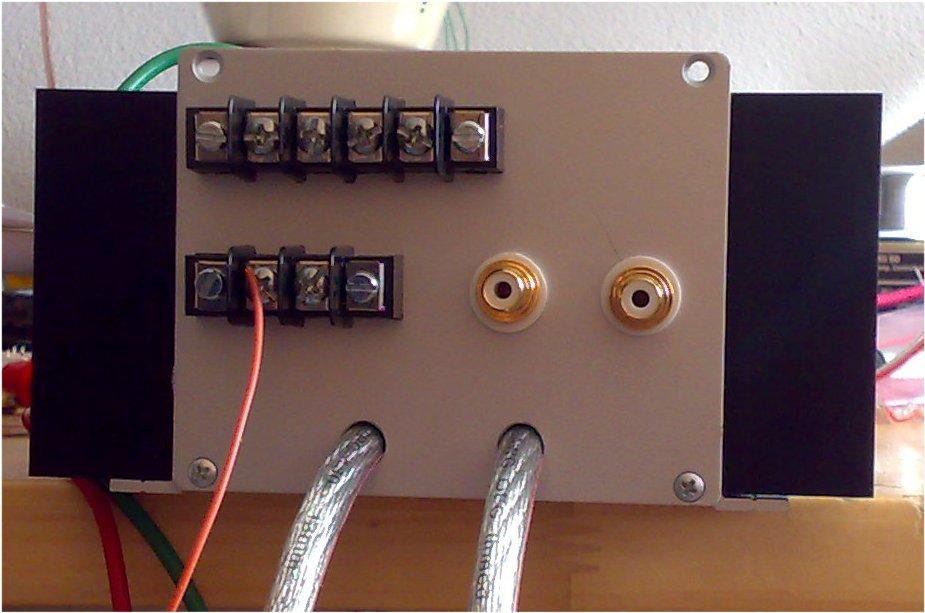

Picure of the back panel
First row are the speakers output connectors,
second row is the remote switch on (both terminal in parallel).
On the right there are the two RCA input connectors.
No connectors for the 12V power supply, just two 6 AWG cables
direcly soldered on the PCB.
