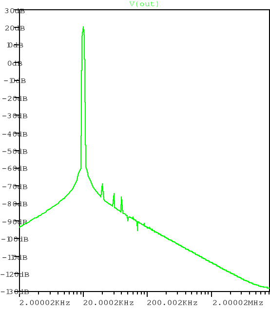

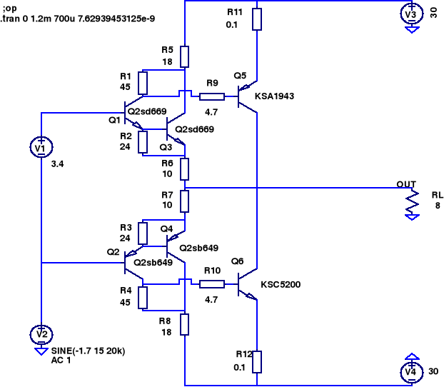

I have done some preliminary simulations for the following topology, which develops further on the Mikhail Kulish error-correction scheme from these diyAudio threads:
http://www.diyaudio.com/forums/showthread.php?postid=1277614#post1277614
http://www.diyaudio.com/forums/showthread.php?postid=856982#post856982
It is possible without much optimization to get THD of around <0.01% (2HD, 3HD components are both around -80 dB) in this voltage follower *without global negative feedback*.
The circuit as shown can deliver 14W into 8R with THD <0.01% at 20 kHz. There's no particular difficulty in:
1) Increasing the rail voltages to obtain higher power.
2) Paralleling more output devices.
3) Adding additional darlington stages to the Kulish error-corrector to drop the open-loop THD even further, maybe below the noise floor.
4) Driving the voltage follower stage with a high-quality op-amp like the LME49710, closing the global feeback loop and dropping the THD to maybe below 0.0001%.

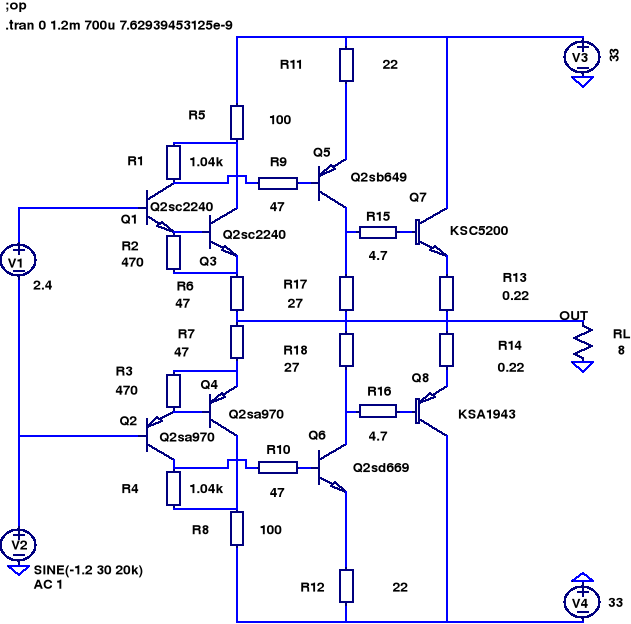

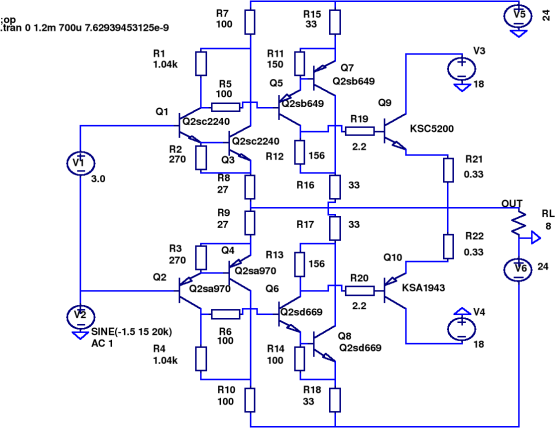

Here's the schematic for the open-loop voltage-follower stage, extracted from LTspice:
The 1.04k resistor can be realized as a 1k resistor in series with 39R, and the 156R resistor can be realized as a 100R in series with a 56R. All LTSpice transistor models have been obtained from files previously posted at here at diyAudio.
The key property behind the Kulish error-corrector that allows it to be used in this topology is that when the load is attached at the collector of the transistor, it behaves as a pure transconductance amplifier - there is no need to recalculate the collector load resistances (1.04k and 156R in the example shown) to take into account the additional load from a later stage. The gain of each stage may drop, but the distortion figures remain more or less the same.
The second property is that the two emitter resistors in each stage of a Kulish error-corrector need not be the same - this simplifies biasing requirements when used in a multistage topology.
The third property (unused in this example) is that additional transistors (triple-, quadruple-darlington, etc.) can be added to each stage of the Kulish error-corrector to linearize it even further. The collector loads follow the multiplier sequence 1, 1.039..., 1.079..., ... (1.039)^k etc.
An additional property (unused in this example) is that it is possible to tap the emitter of the topmost transistor in each Kulish stage, losing some linearity (additional distortion), but getting a low-impedance output in exchange.
Here's the LTSpice .asc file (rename it to <something>.asc before loading it in LTSpice):

Here is the LTSpice schematic file of the Class-A CFP voltage follower (rename to <something>.asc before loading it in LTSpice). It's tolerant of a fairly wide range of supply voltages starting at about +/- 15V, but the higher the rails, the greater the power dissipation in the output stage:

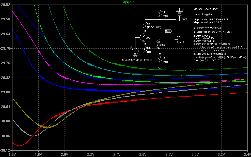

you're talking of a 4% adjustment to r1 &4.
Are the resistor values that critical to circuit operation?
Does it work in ClassAB or only as a ClassA stage?
Yup - it approximately corresponds to the ratio Vt/Vbe = 26 mV/660 mV = ~3.9%
The critical resistors are R1 & R4 above - these can be fixed after choosing
the other three in each corrector section. The other values are not critical,
they can be chosen for biasing convenience. If you vary R1 (& R4) and watch
the FFT plot, you will observe H2 and H3 decrease for a while and then start increasing - that minimum is the sweet spot (which varies depending on the
value chosen for the Vbe servo). Alternatively, fix R1 & R4 approximately
and vary the voltage of the Vbe servo to find a sweet spot that minimizes H2 and H3.
The ratio of H2 to H3 can also be altered by adjusting the value of the emitter ballast resistor in the output transistor. Generally, less seems to be better, but that will make DC bias stability harder to obtain. I've show 0.1R in the simulation, but practical designs should probably go with 0.47R and accept the higher distortion that results at large swings. In any event, GNFB will be required to remove DC offset at the output, and this will also help drop the H2/H3 and higher harmonic components (already almost non-existent) below the noise floor.
The distortion also becomes vanishingly small at smaller swings - say 1V peak. In this respect, the circuit seems to mimic the behaviour of the original classic JLH, but with better distortion numbers. For normal indoor listening levels, distortion may not even be measurable.

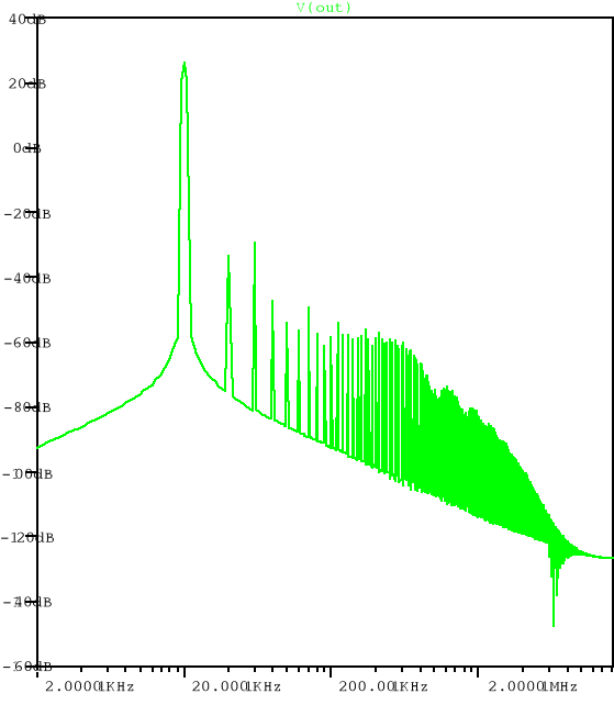

It will work in Class AB also, but the kink in the curve during the transitions seems to mess up the distortion numbers - it drops back to the -50..-60 dB regime typically seen in uncorrected Class AB stages. Similarly, turn-on and turn-off transients also seem to mess up Class B distortion numbers.
I'm looking for a workaround for this, maybe Bromley or Sandeman Class S wrapped around this, with this being an accurate Class-A stage.

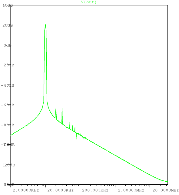

Code:
Freq. THD
20Hz 0.000297%
200Hz 0.000328%
2kHz 0.001433%
20kHz 0.014027%
Details on the 20kHz data:
Code:
Harm.# Rel.Level Phase
1 1.000e+00 0.00°
2 1.392e-04 -180.94°
3 1.675e-05 -281.86°
4 2.138e-06 -358.77°
5 2.871e-07 -95.33°
6 4.273e-08 -183.83°
7 8.315e-09 -248.46°
H2 is dominating the picture, hence a differential stage (into differential outputs) would significantly reduce THD at 20kHz by one order of magnitude. And the odd harmonics are going down quickly with order which is very nice, too.

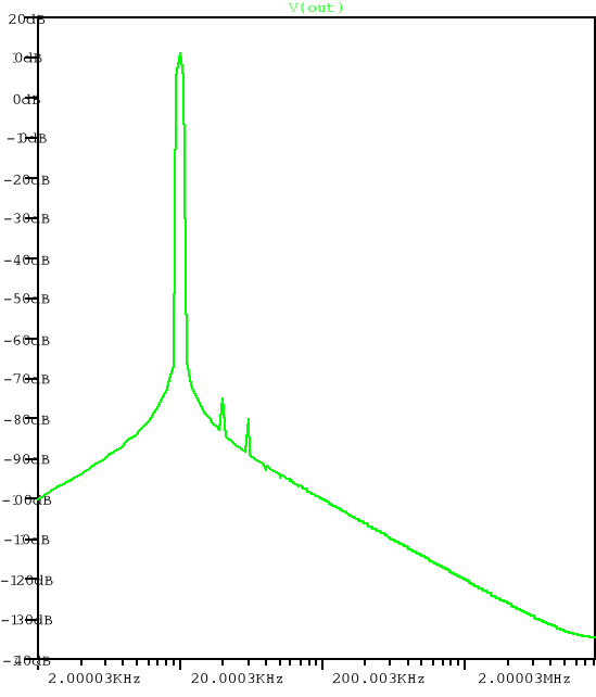

I forgot to add the circuit I simmed, for reference (now please find it attached). I plotted transfer slopes with varying parameters and surprisingly found that the most linear transfer (constant slope) is not found with the textbook ratio of 1.039 but with a somewhat smaller value. Also the outer resistors' (R2, R4) ratio to the inner ones plays an important role as it seems, in my example it is about 0.8. The corresponding curve is the light green one, which the flattest of them all. The factors are 1.008 for the inner collector resistor and 0.8 for the outer to inner ratio.
I could improve the THD20 by a factor of more than 3 by the simple addition of a cap. This could be further reduced a bit (factor 4...5) at a cost of increased THD at LF by further imbalancing the resistor ratios. Right now THD sims in at:
200Hz: 0.000298%
2kHz: 0.000405%
20kHz: 0.004190%
As usual, to be taken with a grain of salt... but then again, any Vce never drop below 13V, so the lack of modelling the Early voltage drop a low Vce should not be too much of an issue.

I spent my time simulating a Class-AB emitter follower, simpler than the first one in this thread, with similar distortion numbers at small swings (<4 V). At high swings, it goes to around -55..-60 dB, which is still not too bad.
Here's the schematic:
> try on a LTP failed...
In what manner did it fail? Hard to bias, or Spice fails to coverge quickly, or is it worse than a conventional LTP under similar bias conditions?
And here's the FFT plot at 30V amplitude input (almost rail-to-rail swing), with both output transistors cutting off sharply for almost half the cycle. It's much worse than the small swing case,but still quite usable - GNFB can bring some of this under control:
- Kulish Corrector for Class-A EF O/P Stage
