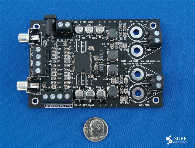

It looks like sureelectronics is now offering some sort of tripath based board. See Error Page | eBay for details.
Blimey, thats cheap for a TA2024 amp... those inductors look a bit small and there is no tank cap... but that's easy to remedy!😉
Tekko said:What a piece of c r a p, no caps on the rails. BAAAAD.![]()
I see 6x 100uf 16v.
theAnonymous1 said:I see 6x 100uf 16v.
Yes indeed. Not a bad looking layout. And don't discount those surface mount inductors, some are very good in a small size.

I received mine. See pics for accessories provided. The speaker terminals are spade/banana. The power connector was a nice touch, 2.1mm (ID)/5.5mm (OD) type. A jack for hooking up your portable devices to the rca inputs. The onboard caps are 100uF/16V, 6.3mm diameter. Board dimensions: 6.6cmx9.8cmx18mm. If you took off the screw terminals you can save a bit on the height, maybe 16mm. C-C on the rcas: 3.5cm.
I hooked up a panasonic portable cd player, a pair of Klipsch KG-2 (4 ohm/90 efficiency) and a lead acid battery. Sounds pretty good and plays loud. Popped in Dire Straits Calling Elvis and results were very presentable, not all bass there, but still very nice.
Oh, and I'm getting 550mv or so at the speaker outputs, is this a problem?

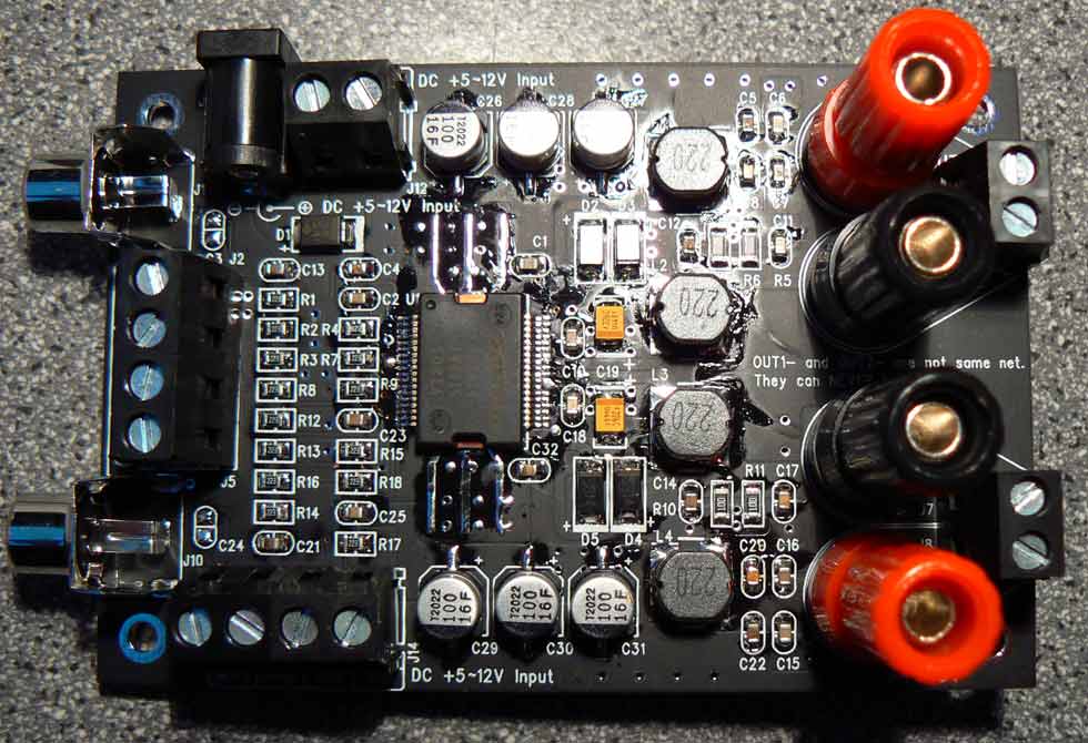

I'm posting a better resolution picture than is currently in the eBay listing. I actually have a higher resolution one, but size is limitation.
The speaker binding posts are 3 way, the thru hole for 20 gage wire (or worse).
Getting a bit of hiss...
Received mine today and they look well made..But... The first thing you must do is remove C3 and C24, these are killing it's sound.....
The input caps are C13 and C21, they are 800nf and think should be OK with the small output inductors...

audio1st said:
It sounds bad because of C3 & C24, they are 100nf caps across the supply and cause a passive volume control to act as a tone control..REMOVE C3 & C24..
Hello Lee, I don't know what all the 22k resistors are for yet, DC offset is about 500mv on both boards I've got..
In your picture C24 looks still onboard.. am I wrong?
Kooka said:
In your picture C24 looks still onboard.. am I wrong?![]()
Sorry, I just magnified now the pic: C24 is out😀

Had a bit of time to look a little closer at the board.
The DC offset cct IMO has all the wrong value resistors and seems of no help..I think 500mv is a bit high and probably more than it would be without the offset cct?
I think C3 and C24 should have been 100pf and not 100nf across the input..
The Mute and Sleep pins seem of no use and the fault pin is not connected to anything so I guess if a fault occurs no auto reset will happen..
All power inputs are via D1 to prevent incorrect polarity connection, so if you don't like the idea of a diode in the supply you will need to remove and short it's terminals..
I haven't looked at the output side, except that the inductors are 22uH..
But it does sound pretty good as is and I'm SURE could sound even better...😉
