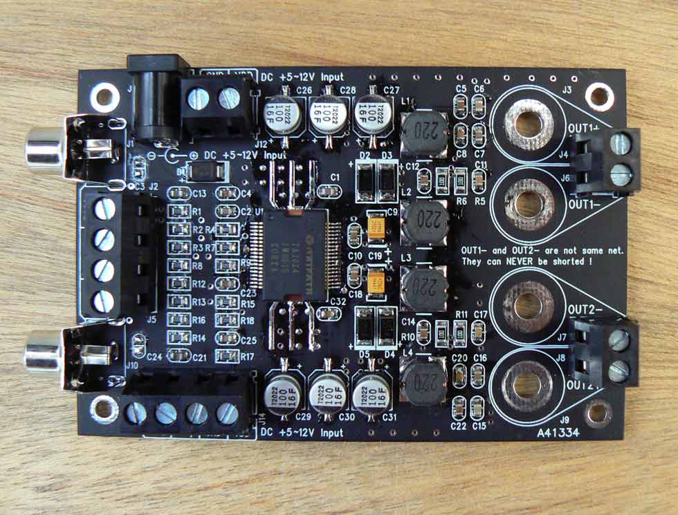

I've now disabled the DC offset cct and the DC at the speaker terminals has dropped from 500mV to 50mv and 20mv, much better..
The power supply I'm using at the moment is outputting 12.2V which after the diode and measured at the power caps is 11.8V. So if you leave the diode in place you should allow for the volt drop it causes.
It is sounding nice at moment and bass is OK to me. I'm not a very good judge of these things because I don't have top of the range high efficiency speakers.:cannotbe:
I wonder why Sure seem to have used wrong value components. Please wait for more technically minded people to receive their boards and perhaps different findings..

VDD will be the 5V generator (I can't think that its the 12V rail unless they expect you to regulate it down?) so you can use it to switch mute and sleep and connect fault if you want? Put a MM on VDD and see what you get.

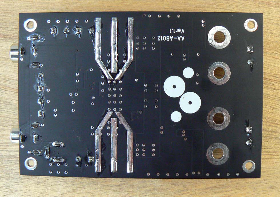

I think those inductors are coming off but without seeing the underside of the board I can't decide what to do yet........
Come on postie :santa2:
Hi Lee, VDD near the Mute terminal is at rail voltage but there is a 22k between mute at chip and the Mute terminal and another 22k between Mute terminal and ground. So the voltage is dropped to about 5V at the Mute pin. So Mute connected to VDD does mute the chip.:D
Hope you soon have yours, PS not much to see on the back...
The underside of the board..

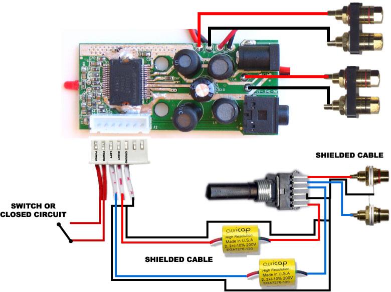

I'm looking at adding volume control and upsizing the input caps. I found this diagram for the SI amp. For this unit, do I remove C13 and C21, jumper them, then follow this diagram? Do the existing input caps need to removed at all, or can I just jumper across them?
I do not have shielded cable for the RCA run. Will twisting the two wires from the jack be good enough? I will not be running near the power cables at all.
I'm also going to tack on at least one 220uF low esr cap I have lying around onto the existing 100uF SMDs for a 520uF value per side, is this worth the trouble? Bass is actually pretty decent with the existing 3x100uF...
