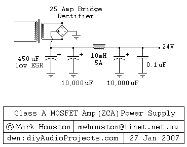

Here is the Power Supply schematic.
--Same questions about the caps, would it be ok for example to replace the low ESR 450uF cap with a low ESR 470uF?
--And do the cap voltages matter?
--What specs to I look for in a transformer for this power supply?

hi Kinnja
before you decide on this design, are you aware this thing outputs somewhere between 5-10 watts of power? That means you need really efficent speakers to get the best out this amp.
"--One resistance is shown as 15R/40W, could I use four 60 Ohm, 10W resistors connected in parallel here?"
yes
"--Where the wattages of the resistors are not specified, does it matter, or would a half or quarter watt be ok?"
The schematic says to use 0.5 watt reistors unless marked.
"--What voltage should the capacitors be, or does it not matter?"
The rails are 24 volts, so if you use 35V or more all should be well.
"--How important is it to match the exact capacitance on the schematic, is it ok to go a little higher or lower?"
yes can vary a bit and wont make much difference.
"--Is it ok to connect smaller caps in parallel to get larger cap values?"
yes
"--What specs to I look for in a transformer for this power supply?"
Typically you would use a transformer rated at minimum twice the power that a class A amp consumes, preferably 3 times. The author states the amp comsumes 60watts but i think its more like 40, so 120VA to 180va should work fine, even bigger is better.
good luck and hope it sounds good🙂
Kinnja,
I believe there is a mistake on the power amp schematic.
The polarity of 33uF tantalum cap is backwards.
The positive connection of the cap should connect to the 100k wiper.
You should email (Mark Houston) to confirm this.

Hi Kinnja,
I got a revised drawing from Mark and I have updated the DIY Class A MOSFET amplifier webpage to reflect the change. The polarity was reversed. Mark also said in the end he went with a low ESR electrolytic, not tantalum. He also said the power is in the order of about 5W.
He cc'd me on his response to you. He later told me that your email bounced. Contact him again as it was a long message and I am sure he wants you to read it.
Gio
