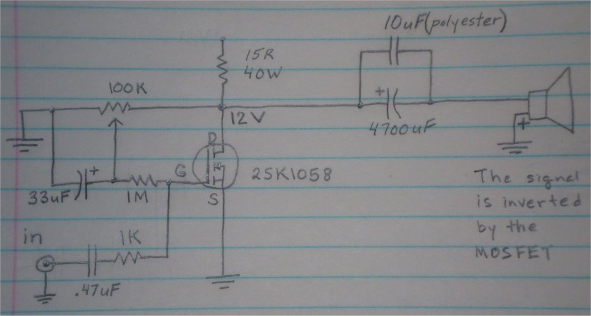

The resistive loading for the amp is via four 10W 15ohm resistors in series parallel to give me 15ohms. I fan them out on the cct. brd to allow an air between them. It appears to work OK. There is air hoes in the cct. brd below and the case has cooling holes top and bottom directly under and over the resistors.
The output cap looks reverse polarity but this is because the signal IS inverted through the amp. The suggestion is a tranni upfront to first invert the signal. I’m not sure I would bother.
The speaker is also reverse polarity again because the amp inverts. I have my speaker output wiring reversed in the amp. So you connect the speaker externally to the binding posts as normal. Pass does simular in his ZEN amps.

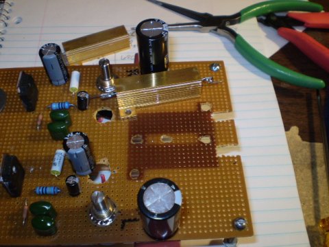

No pictures yet, I don't have a digital camera.
The boards I used are the same kind you used on yours. Point to point, with most of the soldering underneath.
I got load resistors encased in their own aluminum heatsink that I thought were rated at 50W. After I got it all together I found that they were only rated 20W unless they were mounted on another heatsink, so I had to tear down and rearrange part of the amplifier board to make room for another heatsink. The load resistors are Arcol HS50 15R, I'm using one for each channel.
I used a 18V 250VA toroidal transformer, the power supply is putting out a little over 27V. So I adjusted the bias to 13.5V instead of 12V, let me know if that is wrong.
The case doesn't have any ventilation, but with the heatsinks, there is no room to put the lid on, and I wasn't planning on closing it up anyways. You were right when you said how hot the load resistors get, but they seem much cooler now that they have a heatsink.

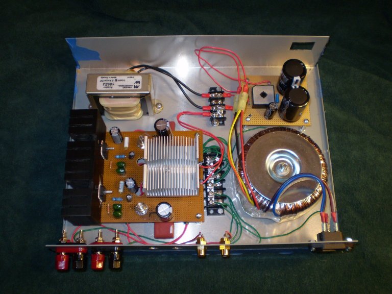

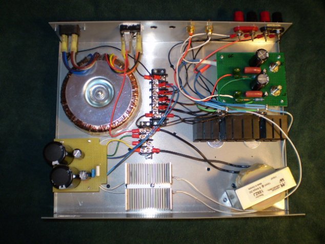

Kinnja said:This is only partially complete.
Nice clean layout. Be sure to post more photos when you are done.
Gio

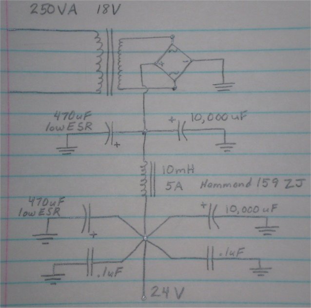

It is almost done. I was getting unhappy with the layout, and I decided that I might want to eventually put a cover on it. So I just about started completely over.
I removed the caps that were in front of the load resistor from the amp schematic, eliminated the extra 450uF and .1uF , and then drew them on the ps schematic. I still left it with two .1uF caps because the ps schematic already had one there, and I didn't want to change too much.
I also did the drawings with 470uF caps because that is what I was able to get.
Here is the amp.

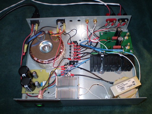

Hum
While I was tidying up the ground wires, it developed a bad hum. With the ground wires lengthened and pushed away from the transformer, the hum is barely audible. I can work on it some more, there is room for some "wire management", and I think I have some shielded cable laying around.

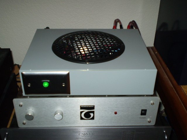

I would like it to look neater, but this is how it looks now for those few who might like to see it.
