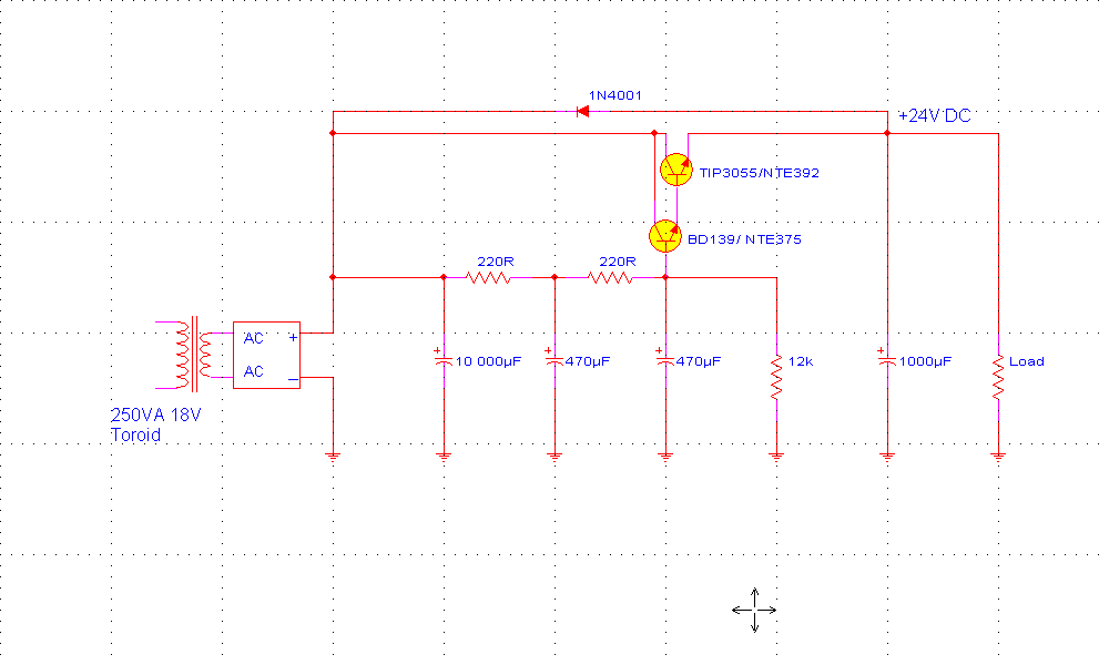

It sounded awesome. It had lots of detail, and good bass, but it did thump when I turned it on. It also had a little hum I could hear after my head-cold cleared up.
I since built a Capacitance Multiplier to replace the choke/pi filter in the PS.
The start up thump is completely gone, and I hear no hum at all when I listen for it. It sounded great with the choke, but to me, the cap multiplier is an improvement--even more detail and better bass.
This is what I have so far. Its a variation of the one at

Hi John,
Nice work with the Capacitance Multiplier. Can you post a picture of your new power supply? Do the transistors in the Capacitance Multiplier need a heat sink?

gmilitano said:Hi John,
The NTE392 gets a little hot, but I don't know if it really needs a heat sink. I did put heat sinks on both of the transistors anyway.

Kinnja, it seems one of your colectors lacks a connection to power on your gyrator's diagram.

I'm extremely pleased Mr. Pass even makes a comment on my seriously simple ZCA amp. Thank you Mr. Pass. It is partly because of some of his Zen amps I pursued the ZCA. There is many versions of the amp in many countries performing for its creators.
For biasing I used a couple of pots. The goal is to get halve the PS voltage across the FET and half across the load (naturally). I found in the first few days of play a lot of drifting occurs so continual tuning is required. Now after many months of play it is quite stable.
