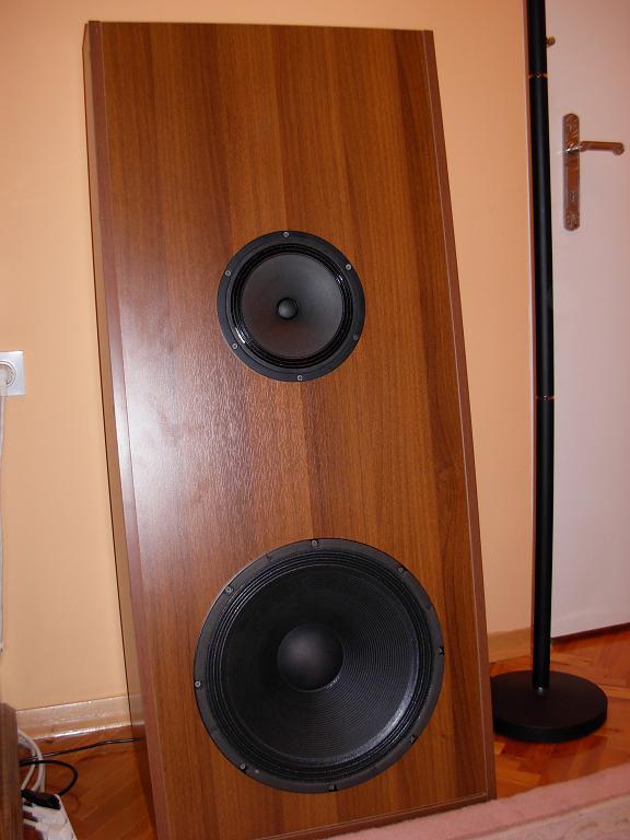

It is basically a copy of Visaton No-Box Open Baffle. Just using an Eminence Beta 15 instead of Visaton BGS40.
I still can not comment on the sound, I am still connecting the wires...

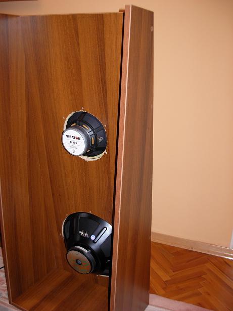

There are no binding posts, I will solder the speaker cables (0.95 mm magnet wire) directly to speaker terminals. It is a biamped system.
Visaton B200 is driven by Pass Diy Zen V9 without feedback. Eminence is driven (temporarily) by a modified LM3886 amp. Preamplifier is a 6922 based tube buffer (Jfet CCS-ed cathode follower). Crossover: Visaton-180 Hz first order (or, just a cap). For the woofers, I am going to use a LR 4th order 110 Hz lowpass that is left from a project in the past. Gotta experiment here....

First impressions: Sound is huge, but it lacks body. Like some hollow ghost through the whole room. It was with the crossovers as I described. Then I disconnect the bass speakers, and run the Visatons fullrange. Better. I like it more this way. 1st and 4th order crossovers do not integrate well. I am even thinking to try passive configuration, both 1st order...

I am listening to Visatons only (fullrange). It sound very good! With some music there is almost no need for bass hepler!!

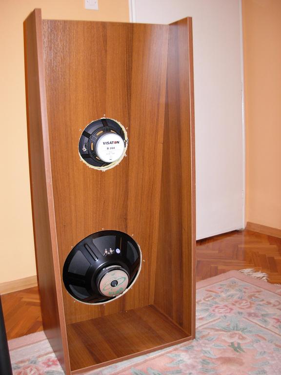

I've been playing with some active crossovers yesterday. Integrating those drives is not as easy as I thought. I decided to run the Visaton only through 1st order, and then experiment with the bass crossover until I match them. First I tried 4th order. Disaster. Tried a 2nd order as well. A bit better, but not acceptable. What seemed to work best was an integrator. I used one half of this circuit:
http://sound.westhost.com/project48.htm
Crossed the Visaton very low,around 90 Hz. Then turned up the volume on the bass amp...Still, the most enjoyable was to listen Visatons alone, run fullrange...

I was not that clear in the previous post.
Visaton B200 is high-passed at 90Hz with a capacitor at the amplifier input.
Eminence Beta 15 is run through a separate amplifier through integrator circuit.
However, the purest sound is coming from Visaton B200 run fullrange (no high-pass) and the Eminence Beta 15 disconnected. On the downside, it is bit bass-light and the excursion on Visaton is higher than I'd like, so I didn't play it very loud.

my setup is similar to yours, I cross over at around 100Hz, fourth order LR on both sides, ie HP and LP using active Xover(tunable, analog Behringer Xover) . I don't use any cap at the Mid woofer in our case the B200.
I get good results, the setup is not ideal as yet, I need to tune it.

One thing may not get forgotten: The lower cutoff of the B200 and the woofer are quite close to each other and may therefore cause unwanted cancellation.
A topology that takes the driver's response into consideration can be found here:
