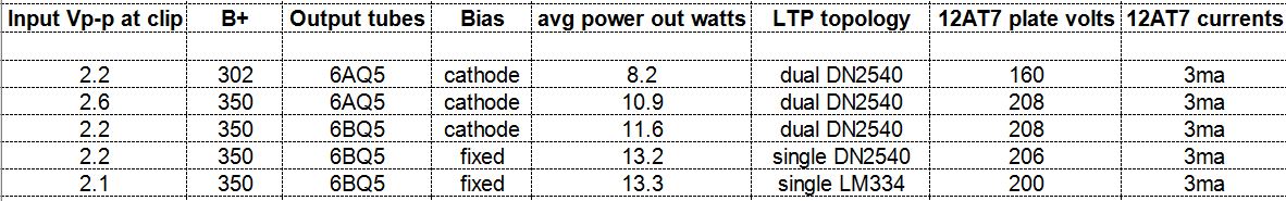

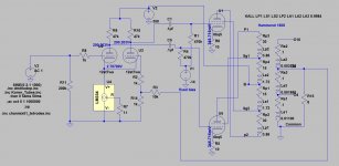

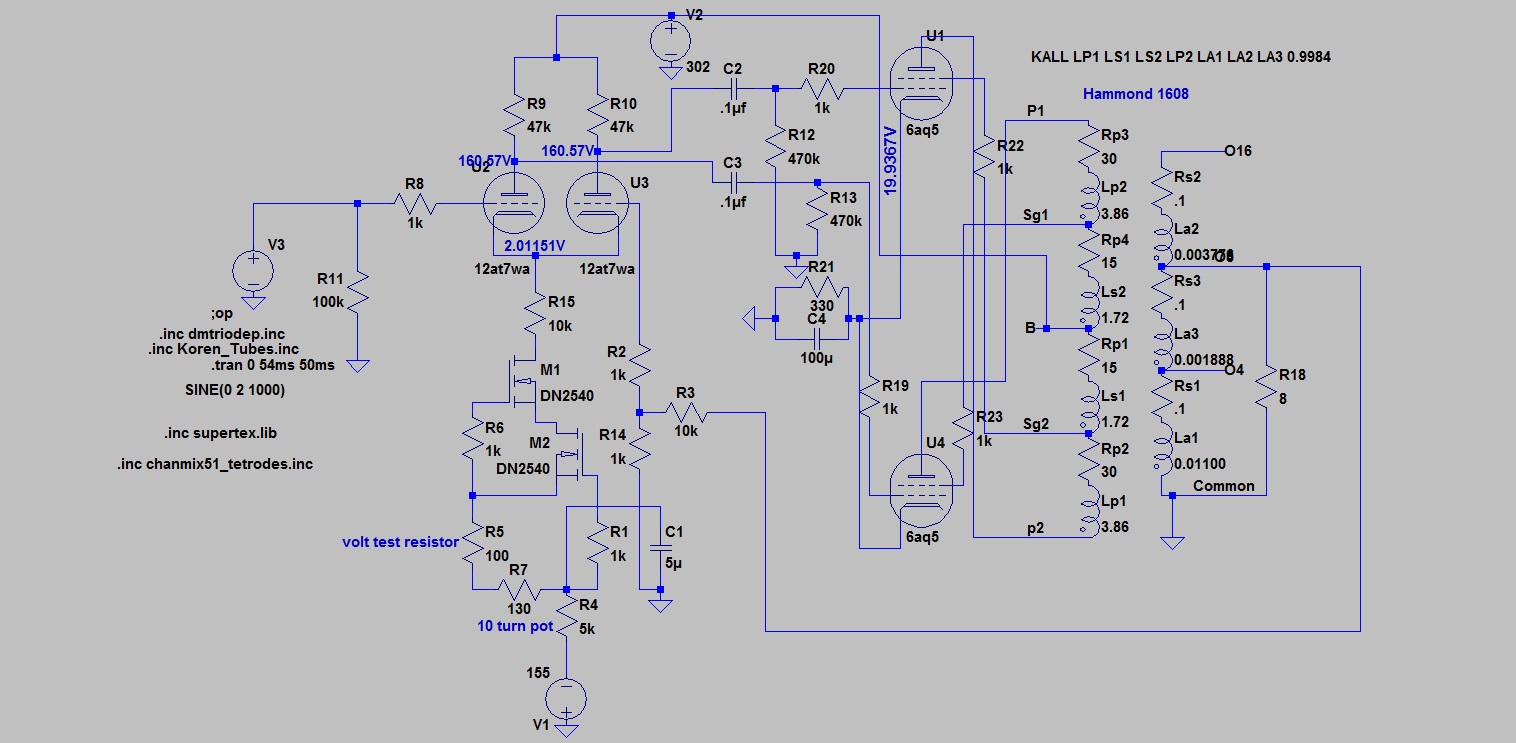

El Cheapo LTSpice Model
I couldn't find the "original" thread for El Cheapo but found this one so hope OK, if not let me know where to post.
The LTSpice of this amp is posted below. Also a jpg with the DC voltages as calculated by LTSpice. Let me know if you need the Libraries to run this yourself.
And please comment on this, thanks!

The needs of the 12AT7 splitter/driver rule the roost. A 'T7 section sounds good with 200 to 220 V. on the plate and an IB of 3 mA. Therefore, the B+ rail should be about 355 V. By itself, a N-77U isolation trafo does not get the B+ rail "tall" enough. Boosting the B+ is necessary. The currently recommended power "iron" set is: a Triad N-77U as main B+, a Triad VPS24-1800 (2X "12" V.) as B+ boost and "12" V. heater power, an Allied 6K27VF as B- and "6" V. heater power, and a Triad C-24X as B+ filter choke.

350v supply gives a nice 200v on the 12AT7 plates. Refer to the table below. Note that the 6BQ5 requires less drive to clip.
In the Spirit of DIY, please comment on the two circuit changes, 1. using only a single DN2540 and the other a LM334 with no -155v supply. These latter two utilize fixed bias at about 35mA per output tube.
Results are tabulated. If anyone wants the LTSpice files, I will send.
