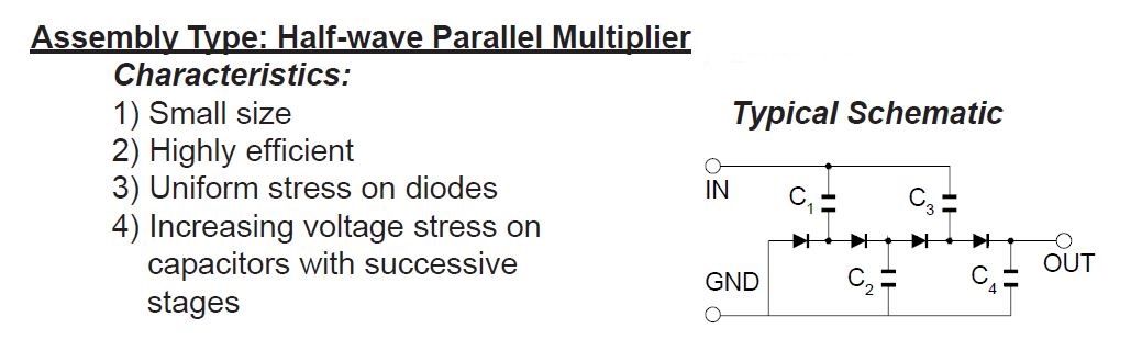

You can voltage multiply the 5 VAC winding to get the B- rail. Use Schottky diodes, as that will maximize the O/P of each stage. Approx. 6 V. are available per stage. So, 8 stages will surely be enough and 6 stages probably good enough. The half wave parallel setup provided is quite satisfactory, in this low current situation. Reverse the polarity of the diodes, as the schematic fragment is for a positive rail.
