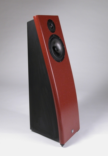

For inspiration, I looked to Reference 3A. Their L'Integral Nouveau is a speaker design that I admire, with its graceful curved baffle with contrasting colour to the body.
I decide this will be what my new speakers will look like.

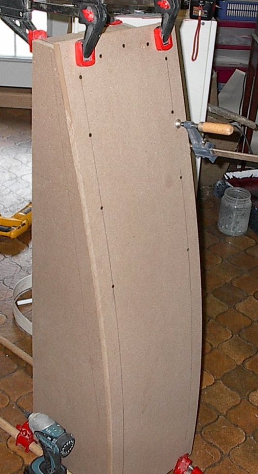

I start with a sheet and a half of 5/8" MDF. This is enough to get all of the pieces for both speakers.

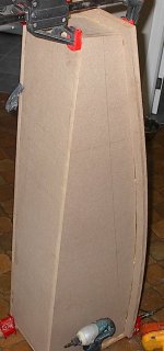

Cut and assemble the body, which has a divider between the woofer chamber and the midrange/tweeter chamber.

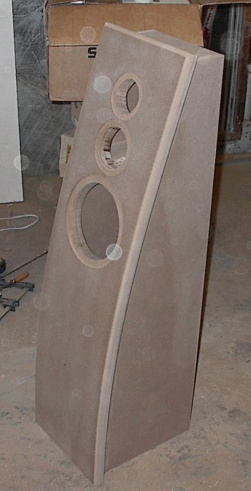

Cut the pieces for the baffles. The baffles are 2 layers of MDF, the first is glued, clamped and screwed to the body (as shown in picture below). Given the fairly gradual bend, I felt confident that the MDF would bend without resorting to kerf cuts.

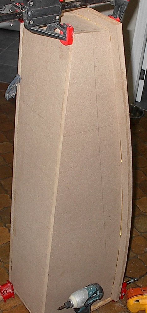

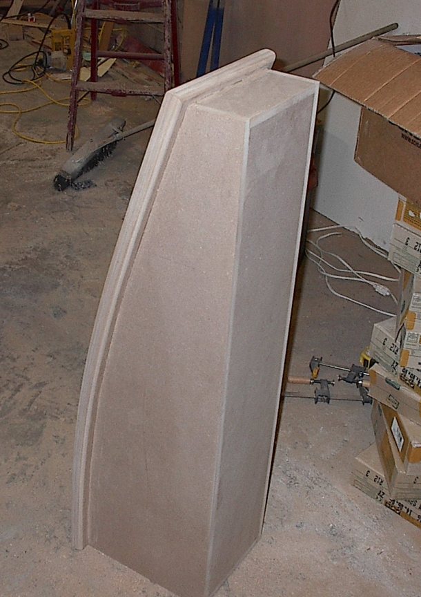

Here's a shot of the back. The body is put together with yellow carpenters glue and 16 gauge 1 3/4" airgun nails.
Other than the divider between the woofer and midrange, there is no internal bracing. The widest span is near the bottom of the body on the sides where it is ~11".
As I said, I don't work from plans. That comes back to bite me is the ***, when I locate the divider a little too close to where the midrange is (as seen in the picture). I need to carve out some material to accommodate the big magnet on the driver.

Yes, the shape of the L'Integral attracted me. Normally, I would not blatently copy an original design, but in this case, I couldn't resist.
A shame that I could not make the baffle from solid Corian, like the original. Oh well, next time.

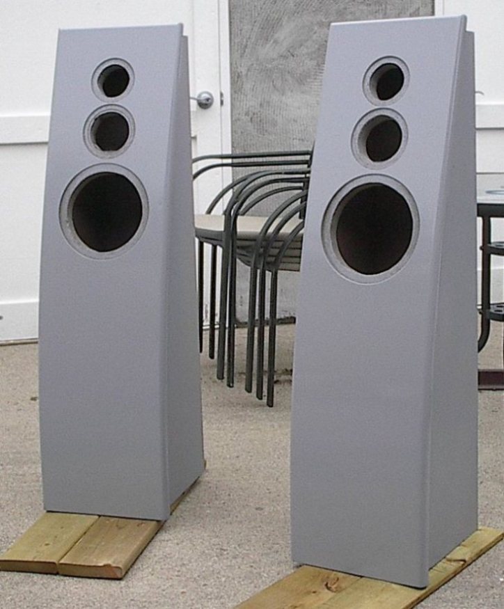

Before I can do anythig else with them, the baffles need to be painted. The arrival of warm weather means I can start this.
My painting process has been explained in other threads, but in a nutshell: 8 coats of primer, 10 coats of finish, coloursand and polish.
The picture below shows them after they have been primed. That would have been in the early part of May. I then let the primer cure completely then sanded smooth before finish paint.
http://www.diyaudio.com/forums/showthread.php?s=&threadid=99301&highlight=
Spring comes, and with it comes my desire to resume work on these speakers.
It takes about 2 weeks for the urethane based primer that I used to fully cure. I then repair any little blemishes with automotive spot putty and sand the entire baffle with 400 grit paper.
It's now ready for paint.
It takes much of a Sunday to apply the ten coats of paint. Temperature and humidity are factors for spraying this many coats in a short period.
Why so many coats? Well, in order to get the final result (piano black), you need to coloursand the paint. This is wet sanding the paint with very fine (2000 grit) paper. Experience has shown me that in order not to cut through the paint into the primer below, the paint has to be thick. So far, 10 coats seems to be the right thickness, especially with the cheaper spray equipment that I have.
No problem, a few cold beers, a sunny Sunday, take my time and paint.🙂 Other things to do while waiting for each coat to flash off like working on my tan.
Ah, but don't get me wrong, don't spray in direct sunlight.
Heres a pic after the speaker has been painted and let dry a few days:

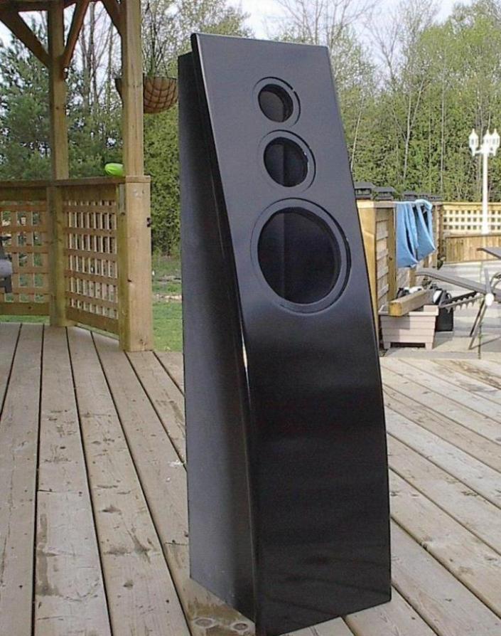

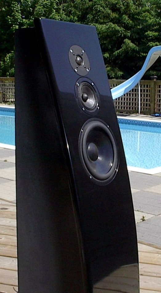

I waited a full month before colour sanding the baffles. The paint takes a long time to cure, and I not really in a hurry anyway.
Sanding goes well, no burn through the paint layer.
Next comes polishing. I use a 7" high speed buffer for this and polishing compound. This goes as expected, with good results.
This type of finish is impressive, but can be very difficult to do without the proper preparation and knowledge. Once polished, every tiny imperfection will show up, so you can't scrimp on the prep work (especially sanding).

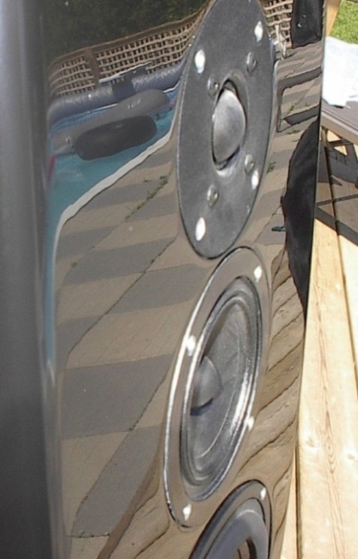

As mentioned earlier, I temporarily installed the drivers for a quick listen. Slung together crossover, close to the 300Hz and 3000Hz of the active filters crossover frequency. As it was only one speaker, I had to pair it with one of my T line mains.
First off, it's so much louder, I have to turn it down. Sound quality is very good, good bass production.
I'm very encouraged.
Here's a shot of the speaker with it's drivers installed:

pinkmouse said:Very nice. Why did you give up on the veneer front?
Hi Al,
The original has that nice reddish baffle (it's solid Corian) with the black body, I thought I would reverse that. Also, veneering a baffle like this is too difficult to do well -it's curved plus has the full bullnose edge. Also some difficulty around the driver recesses.
Alternately, I could have made the baffle from veneered ply, then milled and glued on a solid maple bullnose.
That would have saved me about a month and a half in finishing for the baffle (fingerprint collector 🙂 ).
Glad you like it so far.

Yes, the curved baffle was a challenge for the recess. I used a scrap of MDF bigger than the driver, cut a hole in that with my router jig the same size as the woofer. Then I clamped it onto the baffle with spacer blocks under each end to sit flat. A 1/2" follower bit in the route cut the recess nice and flat.

Time for another picture. This one shows how $5.00 worth of paint (and a little hard work) can make $285.00 worth of drivers look shabby. They need to be dusted:
Beautiful looking job so far, what a finish! One question, how did you attach the front (second) sheet to MDF to the baffle?
