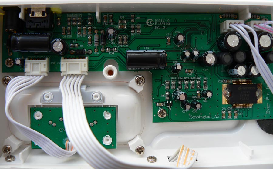

Audio1st. I assume that when you open the thing up that it is obvious where the speaker connections should go ?
I am interested to hear if it sounds any good with a normal system. Is it tweakable ? (lots of SMD's !)
Puffin said:Audio1st. I assume that when you open the thing up that it is obvious where the speaker connections should go ?

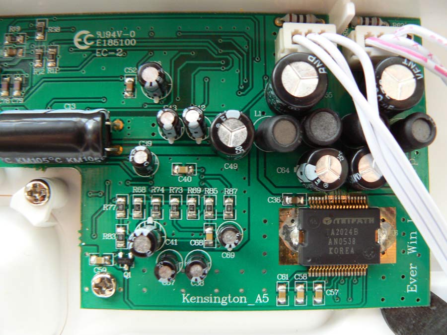

The other side is even worse for SMD's, (push button volume control)!.
But the basic Amp part looks very tidy..

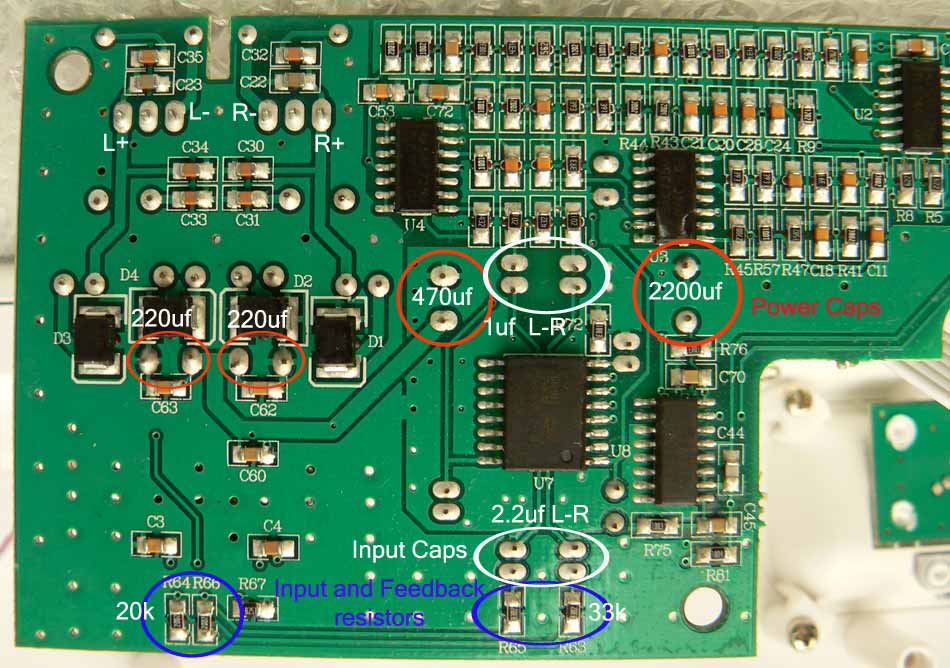

As is, the input Cap value is 0.68uf. Bridge the 1uf will sort that out.
obviously to get the best out of it you would have to use your own volume control and come in at the 2.2uf cap.
the chip is the 2024..

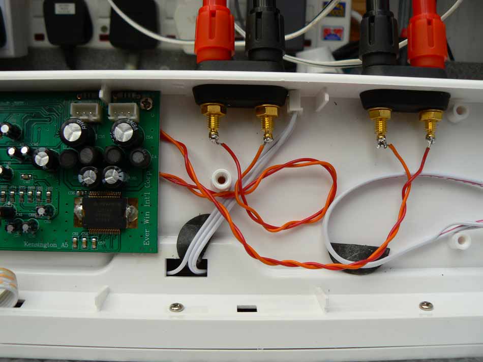

Have added the speaker terminals and wow! There seems to be loads of bass now so disregard the last entry about bridging the 1uf caps. The signal seems to go through the chip between the 1uf cap and the 2.2uf cap so the 1uf cap needs to be there....!
I have just unplugged the original speakers and may fit a switch so they can be used when needed.
I shall listen for a while to see how it sounds.. better than £20 plus speaker terminals though!

I've had a bit of a listen and seems that the preamp section is having an effect on the sound. The bass is boosted at about 120Hz (I would guess) and treble is a bit shut in.
When the amp is used with a separate preamp and connected at the 2.2uf caps it sounds very similar to the S,I amp. it is not as loud because of the input and feedback resistors give it different gain.
I attached 47k resistors in parallel with the 33k input resistors to give about 20k input and 20k feedback, but still not as loud.
I also don't know if the output coils are big enough to handle full size speakers, they look smaller than the S.I amp coils (I can't measure the inductance or wire gauge) . They've been alright so far (not melted).

I have just re-boxed my Kensington. I initially used the input connections under the 3.5mm jack socket and ran wires to the phono sockets. Fired it up, it worked but sounded s*ite. Then I coonected to the 2.2 caps. Thats more like it. The amp is running in at the moment before I hook it up to my main system.

I will check the DC. I went in at the bottom two solder pads shown on your photo for the 2.2uf's. I assumed that this was "in" and then the signal passes through the cap and on up to the 2024 chip ?
Lostcause. DC on left channel is -0.06 and Right +0.05. I attach a copy of your phot with details of where I connected to.
