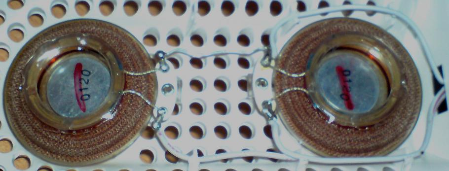

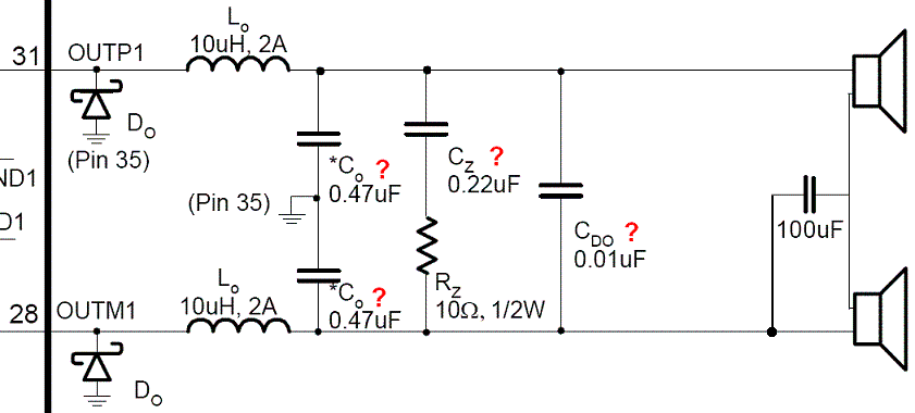

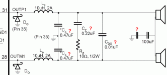

I was wondering if anyone could shed some light on the output speaker arrangement? Not sure what all the caps are but I'm sure they are pretty much what's on the spec sheet....
Except for those two branching off between the two speakers.. the 100uf looks bi-polar as it doesn't have any obvious markings.

Hello Lee, it looks like a simple crossover, just ignore. I couldn't measure the actual value of the smd caps because I didn't fancy lifting them. On the board they all measure about 0.3uf each, but they are in parallel with each other..
Thanks for the pointer there Barry, :rolleyes: couldn't see the wood for the trees!
Measuring across the drivers in series they are about 4ohms without load so I expect they are as per the spec sheet.
I'm going to attach these to a couple of cardboard boxes and see how they sound......

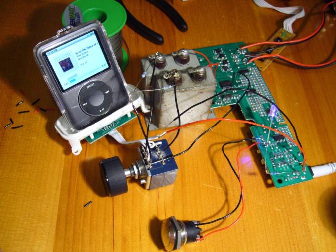

I finally got round to getting one of these as Mrs Toolkit has just treated herself to a new Nano, and I thought a dock with Tripath power would be a good kitchen system. I have just hacked it with bell-wire for now to check my understanding of Audio1st's mods and added a couple of near-fossilised ex-RAF input caps and a pot - I like the juxtaposition of 1946 and 2007 technology!
