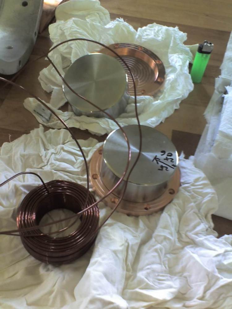

Cloth Ears said:
:worried: :scratch1: :bulb: :spin:
The penny has dropped!
So how do you find these wonderful inductors to do this for you? I guess there is always "roll your own" (now where is that inductor calculator?). As big air-cored inductors seem to cost about $50 each (for a 2mH) in Australia. Maybe Mundorf has a iron-cored one available here for less. And I can't afford to get them sent from the US any more as it's too expensive now :bawling:.
Thanks, Babowana!
The "roll your own" solution is not that much trouble, and hands you a very flexible solution for future projects as well.
Take a look here for a little inspiration.....most of the inductor-stuff you see there can be made on the kitchen table 🙂
www.briangt.com/gallery/magura
Magura 🙂
