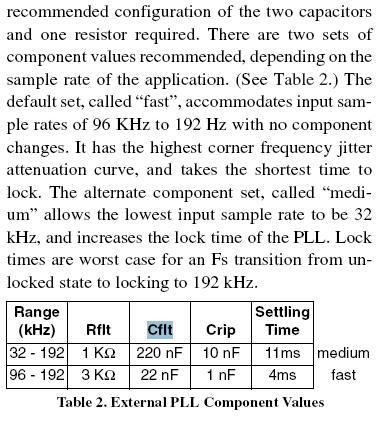

P.S. I'm not sure whether to implement the mods to the PLL section or not? There's one Cirrus Logic update which claims one should change the values to: 3K (Rft), 22nF (Cflt) and 1nF (Crip). However another datsheet seems to suggest that these values are only for optimising sample rates of 96-192... anyone care to comment? I have attached them both again for reference.

In my experience, setting the CS8416 pin 20 high (PDUR=1) causes occasional loss of lock on 96K and 88.1
Yes, even though the data sheet says it's OK to 108K. It is not.
Anyone else see this?
I also use components for the CS8416 phase lock loop C-FILT, R-FILT and C-RIP that make it take longer to lock and have lower corner frequency for jitter.
I suppose you will be OK with (PDUR=1) if you only listen to 44.1 and 48K
