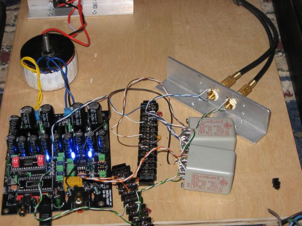

CS4398 + UTC A20
I went through some messing around with the opamp stage. I had only the first stage using a LM4562 going capless to my volume switch. It was pretty good. It had a lot of detail but wasn't as musical as I would like. I decided to not mess around with the lpf as that wouldn't change the character of the sound as much as a different output stage. A directly coupled opamp stage would work for most folks but I wanted better.
I strapped in a pair of UTC A20 line level transformers and it's great. I can't tell you if they are better than the Lundahl LL1690, but I am finally happy with the DAC. I'm not talented at describing the sound but I can almost see the music being performed now. The experimenting is over. I'm going build an enclosure when I get some time.
I've seen these UTC on ebay for as little as $140 per pair. That's pretty good.

UTC
Hold on. The jury is still out.
I used Legarem's schematic from post 97 and 98 in this thread.
I am stunned at the 3-dimensionality of the sound. It feels like I can hear instruments coming from deep in the sound stage. The ompamp mask is gone, as is the edginess. Everything is musical. The problem is the lower frequencies. I can't tell if there's more control or if it's reduced in emphasis. That I usually get home very late and have neighbors and don't listen to bass heavy music doesn't help. I don't have a spectrum analyzer so I have to depend on my ears. The UTC may not be the best transformer for this. I am letting it run in for a couple of days. It will probably get better. I'd love to try the Lundahls.
