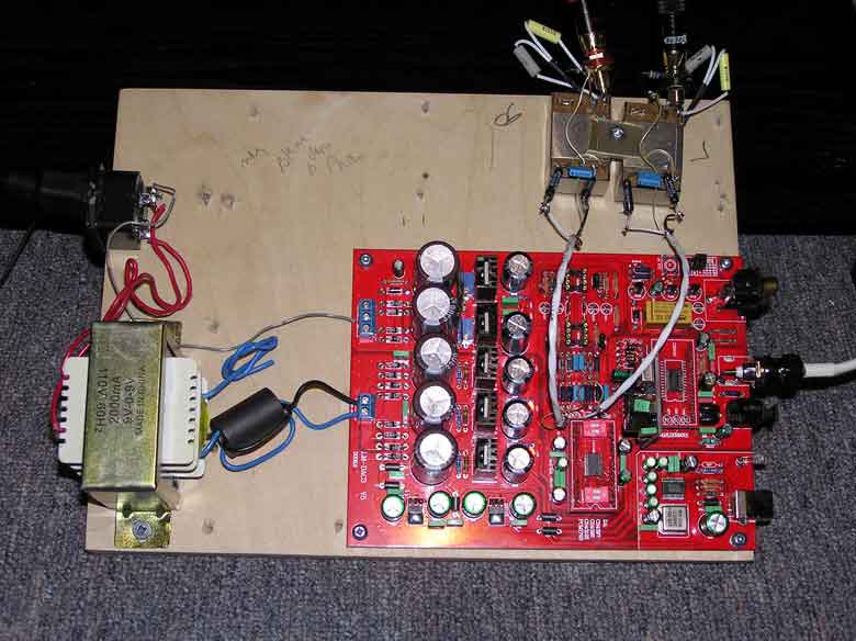

New dac with upsampling
The upsampling dac with Lundahls is now playing
As it is brand new, there will be a broken in time to do. I replaced the cheap RCA input with a BNC 75 ohm
I'm really surprized by the sound as is. I was afraid that the upsampling mode create somewhat a hard sound but it seems that the sound is great .
I will live sometime with this dac as is and later I will add an input digital transformer to try.
How can they sell at such a low price a board like this one ? This is really a good quality board with good parts
I made a comparaison with the other model which is without upsampling board and saw some great things.
All the regulators in the upsampling dac appears to be adjustable regulators (LM317T-LM337T) instead of being fixed regulators. Adjustable regulators are better regulators than fixed regs.
When using output transformers, there is two unused regs, I will perhaps use them to feed digital and analog supplys separatly on the dac and CS8416.

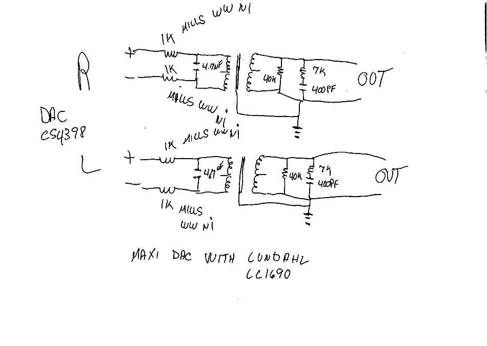

Can you tell us, how you connected the trannies? I see different resistors and capacitors.
Are you sure, you connected the left and right channel in phase? Did you remark, the solder pads are in the following order:
Left - + Right + -

Hi Franz
No problems my transformers are correctly connected
I use a low pass filter before my transformers. Even if the transformer itself is a low pass filter, it is often recommended.
The R C combinaison at the secondary is recommended by Lundahl to gives better square wave with the LL1690
The new board is a joy to work. The solder is melting easily as opposed to the old board.
I tried many power transformers with these dacs and ended using STD EI core transformers, The sound is WAY better than toroidal transformers.
