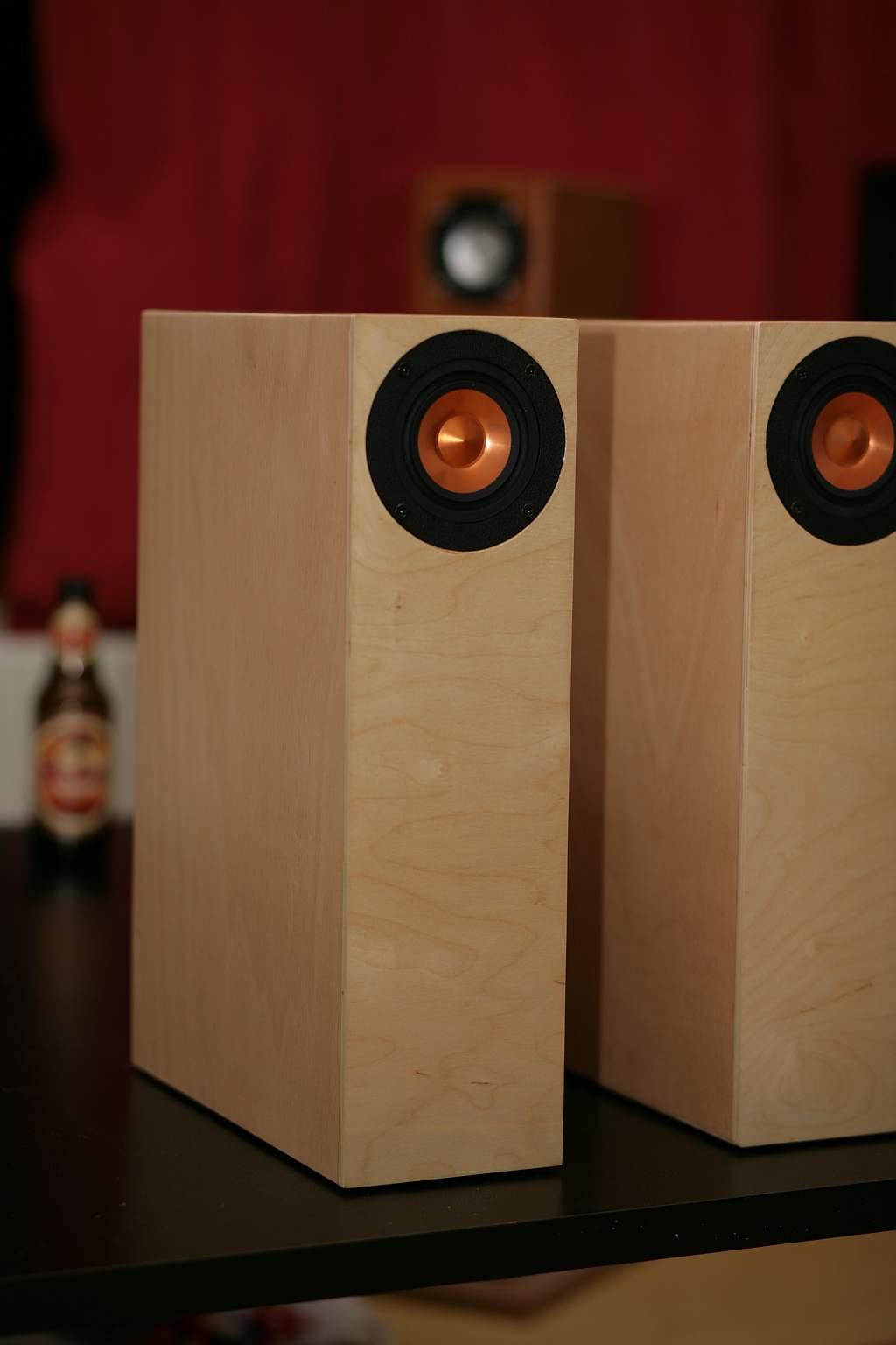

I wanted to present *) a design I made with the smallest Markaudio, the Alpair 5. Despite the design intent of the Alpair5 as a midtweeter, I decided to make a full range speaker for next to the PC. I made a TL enclosure (1:10 taper, driver at 1/3rd of the line) for it to make it truely full range.
and the result: truely amazing. the level of detail in the high of the Alpair5 is stunning, better than many tweeters. I have applied a notch filter (0.05mH, 27ohm, 3.3uF) to tame the 10-14kHz area (now it is flat within a few dB measured under 15°) but if you listen a bit more off axis this might not be neccesary. And the bass? nice and clean, deep enough (extends down to 60Hz, TL is tuned at 55Hz) for most music. I use them at my PC powered with a T-Amp, and I noticed I listen to music a lot more now...

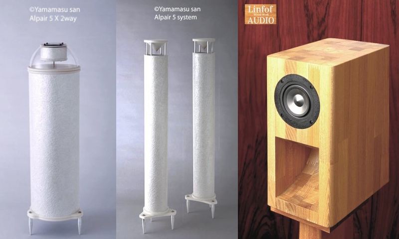

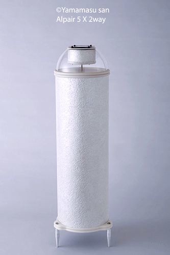

Hello Henkjan,
Very glad to read about your work using the Alpair 5. The cabinet looks fantastic quality and its very interesting to read that your design is delivering such a low frequency response.
The same attributes of the Alpair 5 are being recognised in Japan. Linfof and AY Denshi have made TL and hybrid line designs using solid wood, Corian and Polymers. There's a growing "cult" following for the Alpair 5 inside the Japan DIY audio circles since the driver was launched earlier in the year. We hope to get translations early in the new year but here's some pics for now.

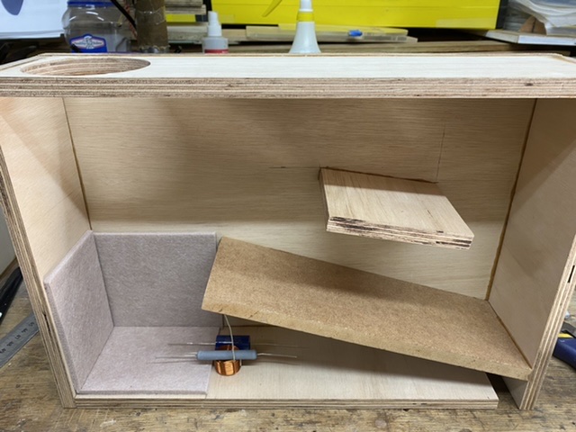

Hi there. I’m building a pair of these and have a question about the best place to position the notch filter components inside the TL box. See attached proposed location near the top of the port. Any recommendations?
Thanks,
Andrew
