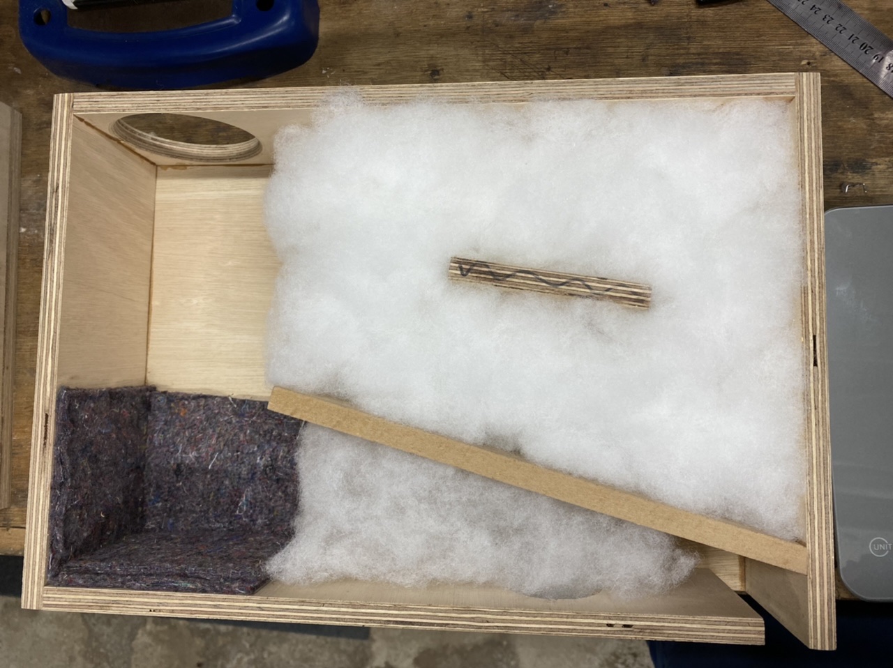

Do not do it that way. That is poly batting, and not teased. Easier to start with fluff.
Pillow stuffing is a bit different, but here is an illustration of how much bigger properly teased acoustastuff is:
The amount of stuffing you have shown would at least fill the entire box if properly teased.

I found the attached image on another forum. Stuff the bottom 3/4?
yes, but as Planet10 says, it should not be dense.
that photo is from me, you cannot see it on the photo, but especially the stuffing in the open/narrow end near the port is only a minimal amount (like 2 or 3 gram), properly teased. This is where you want to tune to your set-up by ear, a little too much here will delete most of the bass.
The stuffing in the closed/wide end can be somewhat denser, but don't stuff it. in total I used approx 45 gram there.
The dark stuff behind the driver is felt, 8mm thick I used.
I too like to add felt (12mm recycled cotton felt) near teh driver to reduce reflections back thru the cone.
dave

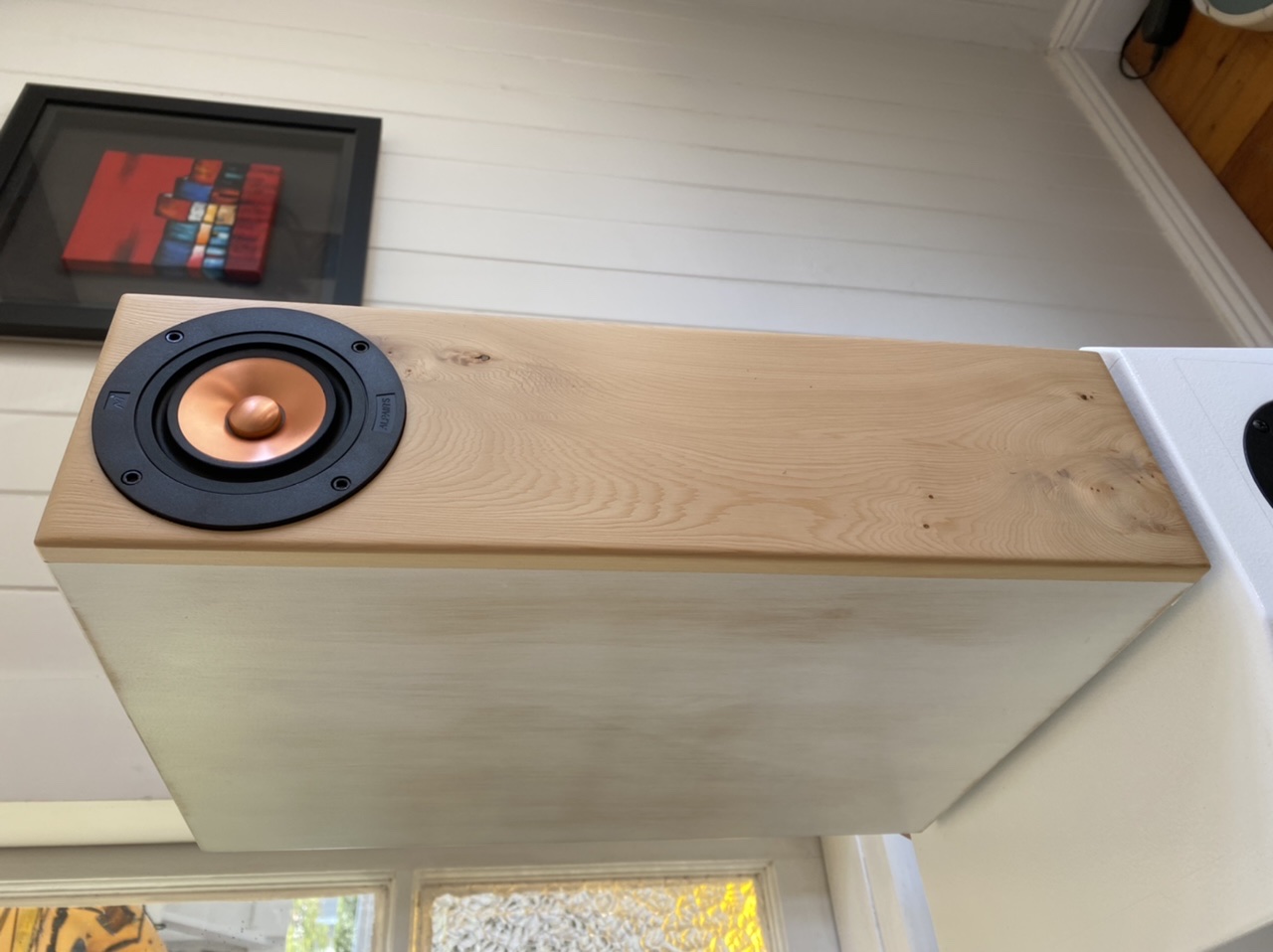

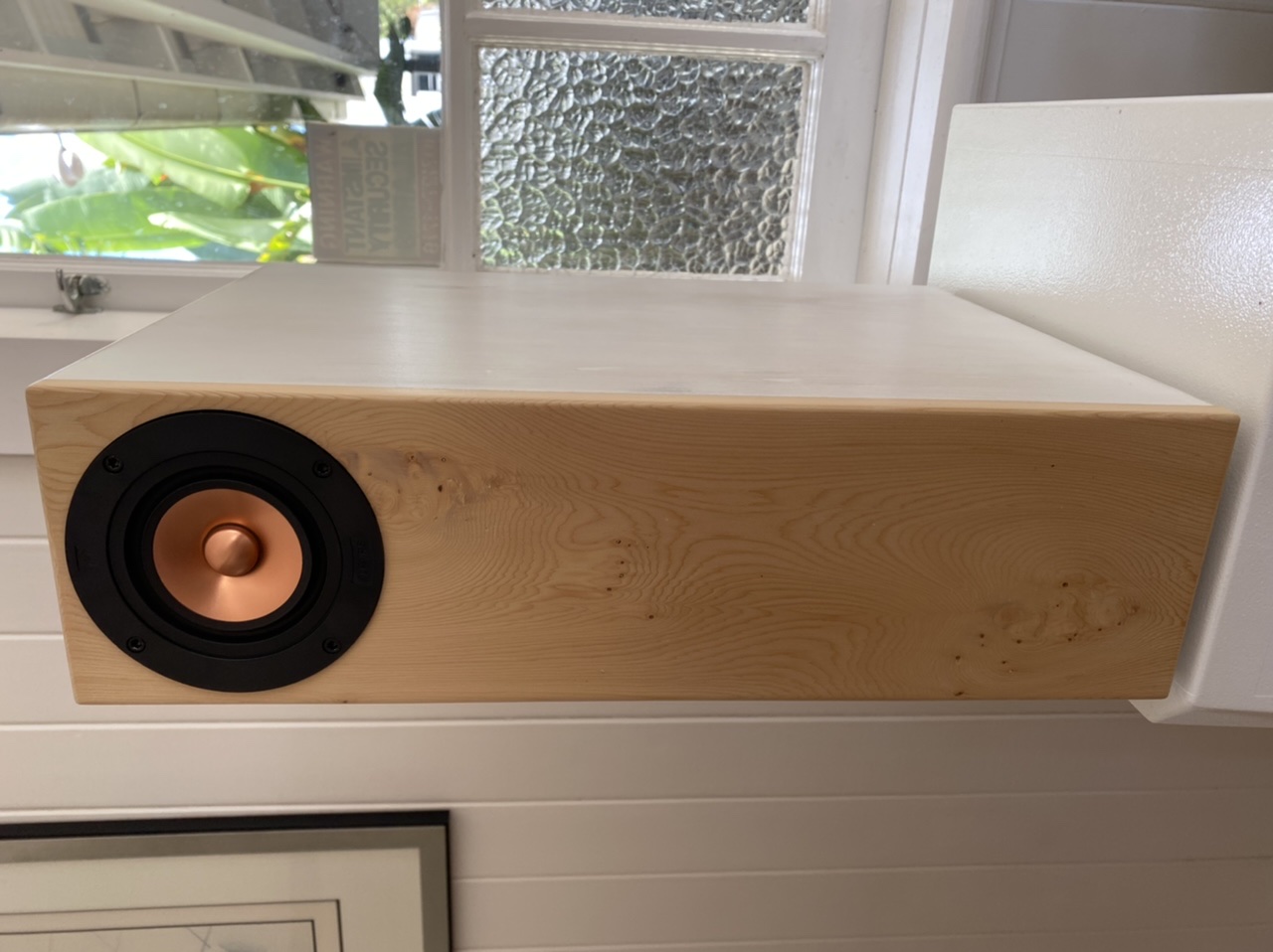

Wow. What a great intro to the world of full range drivers. These things sound great. I’m converted! Sorry don’t know why the pics load sideways..
