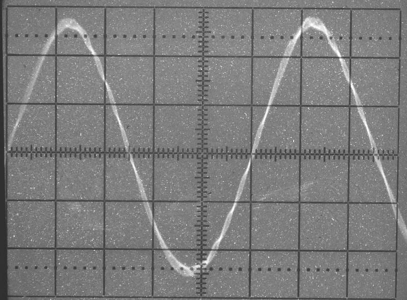

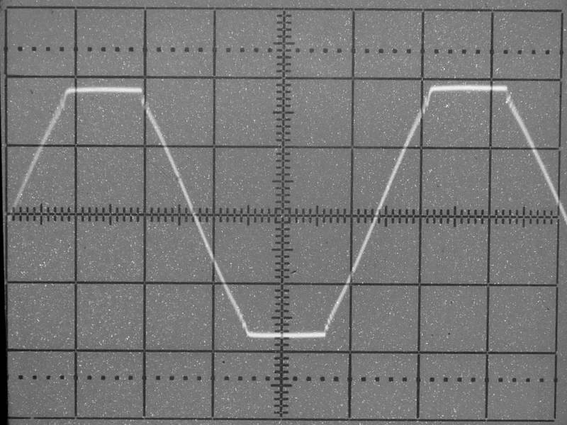

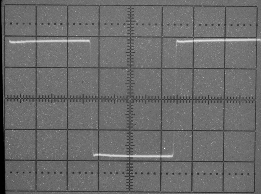

Next 20kHz sine:
1st: input 0.2V/div*10us/div
2nd: output 10V/div*10uS/div
load: 6.5Ohm resistor.

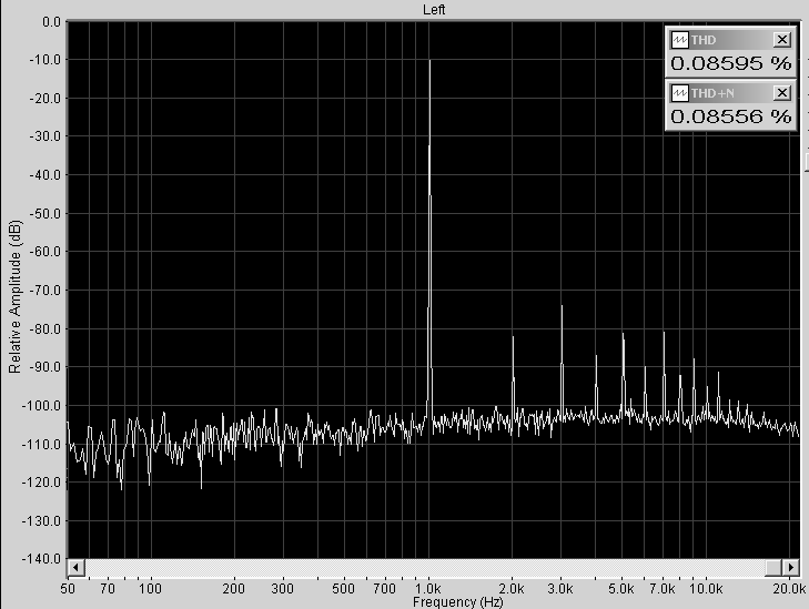

Here is some thd measurements, nothing incredible or outstanding 😀. Next pcb version is comming soon (or not soon).
Equipment: emu1212m, 24k lowpass filter (AES-17), load - good old 6.5Ohm resistor, PSU 250W torroid with 20000uF per 40V rail.
1st: 1W.
