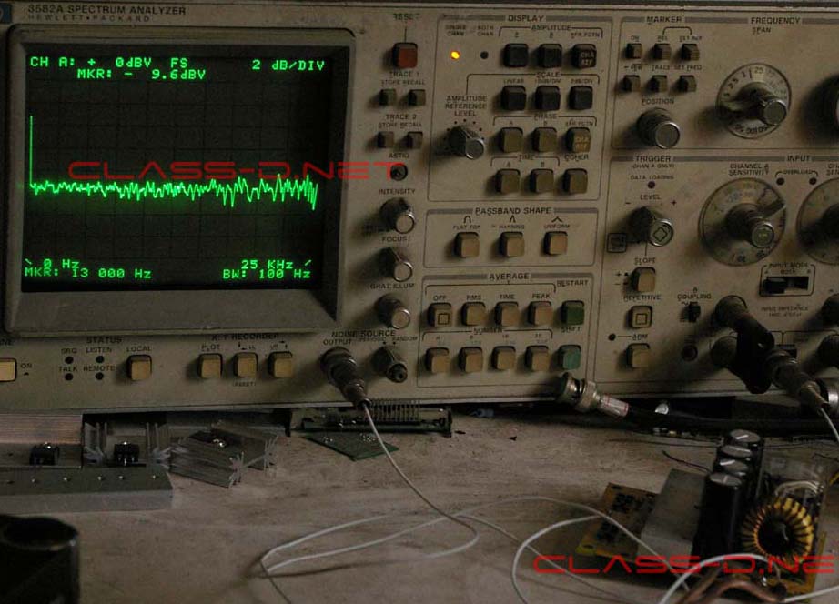

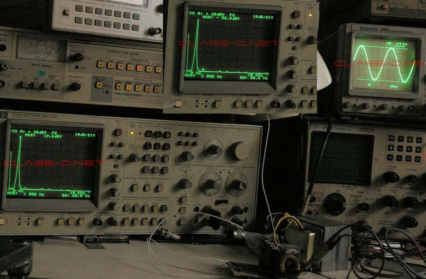

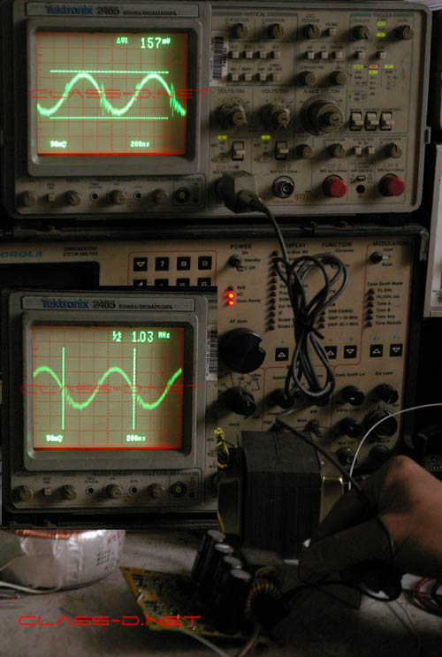

i'll post the pic of freq-respont , plus-res, osc,etc..
perhaps,the pic of pcb

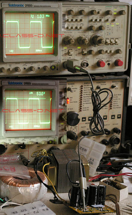

pwm base freq
this is the pic of 1Mhz PWM
NO signal input,INPUT PIN not to gnd
POWER:+- 25v DC

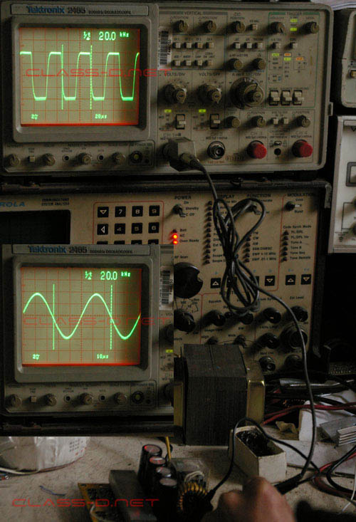

20khz square and sine
input 20khz square and sine (WAVETEK 271)
NOT SO MANY AMPs CAN DRIVER THE 20K so sharp
first time i use 400KHz pwm, the 20khz square just like 20khz sine:clown:
if down to below 400K, i cant except:)(can hear the diffrent)
