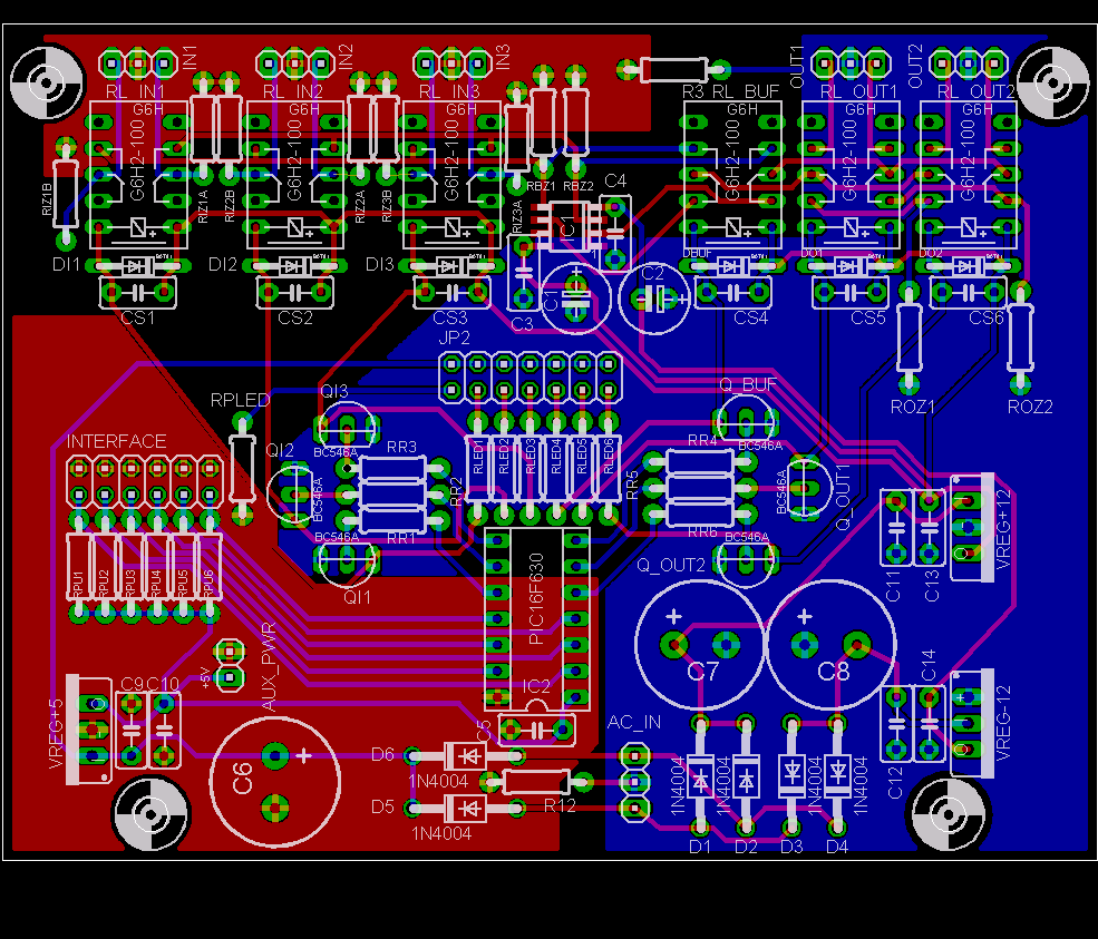

Ok, so Brian and I have been talking about a source and amp selector for quite a while. Finally it is coming to into existance... even if slowly.
The layout is nearly complete, but still has some tweaking. I know many of you guys have been asking me about this for quite a while, and I though it was about time to show some work.
Here are some details:
1) 3 stereo sources.
2) A selectable output buffer.
3) 2 outputs which can operate independantly or together, but from the same input source.
4) PIC MCU controlled with headers which allow for various input devices (switches, Qprox..., etc...)
5) On board PS for easy layout and integration with other projects.
The idea is for this to a be a companion to the Kookaburra preamp and Mauro's "My Ref" amp.
Keep in mind this is a work in progress... Stay tuned!!
Well here it is:

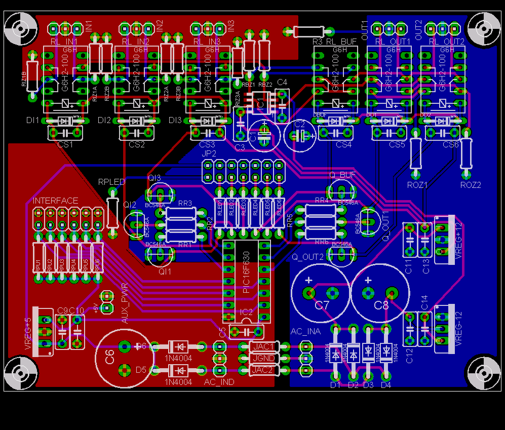

Hmmm one trafo.. or two... Your choice!
I added one more change,
I added JAC1, JAC2, and JGND which are simple 0R resistor jumpers which allow you to use one trafo or two for semi-isolated or fully isolated PSs.
Though I am pretty sure JGND should always be in place.
paulb said:You've announced quite a few new boards lately. Are you planning to sell any of them via your site?
Yes,
Absolutely...
Right now Mauro's design the monobloc REV C PCBs are in stock,
And I am just waiting for my shipment of PCBs for the kookaburra.
This PCB is up next.
All of the above will/do have kits as well.
You should be able to order Kookaburra very very soon as a matter of fact.
Cheers!
Russ
Banned
Joined 2002
jleaman said:What about a remote or a lcd ?
The interface inputs are TTL for either manual buttons or such or another PCB which could hold an IR/RF reciever and and another PIC to control the selector.
The idea is to create a duaghter add-on PCB which can control this PCB as well as the Kookaburra at the same time, both manually, and by remote.
The board as supplied will work out of the box with manual switches, etc... but it would be very easy to fashon a remote PCB, and simply use the interface header.
I am also working on a 5.1/7.1 pre which will have LCD display + and very likely, remote functionality, built in, but that is simply because its operation is much more complex.
Cheers!
Russ
