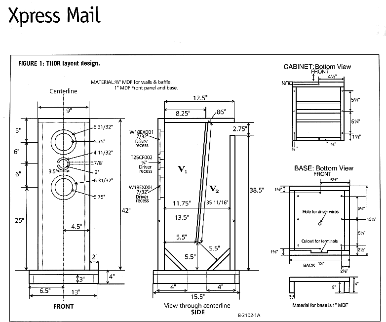

Did you change anything from the original article in AudioXpress
magazine ? I read in one post that the volume of the enclosure should be larger ?

There was a mistake in the mechanical drawing -- it was corrected in a subsequent issue (hmmm, should I find it and post here -- I note that AudioXpress doesn't have the correction on their website.)
I changed NOTHING.

Jackinnj any chance you could post this correction so that I could verify it against the madisound diagram? I would hate to spend all this time and money on the drivers to find that I was working from a superceded design.
Look here : Thor

Use the cutting guide included with the AE article, and you shouldn't hit any snags. I ran the binding posts connections into the pedestel rear.
The problem with the mechanical drawing(s) is that the lines were very faint -- not that the dimensions are incorrect.

Is there a text about the design consicerations anywere? I'm working on a D'appolito design myself, and found a few strange stings about the Thor design: http://www.diyaudio.com/forums/showthread.php?postid=437081#post437081
To quote myself:
If I look at that design, the crossover is 2.5 khz. According to this own theory (in my opinion anyway), the maximum distance from tweeter to midbass is 13,76 cm (5.417"). The actual distance in the design is 15,2 cm (5.9843"). So what's behind this? Also the crossover does not seem to me D'Appolito "compatible"... I don't know what to think anymore
