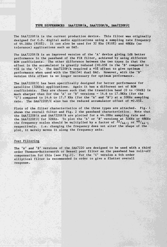

I guess all are not modified ?
Anyway, there are more differences than the DAC: the 650 has 7220A dig filter (vs 7220B) and probalbly a different decoder (7210 vs 7310). The B filter should be better, but maybe better filtering causes more rubbish on the supply lines (?)
CDM transport differs too, CDM2 vs CDM4. Saw a post somewhere that the CDM2 has a bruchless motor and CDM4 does not. An advantage for the 650..
Don't know about other differences, PS and output. I do know the 650 build quality is crap. Tutto plastico as we say.
Cant compare anymore myself, my 650 is not standard anymore.

Yes, the CD650 is plastic and the CD880 has 3mm steel plate + aluminum chassis made from one piece.
CD880 has CDM1mkII also with brushless spindle.
