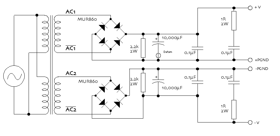

OK. Perhaps I'll post my own idea in the hope that it'll stimulate a bit of debate.

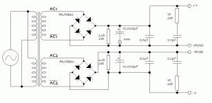

The schematic for the snubberised chipamp.com PSU looks like this.
This is the only schematic for the PSU on that site, although it appears to leave out the snubberising caps. When comparing this to a regulated design like the one below (from Decibel Dungeon), the similarities before the regulator are evident.
So, am I able to do something like this? Please note, I have left off the snubberising caps.
I have simply taken one of the application hints for the LM338 from its datasheet and slapped it onto the end of the snubberised chipamp.com PSU. By tweaking the values of R5, R7 and the Trimpot, one is able to adjust the level of regulation and, therefore, the voltage supplied by the PSU. Incidentally, this schematic looks remarkably like the one described by Tangent for the TREAD.

So, am I a mile off or does this look feasible? Any comments welcomed.

Interesting you should mention peak current, I've been having a go at calculating it for 50W power output driving an 8 ohm load using the equations on the data sheet. I have included the calculations in my build thread.Redshift187 said:I suspect it would work ok. My thoughts are:
a) is the 5A limit of the LM338 enough for the chip and voltage you are using? The LM3886 can peak at a little more than 6A.
b) the snubbering is probably not necessary. Voltage regulators offer some smoothing of their own.
Clicky
I make the peak current 3.5A.
If my calculations are correct, why do people go for much transformers capable of delivering 12A?

The first schematic you have has an error.
Here is the correct snubberised PSU schematic
- Prasad
Thanks for the revision.....but I can't see the difference between the two.

Look at where the ground lines come out of the bridge rectifiers... in the revised one, the +PGND comes from the "left" side of the bridge, and -PGND comes from the "right" side of the bridge. You're diagram has both PGNDs coming from the "left" side of the bridge.

Gotcha. It's my schematic that's wrong. I was comparing the schematic quadtech posted with the chipamp.cpm schematic.Redshift187 said:
I'll revise mine and repost.
