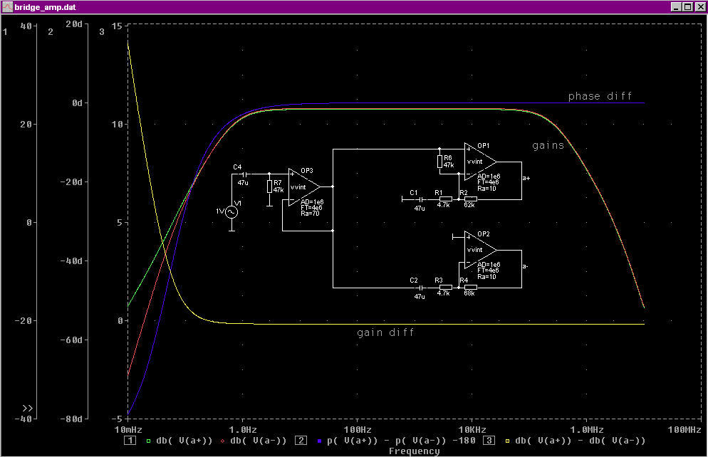

@Andrew: Like the old saying goes "two engineers will have five opinions", I see some things a little different...
There is only one input filter Cin, Rin which is effective only for the non-inv, and two filters in the feedbacks. The feedback filters should be matched, while the input filter should not add additional roll-off and phase. Exact matching is impossible, though, because the non-inv drops to gain=1 for DC while the inv drops to zero. In the extreme case of very little gain, say 2dB, there is no -3dB roll-off to be reached for the non inv.
There is a big gotcha in the schem, because if the input is left open, the ac noise gain of the inv is 68k/(47k+4.7k)=1.3 which quite certainly causes the inv to oscillate, given the phase margin of the chip. A buffer is necessary, therefore.
After a little calculating and simulating I arrived to the following values:
Rin=47k, Cin=47uF ==> Fc=0.072Hz, This RC is before the buffer, of course.
Ri1=Ri1=4.7k, Ci1=Ci2=47uF ==> Fc=~0.72Hz
Rf1=62k, Rf2=68k, G= +-23dB
There is an additional 47k resistor from +IN to -IN of the non-inv, to get equal noise gains for both halves.
One might scale frequencies up , using 22uF (~x2.1) caps. Those caps have quite big tolerance anyway...
I dare to repeat, Scott: go for the parallel variation...
Regards, Klaus
I originally came up with a different conclusion.
I have read and re-read this comment.
I still disagree, convince me.
The non-inverting is clearly filtered, a series cap Cin feeding a resistor Rin to ground is a high pass filter.
The inverting input is also a series cap Ci1 feeding a resistor Ri2 to ground (this time a virtual ground at the inverting input pin). That high pass filtering action is no different to the non-inverting. I think these input filters should be matched so these set the bandwidth limit.
The fact that the inverting also uses the same string of components Ci2,Ri2 to set the stage gain is not important to the filtering action.
Next, why should the NFB filters be matched between the inverting and non inverting stages? I note your graph shows the mismatch but it only becomes significant at well below 1Hz.
I note you are the third person to support ditching National's version of bridged and advising going parallel.
