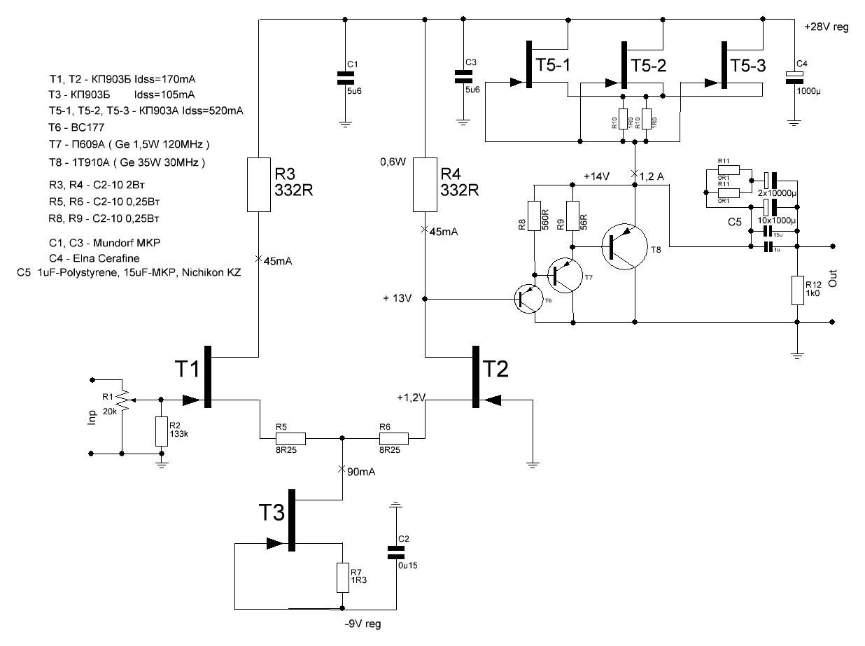

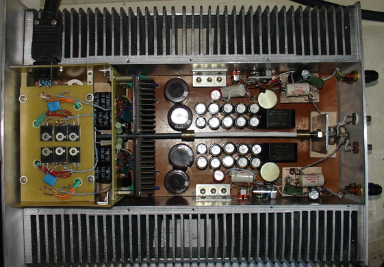

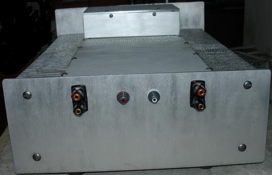

Listening ofthis NoGNFB integrated amp with germanium transistor output has confirmed an idea that Ge transistors are obviously superior to other types of transistors at the output of NoGNFB designs. Output impedance with one transistor (without paralleling) came about 0.08 ohms. Bandwidth is greater than 1 MHz. Even in comparison with the well-sounding bass from good GNFB amps, I have distinguished some new tiny bass details. Interestingly, the h21 vs Ic curve for 1T910A Ge transistor shows only growing behavior even in the range of collector currents 10 ... 20A.
The quiescent current of 1.25 A was chosen, since I was afraid of burning out the Ge.
But, the main heat sinks are only a bit warm, I guess the idling current can be increased up to 2A.
Voltage gain of the input differential stage, for the Idss of KP903 and resistor values indicated, is near 6.5. It is quite enough for me, usually I listen with the voltage gain range 2 ... 5.
Power supply is built with two R-Core transformers, every has 24V-3A and 10V-1A windings. Output voltages are further smoothed by "cap multipliers". Power supply socket is placed at the side panel, in order to avoid the neighborhood of power and input wiring.
The whole schematics is assembled point-to-point. The input pot is DACT 20 k.
Overall, the sound is excellent. As if the high-quality tube SE amp has been magically added by bass, and this is the bass that creates a new reference for me.

I would not use Ge transistors, if they are slow, and if schematics would suffer from their thermal instability. These drawbacks are not relevant to the present schematics.
Also, I guess, the base region resistance of 1T910A is unusually small, since I have got output impedance modulus around 80 mOhms. Passband -1dB is more than 1MHz.
Not bad for simplest No GNFB schematics.
If somebody mentioned difference in bass between lateral MOSFETs and BJTs at output, that one could guess further improvement with Ge compared to Si BJTs.

Hello, Carlos
Please, pay attention to the differences between that kit and this schematics.
Some of them, are:
1) this thread schematics does not experience power supply current modulation under signal conditions, PS does not stand in the signal path
2) it has No GNFB (Ge output transistors are not good for GNFB schematics, they are relatively slow)
3) it has No input cap
4) output cap is made with all possible care
5) passbands of the two designs I guess differ drastically
As for sound estimates, I have very good tube 300B SE amp, and it gives very good reference for mids and highs quality, I can easily estimate sound differences between traditional GNFB schematics and special schematics, designed for extreme high quality.

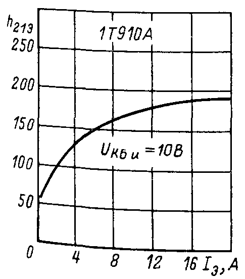

Comparing the 1T910A power Ge transistor (p-n-p) with AD162 (p-n-p) we can see:
AD162 Transistor Datasheet. Parameters and Characteristics.
Material of transistor: Ge
Polarity: pnp
Maximum collector power dissipation (Pc): 6W (35W for 1T910A)
Maximum collector-base voltage (Ucb): 32V (33V for 1T910A)
Maximum collector-emitter voltage (Uce): 20V (32V for 1T910A)
Maximum emitter-base voltage (Ueb): 10V
Maximum collector current (Ic max): 1A (10A average current for 1T910A, 20A pulse current)
Maximum junction temperature (Tj): 80°C (358K = 85C for 1T910A)
Transition frequency (ft): 1MHz (30MHz for 1T910A)
Collector capacitance (Cc), Pf: 150
Forward current transfer ratio (hFE), min/max: 50MIN (100...250 for 1T910A)
Manufacturer of AD162 transistor: PHILIPS
Package of AD162 transistor: TO37
Application: Medium Power, General Purpose
I guess, intrinsic resistance of the base region of 1T910A is some orders of magnitude less than that of AD162.
1T910A is really a peak of Ge technology. The output impedance 0,08 Ohms with 1T910A is not emulated by GNFB, it comes from intrinsic properties of the transistor, connected as emitter follower.

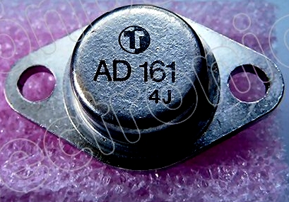

The amplifier with AD161/162 I used only Ge transistors: 2SB486 PNP low noise at the input, 2SD352 in VAS (ground referenced and not supply referenced = far more better PSRR) and AD161/162 at the output with quiescent current of 200mA, and 20V supply. The thermal compensator is an AC188. As in this amplifier transistors used are all low fT, the distortion increases as going up to 20 kHz starting from 1kHz. 1W / 8R (2H and 3H, with some 4H and 5H), we 0.03% THD at 1kHz and 20kHz to about 1% (but these amp is very stable due to "marriage" fT). The damping factor I do not measure. But I reduced him to the technique of defining the impedance of the amplifier, because with raw operation sound are harsh.

I like the design but have my misgivings about using KP903 as simple current sources, these parts really deserve a better use, I doubt there would be any serious degradation using a regular SI - or for that matter Ge - transistor as a current source. Especially for T3. Also giving each of the 3 parallel KP903 in the current source their own Rs would probably result in better current sharing.

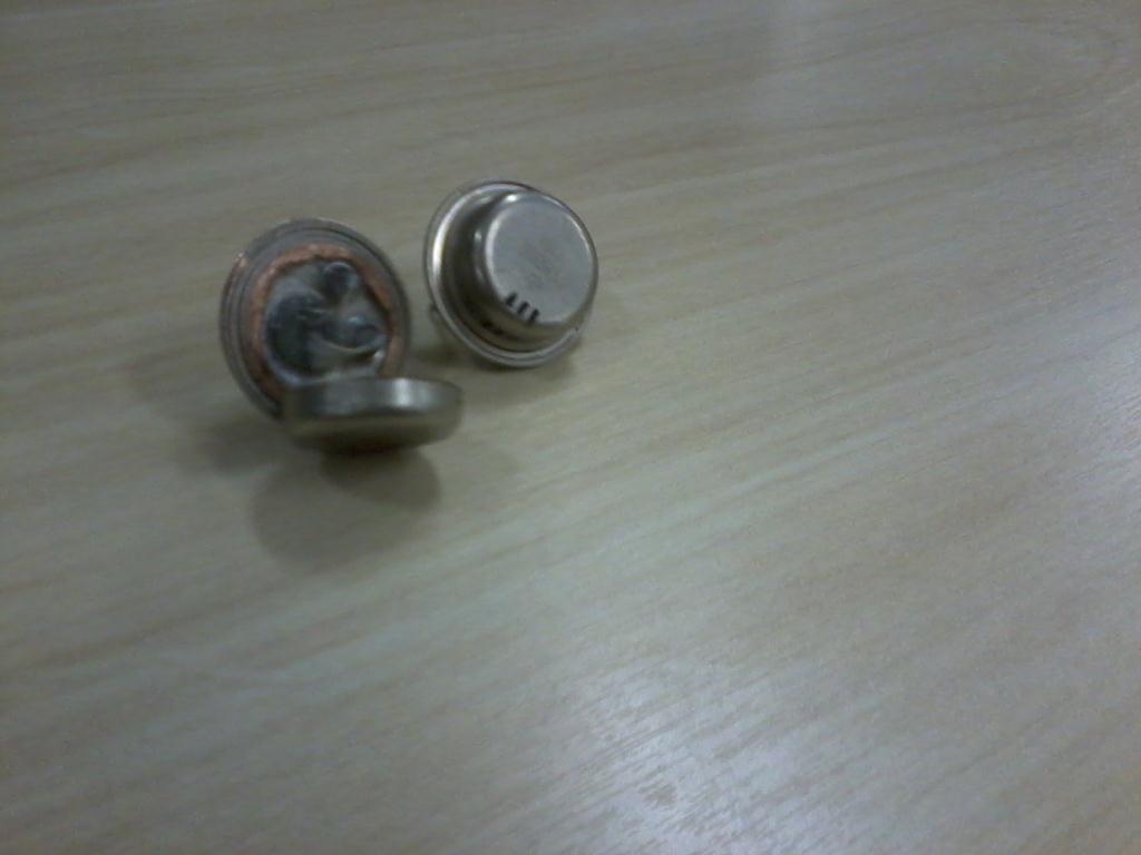

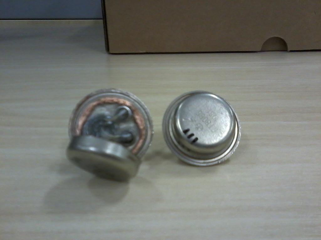

Really, they are far more advanced than ordinary vintage Ge. I sawed the top of one damaged GT806B (my fault)(in time: ГТ806Б), and the die of the same does not resemble even remotely the vintage Ge (I need to take an photo and post here). The GT806B are not so advanced as the 1T910, but still belong to this class because they have excellent but not so good beta than 1T910, only a little loss to 10A (try it with almost any 10A Si transistor), have an 10MHz fT and provided the results I described in my previous post (the valve-IRF9610-GT806B, not the AD couter-example), and I confirm the impossibility of obtaining this performance with ordinary Ge (I tried the follower with AD149, the damping factor deteriorates, and 20kHz THD sucks).
For more info, I used Si MOSFET, the IRFP9240 (well, I don't know if Ge MOS exists...:D) on my current sources, with expected good results. Better for saving the rare high-fT Ge....:cool:

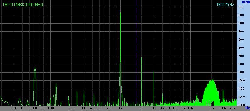

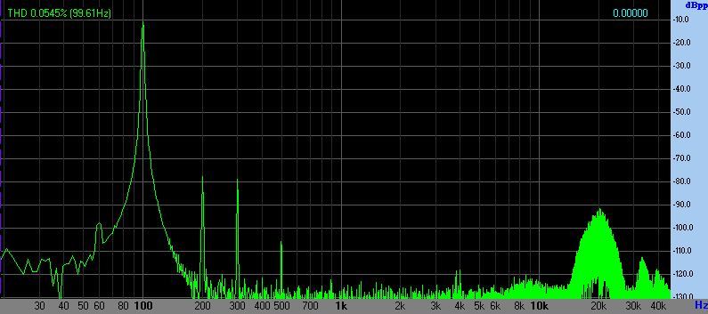

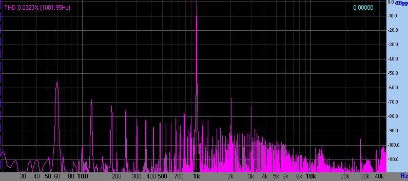

Some test results...

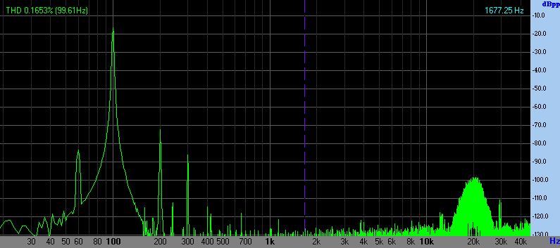

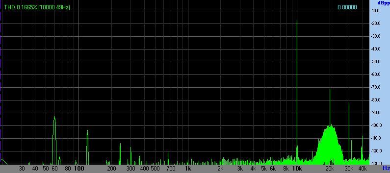

Here are some FFT test results from "conventional Ge"
The bump at 20kHz is due my test disc (not oscillations or suchlike). At time I executed this measurements, the internal sine generator from FFT program (VA) are polluting low level with high order distorition, and this test CD has pure sine signal.

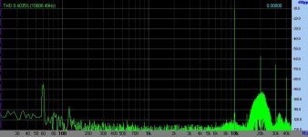

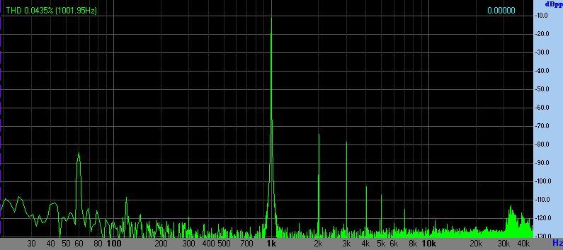

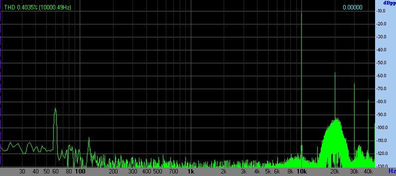

Now from russian Ge (excuse the line interference in some measurements)
V-MOS are from IRF9610 + GT806B
other are from AC188+GT806B (some AC188 selected for less THD20k)

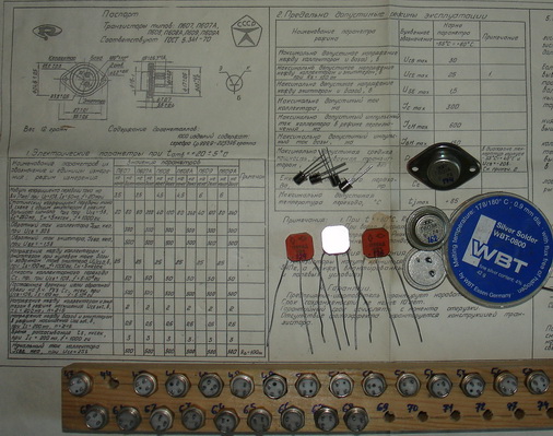

Russian Ge photo...
My cellphone camera SUCKS :whacko::RIP::mad:
Interesting round disc die and multi base-emmiter connections :cool:
These russian Ge sounds good for low power and closed sounding speakers (they became alive):) not unlike my 300B amp, but with some differences due to enormous natural DF (damping factor) and others things

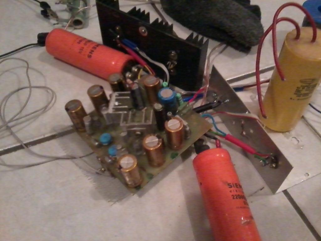

Last picture...
This is from my AD161/162 prototype ("conventional Ge"). Note different heatsinks for channels, because I used things at hand...
First time I built it was in 1996, in mono, using Telefunken output transistors and with more than ten times the actual THD (I upgrade the circuit several times since I start to using FFT analysis).

Struth,
The PS don't stand in the OUTPUT signal path for in VladmirK thread project and also in mine Russian Ge, because both are SE with "original" output capacitor connection, like SE Power Follower from Andrea Ciufolli.Loudspeaker current goes isolated from supply because T5-1-2-3 are power JFET (pentode-like), configured as an current source (VladmirK, please correct me if I made some mistake about this part). Hence, current variations do not circulates in power supply. All loudspeakers current circulates between T6/T7/T8, ground and output capacitors. Some little pre current goes to R4 and circulates in power supply. My version is hybrid and not have "an R4" (hence zero power supply modulation).
(but PSU yes are in signal path for the conventional Ge: it are an trivial SEPP; the AD161 pull current from supply).
All normal PP versions I know have an node or two circulating current to PSU electrolitics (even the so-called "magic" Ciclotron...). BUT if you make some BTL PP ("dual SEPP balanced"), in class A you can average the sypply current variations to zero, like trafo coupled PP.
