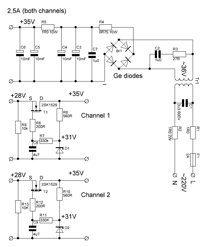

Dear Vladimir can you provide please the schematics for the +28VDc and -9VDC (cap multipliers and so)?
Jean-Paul
For +28V, I propose something like this. For -9V, another winding and source follower with p-type mosfet.
Hello Vladimir,
thanks you for the schematics.
Do you have a replacement for the 2SK1259?
And do you have the -9VDC supply schematics as wired in your amplifier (I don´t want to reinvent the wheel)?
Jean-Paul
IRFP240 could be a replacement for 2SK1529. For -9V supply I used Ge transistors connected as diodes at bridge rectifier. Actually one can use source followers by analogy to +28V, and small soft recovery ultrafast diodes at the bridge. Even more, I would propose to try 5W zener for 9V. Do not afraid to use another good variants.
You use some Ge-Diode for rectifying. Are they available (what is the value for them?)? I replace them with DSS16 Schottky-Diode! It is ok?
Go with DSS16, seems to be a good choice.
