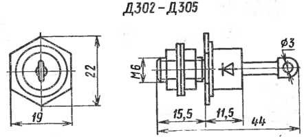

I just had a look of what I have from Ge diodes, and could offer 16pcs of D304 (as one lot). We could discuss this subject via private messages.
Hello Vladimir,
good news for the diode. Do you have a datasheet?
Jean-Paul
Electrical parameters
Continuous forward voltage at Uf = If.max, not more:
at T = 25 ° C:
D302, D304 0.25V
D303, D305 0.3V
Average reverse current at Urev.i = Urev.i.max, not more:
at T = 25 ° C:
D302 0.8 mA
D303 1 mA
D304 2 mA
D305 2.5 mA
at T = 70 ° C:
D302 3 mA
D303 4 mA
D304 10mA
D305 20mA
Limit operational data
The peak reverse voltage:
at T = -60 ... + 25 ° C:
D302 200
D303 150 V
D304 100 V
D305 50
at T = 40 ° C:
D302 150 V
D303 140
D304 100 V
D305 50
at T = 50 ° C:
D302, D303 120
D304 100 V
D305 50
at T = 60 ° C:
D302, D303 90 V
D304 70 V
D305 50
at T = 70 ° C: 50
Average forward current:
D302 1A
D303 3 A
D304 5 A
D305 10A
at T = 40 ° C:
D302 1A
D303 3 A
D304 4A
D305 8 A
at T = 50 ° C:
D302 1A
D303 2.5 A
D304 3 A
D305 6.5 A
at T = 60 ° C:
D302 0.9 A
D303 2 A
D304 2.5 A
D305 5 A
at T = 70 ° C:
D302 0.8 A
D303 1.5 A
D304 1.8 A
D305 3 A
Average forward current overload factor within 0.5 seconds:
D302 4 If.av.max
D303 1.5 If.av.max
D304 2.5 If.av.max
D305 2 If.av.max
Frequency without reducing of electric modes 5 kHz
Ambient temperature -60 ° C ... + Tc = 80 ° C
