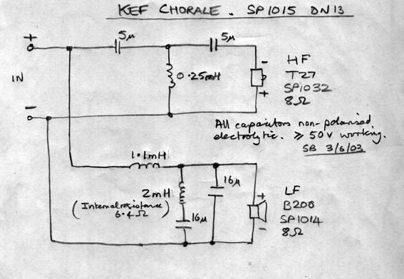

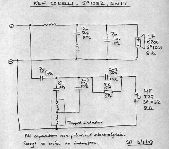

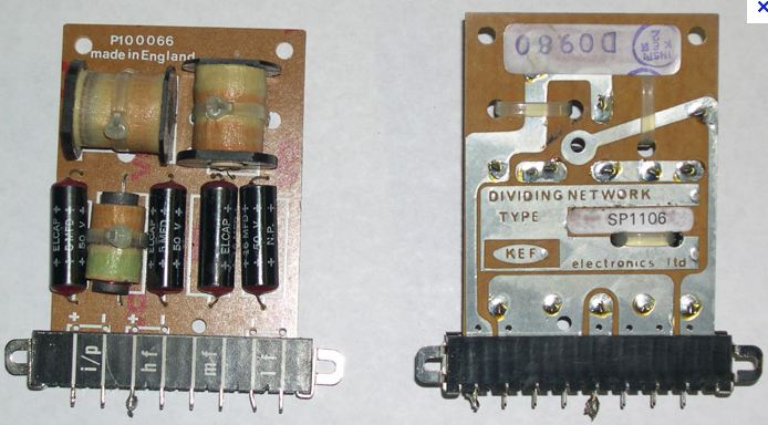

Below is the Kefkit1 SP1106 crossover, aka known as the Chorale. I see the same components as the Chorale schematic I posted earlier. You get the notch too.

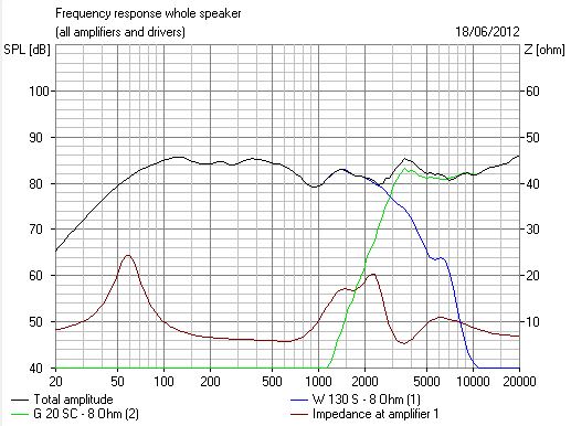

The notch is quite a deep one at 900Hz. About 3-6dB. Worth doing it if you can, I'd reckon. A bit of progress anyway:
The 1.1mH woofer coil is doing quite a big bafflestep which boosts bass. 16uF looks like the value to go for with that one, even without the notch. The notch doesn't interact with the rolloff. :cool:
Matching the SEAS tweeter is NOT trivial though. That 3rd order highpass is quite steep and sensitive to the exact tweeter. Be much easier on a second order really. But overall, it looks like you try and get the woofer right and then line up the tweeter as a plan. Personally I'd use a much smaller woofer coil (Le for the woofer is a mere 0.45mH), a different capacitor and wallmount these.

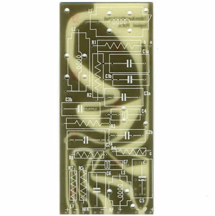

A closer look at the falcon crossover gives this info:
KEF B200A/T27(equiv.to DN13 SP1015 but with higher power rating)(SP1106) (single)
J.Mathers, HiFi News, June 1972 (Used in KEF Chorale and KEFkit1. See also 37K)*
M.Colloms, Pop. HiFi, Dec. 1972 mini ) High Power (PCB2)
*We have a Chorale cabinet upgrade sheet. Add a ‘stand’ sub-chamber and get +5dB below 45Hz.
At the same time upgrade the network or replace with our No. 37K with aB HF section (SASE)

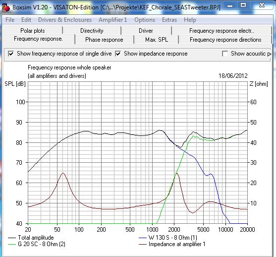

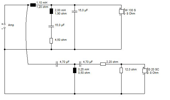

I've drawn up a circuit that follows the SP1015 design and incorporates the necessary HF attenuation for the SEAS 22TFF tweeter. Not certain if the parallel resistance can go in series with the 0.25mH inductor and if the series resistance can go in parallel with one of the 5uF capacitors though.
Curiously that models rather well, but the tweeter section is a bit odd. It's a very good thing to have the attenuator right in front of the tweeter to get a smooth sound. :)
You DO need 6.4 ohms resistance in the 6dB woofer notch, or it becomes 12dB, which is excessive. I found this whole thing worked best on phase with non-polar capacitors and a quite resistive 0.25mH coil around 1.5 ohm. It cures the peak at 3.5kHz on the high pass. The KEF filter also works well with losing the second 4.7uF capacitor and going second order, but KEF are such good engineers, that the peak may align with a dip on the woofer for all I know and the crossover is an essential part of the very good KEF sound. BTW, don't take the sim too seriously, I'm using different drivers.
Overall we come full circle back to that falcon acoustics chorale kit, which will doubtless work well with the attenuated SEAS and maybe a tweak here or there. It's gonna be a lot tidier than trying to build it yourself.

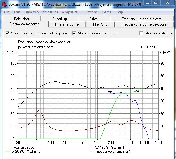

The Tangent TM1 uses less bass rolloff than the KEF Chorale, so the resonance is less marked. I'm using a 5" paper bass here which has a strong peak at 1300Hz that usually needs treatment with my preferred LCR parallel trap. KEF often used traps with the B200 too. The Tangent puts a 27 ohm resistor alongside the 0.392mH tweeter coil to damp the tweeter crossover peak too.
It's odd but true that drivers seem to bend their frequency response at the resonant points. I have noticed this with cone tweeters too. Odd and interesting. Steep rolloff causes more problems than gentle rolloff in general.
