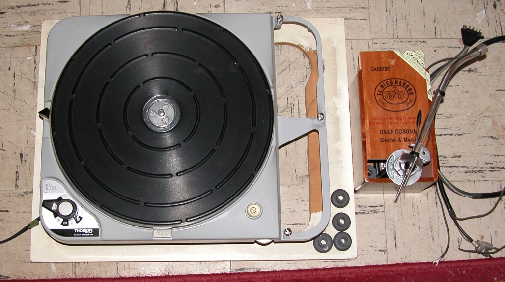

I have just acquired a fairly clean, and low hour TD-124 MKII with an SME 3009 Series II arm which I am going to restore.
I acquired this from a parent of a friend who lives in Manhattan so you imagine the day I had yesterday driving down and back as a consequence of this TT purchase.

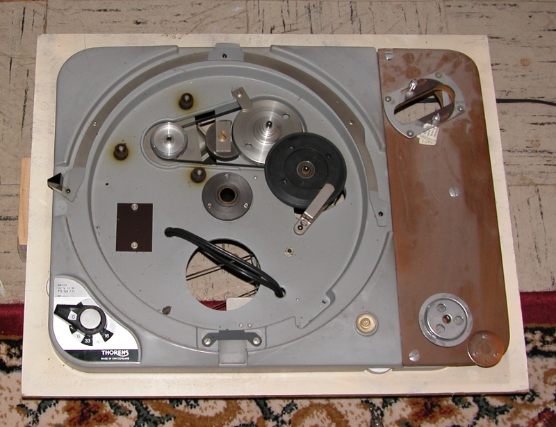

The TT was a built in and does not have a plinth of its own. Every last bit of rubber with the exception of the belt and pulley has deteriorated to the point of needing replacement understandably..
The lubricant in the motor bearings has turned to glue so rather than just clean and reassemble I have decided to install a motor bearing upgrade kit which replaces the tinned bronze bearings with precision machined sintered bronze bearings, new felt pads and all of the hardware required to reinstall the bearing caps on the motor. (Should this prove not to be as good as claimed I will keep the old parts for that eventuality.)
I need to replace the motor mount bushings, the "gummi-muffins" which are the TT mounting bushings, the six pads on the platter, the belt.
I also plan to install a stiffer bearing cap on the main bearing but since this is a late model MKII I plan to retain the original sintered bronze bearings as they aren't worn at all..
I haven't quite decided on the plinth, but I am thinking to start it will be one of the moderately priced ($400 or so) CLD plinths available on eBay.
This unit has the later aluminum platter so I can use my Zu/Denon DL-103 without concern for the issues of magnetic attraction with the earlier iron platter - the down side is the aluminum platter is reputed not to perform quite as well due to somewhat lower overall mass.. The older iron platter apparently somewhat less resonant, not that this platter appears to have an issue.. The other significant difference is the strobe on the platter is 33 rpm only..
Parts in some cases will be sourced from Octave, and in others from a couple of well regarded eBay sellers of TD-124 parts and upgrades.
The arm has already been cleaned up and is complete and in very good condition except that the decoupler will have to be replaced. (They're readily available.) I also plan to install RCA jacks on this arm as I have done on my other.

Kevin, it seems as though you got a great deal. I am contemplating some of the same things with a Thorens I have.
The motor bearings are said to be sintered brinze and tinned, depending on the articles one reads. Let us know what you find inside that motor. I think that the MkII has six rubber motor mounts that might be best upgraded with silicone gel bushings available on Ebay. They are said to better insulate vibration.
Why don't you build your own plinth or have it made locally, as there will also be some pretty expensive shipping charges, I assume? Do you plan to renew the rubbers for wounting to the plinth, or hard mount it as suggested by some to sink vibration to the plinth?
The last thing, why do you plan to upgrade the spindle bearing plate assembly? What improvements do you hope to obtain? Please keep us posted as this project moves along. Good luck!

Yes, actually I am planning on a bearing plate upgrade as well, there are so many to choose from so I am going to do a little more research, none short of a full bearing replacement are more than about $70 or so, not exactly extremely expensive. (Stainless steel, gun metal, and bronze are all on offer.)
The motor grommets I ordered are silicone gel types ordered on eBay today in fact.
I also ordered silicone gel bushings for the chassis to plinth interface, and will try both with and without them to see what is preferable given the plinth in use.
Long term the plinth will be some sort of CLD type, I have some hope of finding a counter top fabricator that would be willing to make me a slate plinth. Mixed hardwoods are another more realizable option as I can either do that myself or my father in law may be interested in the project..
