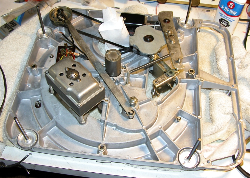

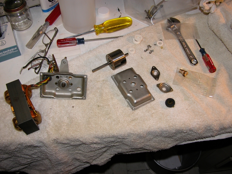

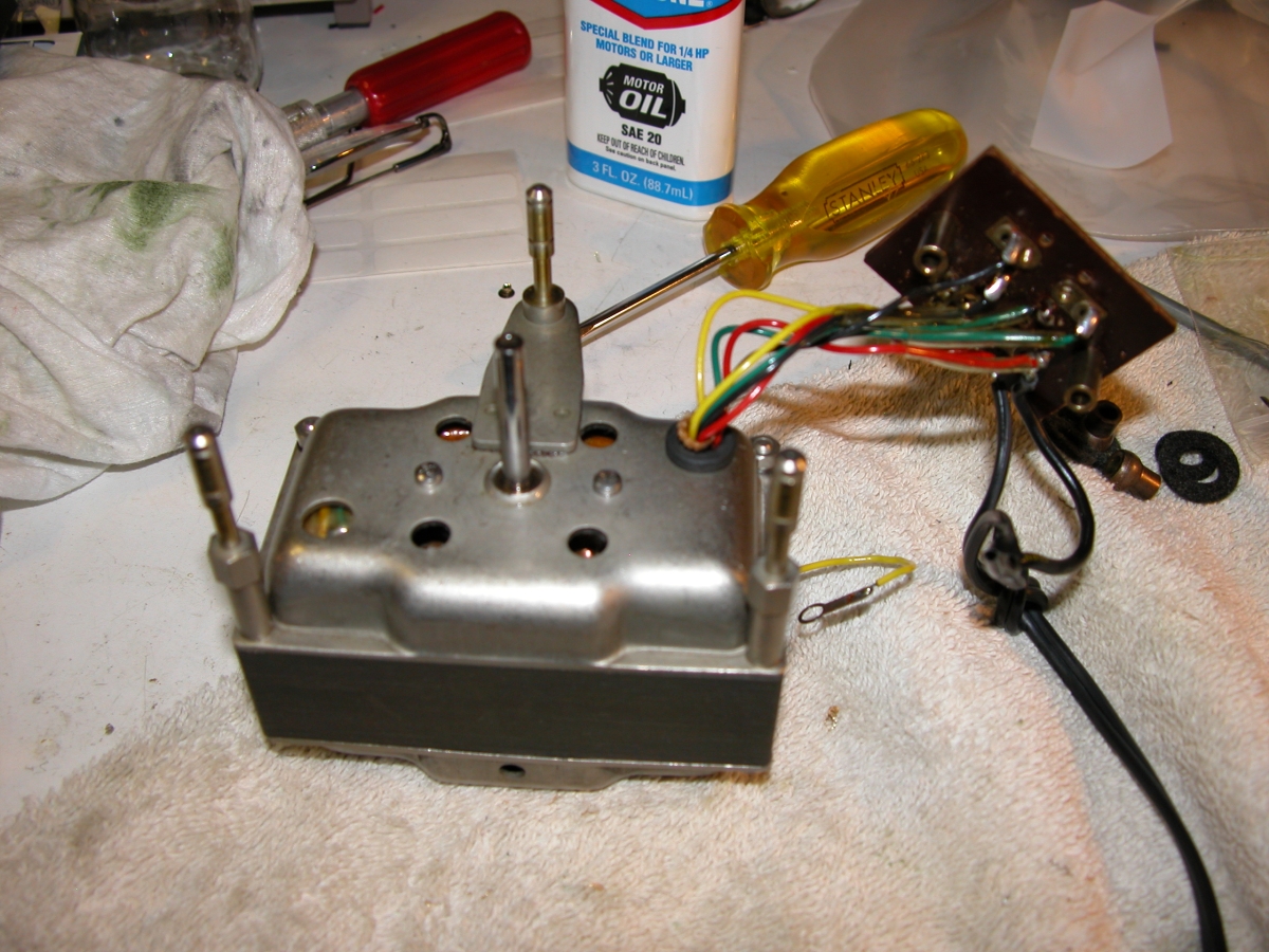

Glad to hear that, and without further ado, here are some more pix..
You can see the drive train in various states of disassembly. Everything was thoroughly cleaned and then lubricated prior to reassembly.
The Eddy current brake was suffering from dried out lubricant so I removed it and cleaned all of the sliding surfaces and then lubricated with teflon grease and reinstalled. Works perfectly and needed no re-adjustment.
The motor came apart fairly easily, used a combination of "modified" (read ruined for anything else) and small adjustable wrenches. The hardest part was actually removing the pulley..
One area where I may not have done a good enough job is with the pulley positioning mechanism. The lubricant had turned to glue and I removed what I could without fully disassembling it - it works but takes its sweet time engaging particularly when it is cool down here. I need to take it apart and clean it properly and relubricate it to solve this issue.
The motor was run in and tweaked over a period of 3 hours before re-installation. The bearings and felts are new, 20wt electric motor oil was used to lubricate the bearings. The felts were thoroughly impregnated with this oil before assembly which is EXTREMELY messy.. :D The motor was loosely assembled and alignment tweaked for lowest noise and then run..

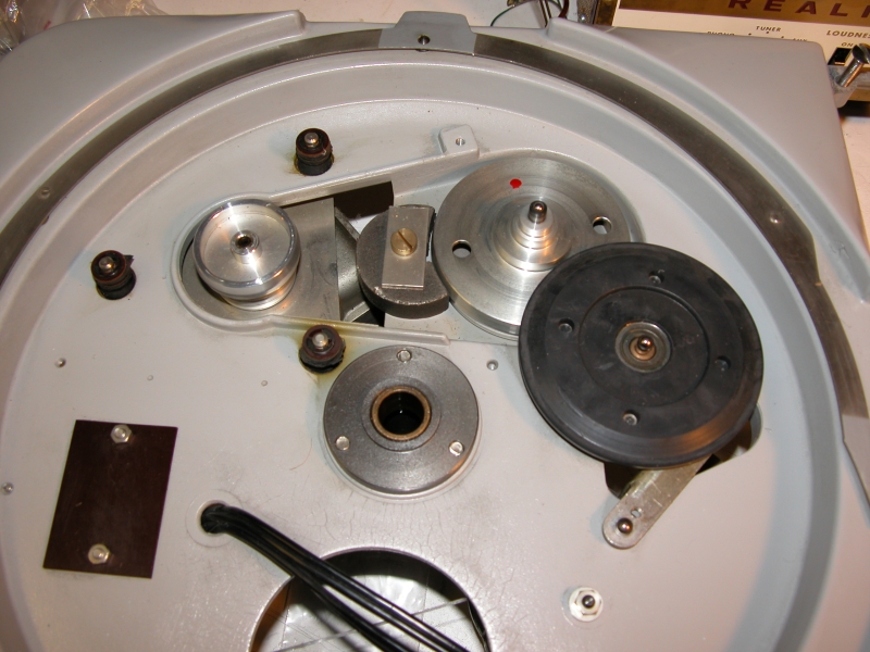

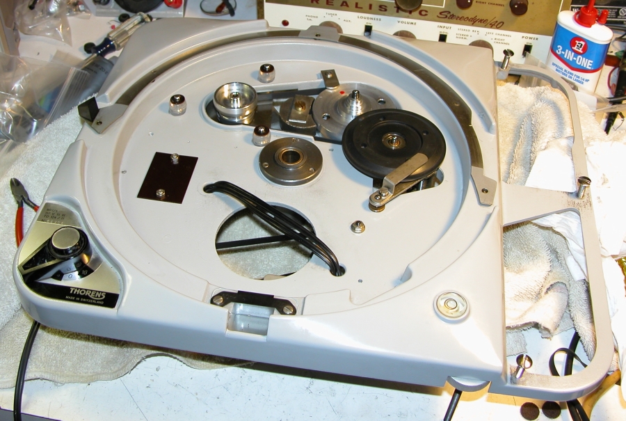

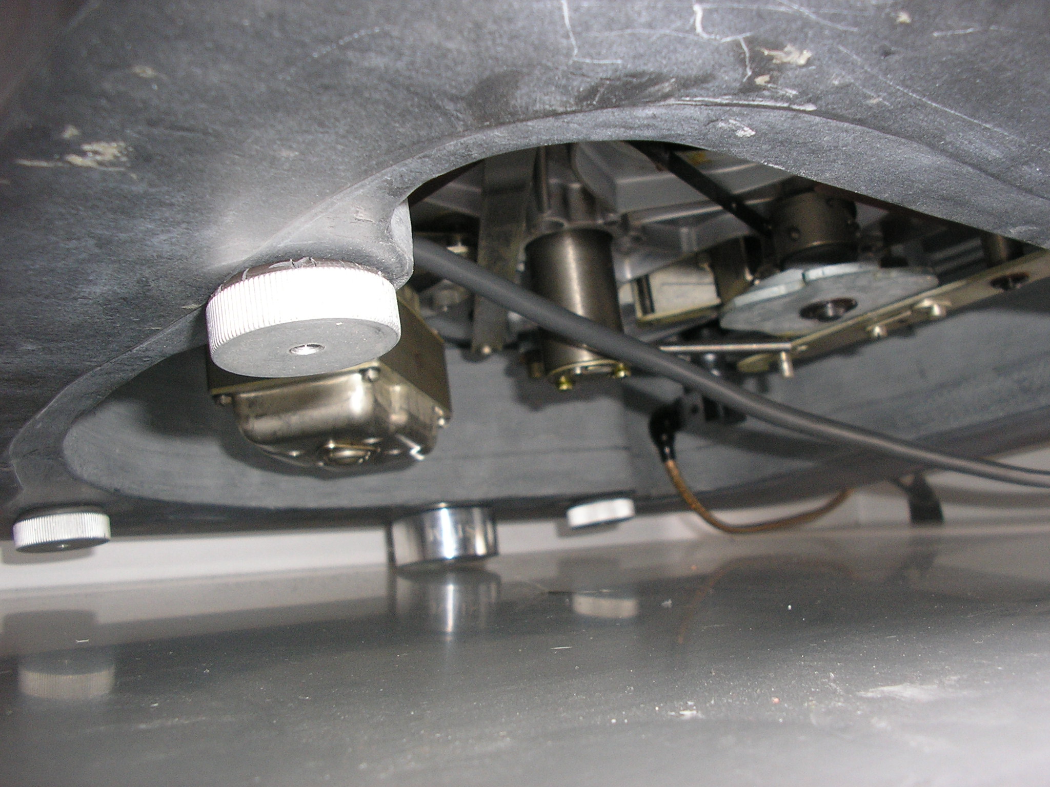

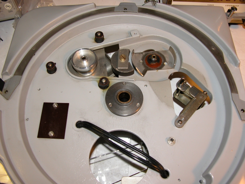

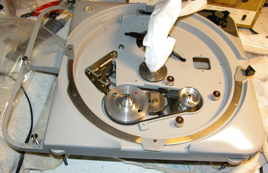

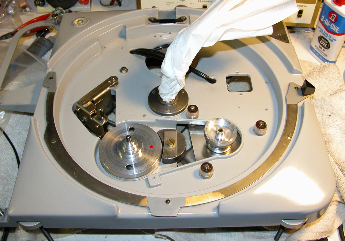

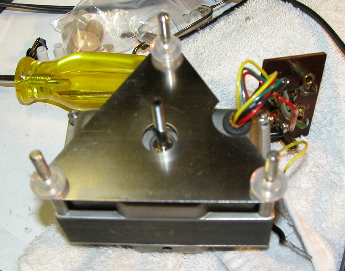

Here are some more pictures of the table going back together..
Shots showing the restored motor with new gel bushings installed, table without and with motor.
Getting ready to install belt, pulley and retainers.
Check the position of the motor drive pulley with the belt installed before installing the brake/drive pulley retainer, and idler pulley.
Note that the material in the main bearing is a laboratory grade lintless wipe - you do NOT want to use paper towel here!
The lubricant used is "3 in 1" brand special motor oil 20wt which was recommended by a number of people who work on these tables, and I used it everywhere the old Thorens oil would have been used..

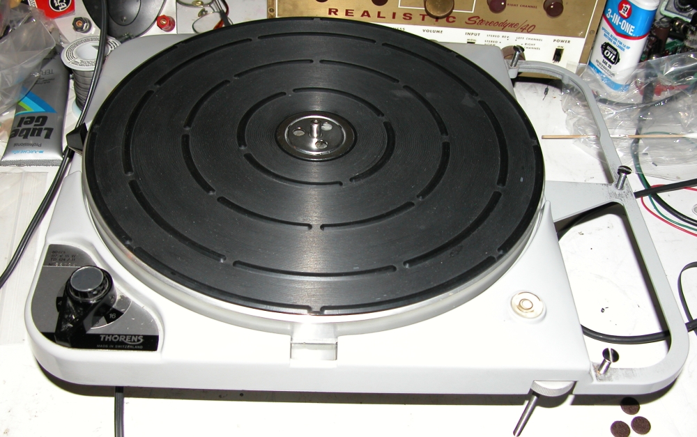

Very nice! That brings back memories. Had forgotten all about the eddy brake.
Before solid state electronic controls* shaded pole induction motors and eddy current brakes were the most economical way to control speed. It's kind of primitive and consumes a significant amount of torque as the motor with no brake applied will be running about 3% fast - this brake has a total range of 6% (+/- 3% of nominal)
Note that the zinc/aluminum platter supposedly fitted to a limited number of MKII turntables apparently seemed to be fitted more often than not for the North American market. I've seen several and they all have this non-magnetic platter. Mine is very late so perhaps the iron platter was no longer being made by this point?
I'm planning to save my pennies for a Schopper replacement platter if I really like the end result of all of this work. ( This is a non-magnetic high density iron platter that Thorens would have used back in the day if the materials had been economically viable) We'll see as it is rather expensive - I would have to be completely committed to this table first.
Note that when refilling the bearing do NOT overfill it! Add a little at a time, add too much and if your bearings are in excellent condition the spindle will NOT seat in the housing as the oil cannot escape. I discovered this to my considerable chagrin and had to remove a lot of oil after filling the bearing housing too full. The gaskets on late MKII seem very tough as well, probably not universally the case.
It will be getting a very nice plinth sometime in the near future.
