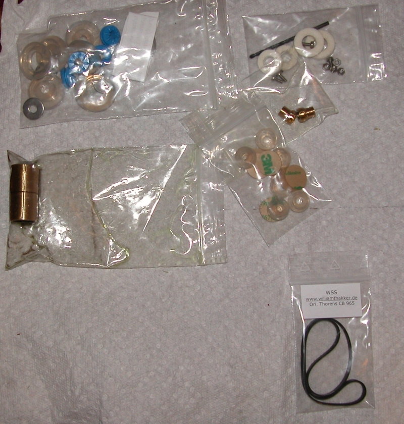

Heard today from the eBay seller of the many rebuild parts I bought for the TD-124, they are all in and the parts will ship this Saturday..
Recent massive multiple computer failures means I have two computers to rebuild before I can start the next phase of the TT project, but I will document and photograph at least some steps along the way once I do get going.
Administrator
Joined 2004
The parts have all arrived for the mechanical refresh.. Included are all of the parts needed to overhaul the motor, isolation bushings and a bunch of other parts. Now I just need to find the room to start on this.. Guess that means I should relocate some stuff off of the bench.. :D
I have managed to clear a little space and will start the disassembly, hopefully I can complete the overhaul before the next round of computer parts get here; I will need to focus on that once that happens.
To the right of the picture are the motor parts; felts, bearings, and fasteners, directly below are the special Japanese made motor mounts, and below them is a new Thorens OEM belt sourced from Thakker..
To the left are the TT chassis mounting bushings, again Japanese made, and they may or may not be used in the final iteration - depends on what arm and what plinth I am using..
Note that these parts cost about 3/4 of what I paid for this TT, however once installed the table should perform better than new.. So worth it..

Perhaps a bit of hyperbole, OTOH, fresh motor bearings and felts are a lot easier to deal with than cleaning the mess that came out of the motor bearing housings. Green goo - is that what oil turns into as it ages? :eek: And quite gluey - some harsh chemicals required.
The gel motor mount bushings are considerably better than the stock or replacement bushings typically available, and they seem to do a pretty good job..
The machine is running on my bench.. It seems reasonably quiet, and should get quieter with some run in time. (The motor got about 4hrs worth)
Obviously I will never know how this machine performed when new as I was not there at the time, the friend whose mother I purchased it from was, unfortunately had nothing more than anecdotal comments.
Better than new is more or less an expression of my enthusiasm.. (Limono this is for you.. :D ) Get yours sorted out and we can compare notes along the way.. Our journey may not be that different - I have no particular expectations of success, just a lot of hope.
I will say that with the rebuilt motor the speed stability is quite good, and it comes up to speed quickly - this all based on observing the strobe as I have not yet got an arm board and mounted the arm on it. I will say it seems more speed stable than the old TD-125...
I'll post pictures tomorrow evening as I need to go to bed. I took a lot of pictures of it coming apart and going back together. This work with fresh bearings only takes about 6 hrs from start to finish, cleaning and re-oiling bearings will make that about 12hrs I'd guess.
A quick observation, don't overfill the main bearing regardless of web advice - in my case the bearing is so tight that the shaft just sat on the pool of oil and would not fully seat - I had to remove more than half of the oil I added. Also on the MKII at least it seems unnecessary to remove the platter before reinstalling the spindle in the bearing well - just don't force it.
FWIW, the parts to completely overhaul most of this table cost little more than a few minor "spare parts" for an SME 20 with which I am well acquainted, and I also got a reasonably good deal on the purchase of the TT which came with a restorable and now restored SME 3009 Series II. For those who like to tweak this table offers a lot of opportunity.
