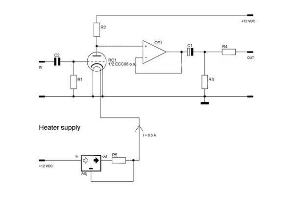

Maybe this is better:
http://diyaudioprojects.com/Solid/1...damp/12AU7-IRF510-Headphone-Amp-Schematic.png
It's for headphones, so maybe I'll just couple it to the LM386 for the power amp section.

I've already agreed that the schematic in the first post is not good for what I'm looking to do. I was now focusing on the second schematic in post #4. Since this is a headphone amp, I would think it would have to be halfway decent to listen to. I'm just thinking of coupling that to some sort of small chip amp for a compact stereo amp that has a nice tube sounding front end to it. This approach also has the added benefit of being able to use it with a pair of headphones and bypassing the power amp section altogether.
Glenn
But it still has far too low a supply voltage, so the only "tube sound" you will get is distortion. If you want to use a valve then you need 30-40V minimum; even then you will get some distortion. Valves don't magically wipe away "SS sound" - like any other component they either add/subtract very little (when used correctly) or add their own distortions (when used badly).

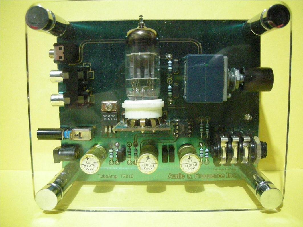

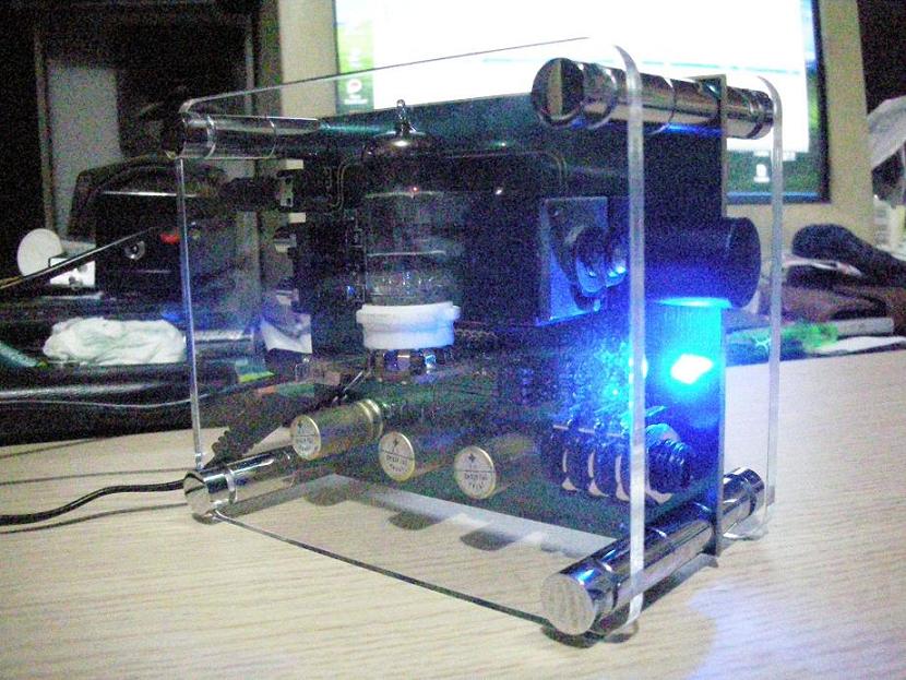

Just for fun I built mine in a cigar box!
LOL couple of hours after work!
DF96 I have now put an LED under the tube, because it annoys people!
