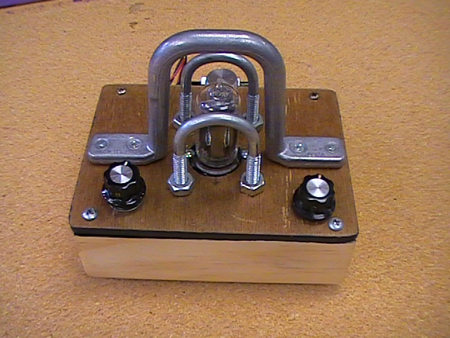

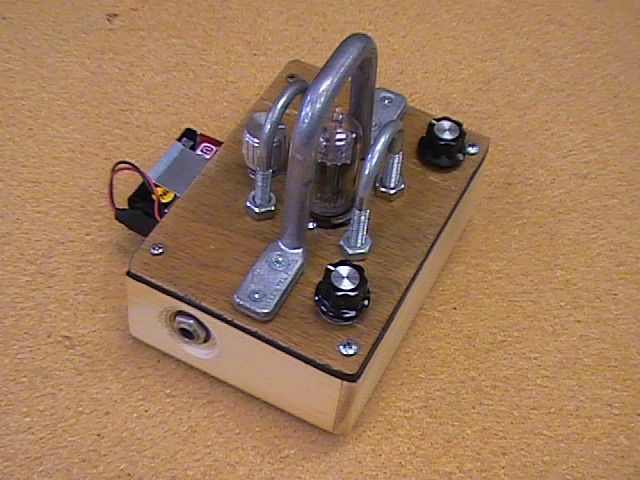

Speaking of the ValveCaster
Hello: Pardon the reference to an earlier bit of the thread. Here's the case around the Matsumin ValveCaster I just did over the weekend. The only other tube project I ever did that worked was the Real Mctube a few years ago: this one was fun and quick and it's all point-to-point hanging off the bottom of the tube socket...the tube guards are u-bolts and a phone company cable guide I found in my junk box. Painted inside with black shielding stuff I use in guitar cavities. It works, the sound is okay from clean to slightly dirty, and yes, it's limited, but for guitar, anything that's a little different is useful (like sticking a tiny speaker at the end of a plastic tube and mic'ing the other end just to find out what it sounds like). Expecting that it will eat batteries, I just hung a clip right off the outside for convenience. No artwork or "in" and "out" yet...it's cleaner without fake model names and all that anyway.
Oh man! Don't get me started on stomp boxes!
I love making pedals, I must have 6 or 7 that I home-brewed. That's what got me started on the whole tube amp building thing.
How's it sound?
