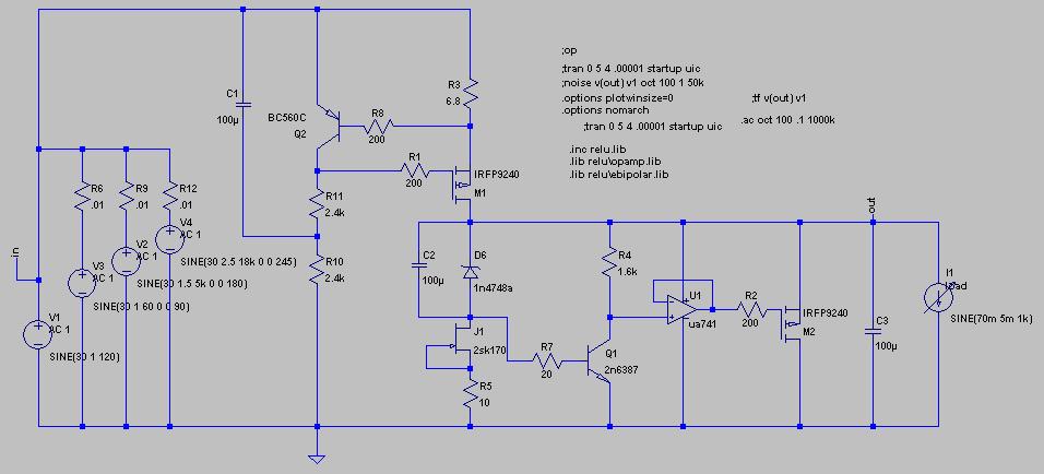

Something's bugging me. There is a large number of opamp driven shunt regulators similar to Syn08's design. No idea who invented the topology but the first implemenation i remember seeing was Allen Wright's SuperReg. All of these bar Manfred Huber's design run the opamp open loop. Is this good? How is overshooting? Performance at high frequencies should obviously suffer. Any comments?

The HF performance suffers mainly because of the output capacitor! This cap may resonate with the inductive output impedance of the regulator, to create a peak in the output impedance. This peak is also highly dependent on the opamp open loop characteristics. For the THS4031 and 100uF (low ESR) at the output, I was able to measure the resonance at about 900KHz (in good concordance with the simulations). Fortunately, the output impedance peak is only up to under 1miliOhm so everything is fine. Ideally, you should not use any output cap, but usually it's a trade.
The same applies to series regulators, however the parallel regulator seem to be more sensitive to this effect.
I'm not familiar with the Manfred Huber design, any link to?
Anyway, how's the thing working for you?
One thing to watch in the linked shuntreg schematic - that opamp is stable only for a gain of 5x or more. You need the OPA627 to stay with the same device family and operate at lower gain of the voltage reference - or another unity -gain-stable opamp

I finished something very similar to syn08's circuit last night, gave it a quick listen and let it burn in during the night. Used IRF610/9610 and OPA627s fed from a preregulated (317/337) 22v for a 15.5v output. Tried a very small output cap and eventually settled for 220uF Nichicon Fine Gold. The LED noise-cleaning electrolytic was moved across the LED as the circuit wasn't stable as shown (probably my grounding).
My subjective impression is very similar to yours: softer, less etched sound than the ALW, probably more suited for acoustic/classical music. Bass has slightly less weight but acoustic bass shows pleasing detail. Overall very high quality sound with possibly better highs than ALW but worse imaging and less PRAT. It then occured to me that these qualities may be attributed to the carbon oxide 50ohm ballast resistor. I am about to make simple CCSs using 317s and replace the resistor.
Needless to say, dropping the raw 30v dc down to 15.5v generates an amazing amount of heat compared to a series regulator.

After some experiments by member Ikoflexer on my reg for the Simplistic NJFET RIAA that I did in the analogue section, he arrived in a boosted hfe Darlington driver plus op amp buff version that simulated well and performed stably with very good results. Op amp can be your choice as long as the whole thing stays stable. Mosfets can be faster TO220s as well. You may try it if you fancy.

Try place shunt reg close powered circuit as close as possible....optimal few mm form it (preferably mosfet source directly to GND point). Also CCS but something better then 317 improves bass. With shunts layout and CCS play major role that's why to the best results shunts regs PCBs can't be universal boards unlike serial regs.
Great comments and suggestions but at the moment i am too excited about the difference the simple CCSs made. An almost complete transformation in bass and dynamics. Trouble is the sound now is too similar to the Jung/ALW :) Will have to do some more listening before other improvements.
This is not good, it changes the HF behaviour a lot. Better fix your grounding, 627 should be unconditionally stable.
Also, use separate grounds and sense the output at the load terminals.
These are things that are 1000 times more important than the output cap model.
