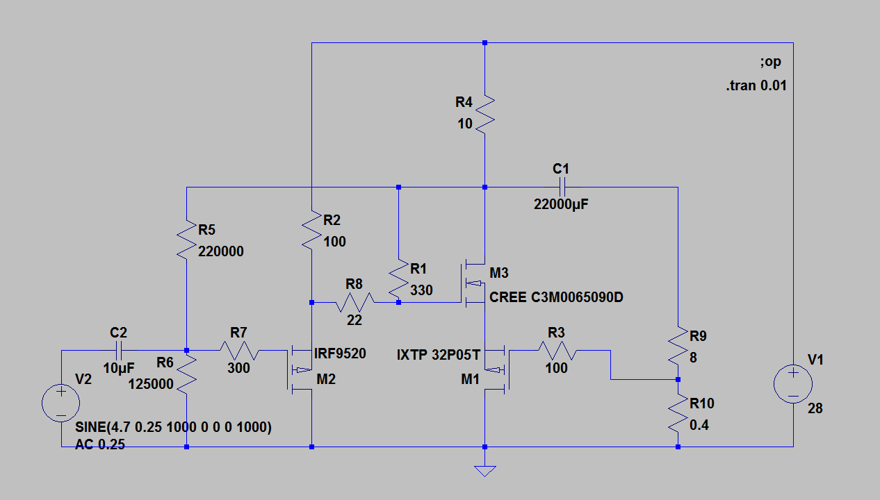

I built this little amp to evaluate the P channel buffer working at a low Vds = Vgs (-4,7 volts) and at the same time get some hands on quality time with a simple Mu follower modulated current source.
The mosfets in the sim is not the same as I use in my amp. They are what I consider reasonably near.
M1 is an Ixys IXTP32P05T and M2 is an IRF3706 in the real amp playing in the background as I write this.
I am astonished at the sound quality coming out of this very simple little amp.
I guess I get a watt or soo, which is enough with a large BIB and a high efficient 10 inch pro driver.
I am going to build a PCF Zen amp (soon), but I often find my self just listening to music without any need of any other amp...

After playing around with this circuit in LTSpice and IRL, and after spending some quality time working with it in my head while drinking tea and listening to Skinny Puppy and Ahmad Jamal (among many other musicians) I finally arrived here.
This is kind of semi-final product. Yes there is some second harmonic content. There might be ways to lower the THD if that is the goal (which it isn't for me) . I prefer a slight touch of second harmonic since this comes from the Schaded fet main gain device and the positive current feedback superimposing the character of the Schade-feedback back upon the gain-device again. This will make the amp sound much more similar to a triod. It is "SIT-ified" like the transformer-Schade-feedback amp Nelson Pass presents at BAF-2015.
With a 0,15 ohm R-sense the amp seems to have a very slight negative output impedance in simulation. I guesstimate that combined with the resistance in cables, the coupling capacitor on the output etc it will have a load-invariant almost infinite damping-factor. This is easy to adjust by changing the value of R4. 0,22 ohm R4 (R-sense) will give a pronounced negative output impedance in simulation. It is quite device-dependent.
I have not built this exact amp yet. I will not use the IRFP250 and the bottom P-channel fet is not a Si7461DP. As in any Zen-amp there is a considerable leeway in the choice of gain-devices. I will use IXYS IXTH140P05T2 for the bottom P-channel fet and IXTK100N25P for the N-channel devices. I am actually considering battery-bias for the MU-follower dynamic current-source. It seems like a neat and simple way to build a MU-follower. I am not very stressed by changing batteries once every 2 or 5 years or so.
It seems to work like a charm in simulation at least.

I will answer both of you with the same post, since they are quite similar.
I would not use IRFP9240 as the bottom P-channel fet.
With an IRF4905, IXYS IXTP32P05T or other similar low voltage high power P channel device the distortion drops substantially compared to the IRFP9240.
The Cree seems quite weak at low voltages so I guess it will behave somewhat similar to an IRFP240. Remember that the simple single stage amp is quite taxed by having to both provide lots of voltage gain and current gain and on top of this it has to control a highly reactive load with a very low output impedance.
(R3 should be a 1 kohm trim pot since this sets the operating point of the amp)
Here is a simulation with the IRFP240 and a standard Zen constant current source as in Nelson Pass original Zen article.
There is more distortion then I can accept. I can not really recommend this amp with PCF and the IRFP240.
With the Cree you need at least 50 volts power supply and 2 paralleled Cree SiC fets if you want to use PCF without to much distortion.
I like the Cree parts, but I can't get the performance I want from them at these low voltages. They sound marvelous as long as you don't demand to much from them though.
I am quite surprised by this as I bought several of them for this exact project.
Please built this amp as simulated above if you really want to try and you already have the parts (with either the IRFP240 or the Cree SiC fet), but be warned that it might not perform satisfactorily.
The IRFP9140 did not sound very good in a similar amp with PCF. At very low amounts of PCF it did sound quite nice, but did not provide a very high damping factor. The IXYS 32P05T is much better, and the IXYS 140P05T is a monster (in a good way).
If you want to increase the damping factor and lower distortion the Aleph current source or a MU follower is much better then a standard CSS.
