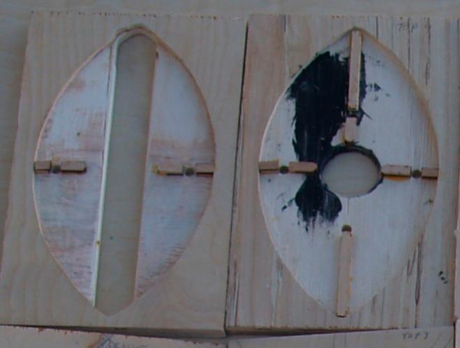

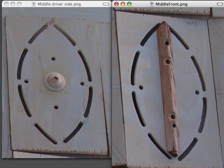

There are photos of my Paraline throat adapters in post #92, #207 has a photo of the finished cabinets, #314 compares the measurements of the Paraline to a conical horn, and post #589 compares my Dirty Dozen line array using twelve 25 cent speakers ($3.00 total driver cost) to the DSL SBH-10 using eight 5" coaxial drivers (probably over $1000 in driver cost). The Dirty Dozen response is much smoother than the SBH-10.

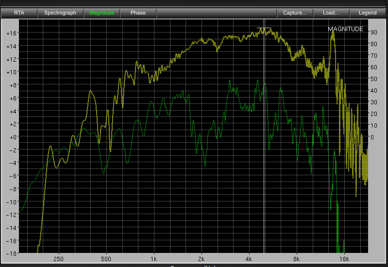

Note that Art says that "The Paraline is not particularly smooth, but has outstanding horizontal dispersion linearity on and off axis, and very narrow vertical pattern control, allowing multiple drivers to sum seamlessly.
The upper trace is a EV DH1A on a conical Maltese horn, the lower is a DH1AMT on a Paraline.
The driver's raw response may deviate slightly from each other, but the Paraline obviously does not appear nearly as "smooth".

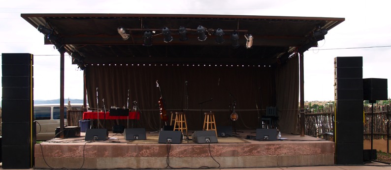

Having replaced the Maltese horns with Paralines in my PA, the Paraline's response in multiples, after EQ, is far superior.
That said, I see no benefit (and many down sides) of the Paraline over a simple conical horn (as used in DSL's Synergy horns) for home use."

Someone mentioned my Paralines a few days ago, and put up a link. The measurement shown, I'm fairly sure, is 1/6 octave smoothed. The response with higher resolution is absolutely awful.
I used them for about a year and a half, but really they were only good for background music.....if that even. If I can find the higher resolution plots I'll post them.

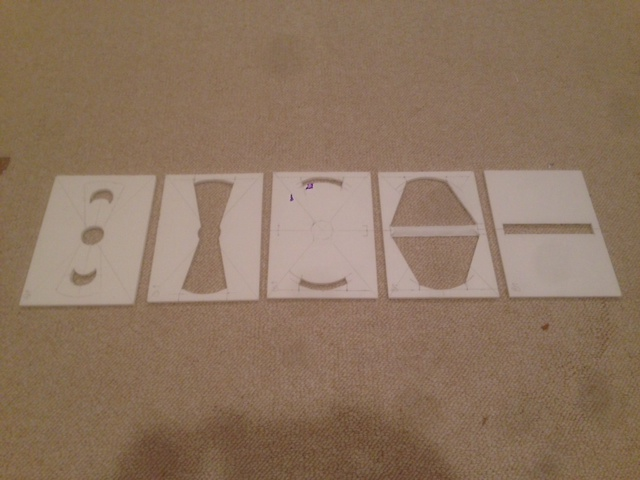

Nothing specific: The drawing was 25 inches tall and 48 inches wide.
Which is probably rediculously bigger than it needs to be. Also I drew
the layers 1/2inch thick. They should probably be less than 1/4inch.
The exit slot should have been only 1/2 inch wide, which means the
whole thing shouldn't have been taller than 24.5inches... So, its all
kinds of ways messed up (the drawing is). But the idea is still solid.
Just gonna to have to wing it on the specifics...
Find some sonotube you like. Make a panel about 1cm to 0.5in taller
than two sonotube diameters. Then draw a pair of 90deg (or whatever
coverage angle you wish) triangles, narrowing as they go away from
the exit slot. Then at some reasonable margin from the edges of the
panel, you need to draw two triangles back to the center to meet the
driver. Lastly you have to draw the lens that matches your triangles.
If the triangles are same, the curve is a flat line. Elsewise, you draw
lines that bisect the difference between one triangle's edge and the
other. And they meet somewhere way off the panel, but thats the
center of the curve you got to draw that will be correct at the outside
corners. As for the center, it might not make the optimum lens to draw
a simple circular arc, but its probably not far off.
