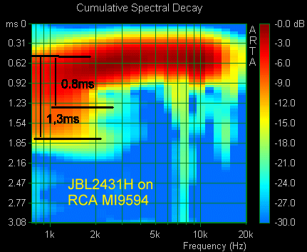

Hello EarlK,
Here is in attached file a CSD I obtained using Arta on the .pir file of the JBL2431H on a RCA MI9594.
What is noticeable is the long resonance (may be due to a reflection) between 7 and 8kHz.
Also noticeable is the group delay rise below 1.8kHz which is interpretable as the effect of "strong" reflections after 0.8ms and 1,3ms.

One consequence of what I brought up is, that Fourier analysis on such issues might not exactly be the best idea - simply as time invariance exactly in the interval we are most interested in for those "comb filter honk" is not a given.
Being no "math head" - as you know - I easily could be wrong of course...
So I'd like to have that wavelet analysis available - simply for comparison and being able to chose what I think visualizes best when I "press buttons" (stupid monkey I am 🙂 )...
Michael

ps 2 ; I'm using ARTA 1.6.1 and I can not make my CSDs look like JMs / but then , I figure it's my lack of experience with CSDs .
Hello EarlK
If you are talking about your posted plot it looks like you are not gating before the pulse or after your first room reflection. You also are using a different dB scale for the decay. Try to match his period for the measurement and decay scale and see what happens. Hope this helps.
Rob🙂
Rob🙂
