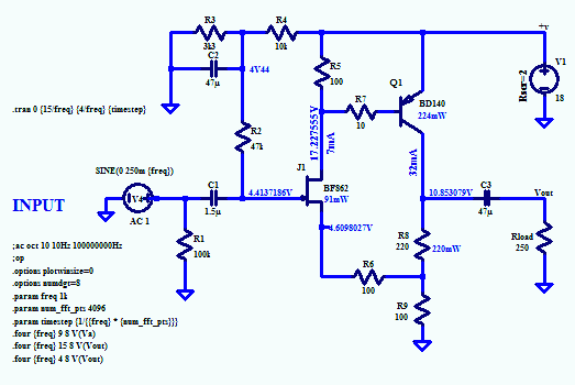

Another two transistor amp - this one has a FET input and a BJT output with a niceness knob that lets you dial in the harmonic profile. Thanks to Aksa for design.

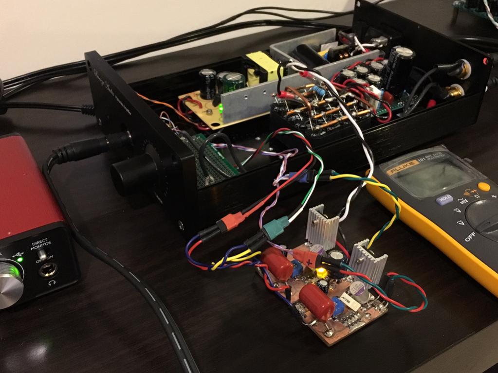

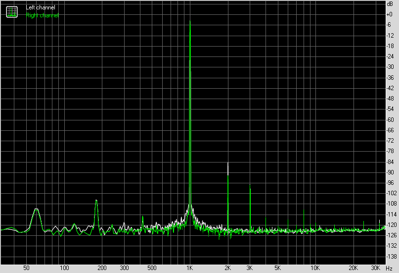

My new JFET-BJT amp is now tweaked for high bias hot running (135mA) desktop use. With a BF862 on input stage and Toshiba 2SA1837 driver on the output stage and 20v power supply - the sound is incredible. Amp matches simulation for harmonic distortion measuring in at -84dB for H2 and at -96dB for H3 and nothing else, with a measured THD of 0.0037% (37ppm) while driving 700mV into 270R load. All on 2 transistors and made possible by the superlative 2SA1837. These are at EOL but still available for $0.70 on Mouser.
http://www.diyaudio.com/forums/solid-state/301164-mosfet-source-follower-headamp-34.html
I am using a 24v SMPS and mosfet cap multiplier followed by a low ESR cap bank.
This is my new reference headamp. The 2SA1837 is the new King - giving the LU1014D nothing to claim but higher current - not needed here in a headamp.

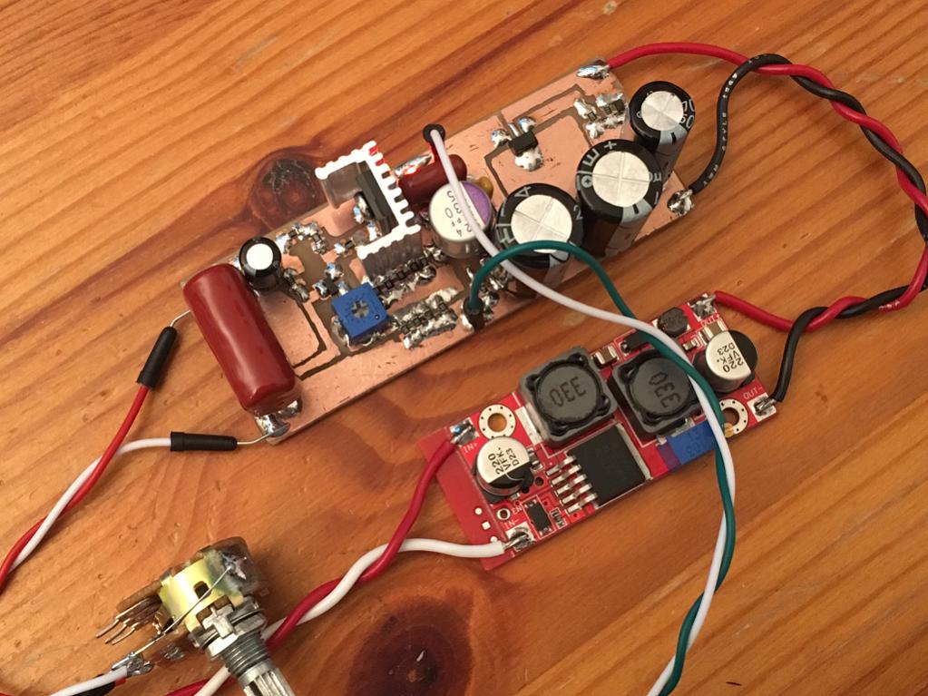

Update on the thermal issue with the resistors. It's no problem now - in fact I think I found a good way to make very low inductance precision power resistors. Just use a PCB with two wide copper pads (bar shaped) and solder the needed 1% SMT resistors across them in parallel to achieve desired value and thermal rating. And as I found out, bond the bottom of the PCB to a heatsink with a thin layer of silicone RTV and the whole things stays fairly cool to the touch. What was too hot to touch is now just warm.
In my case, I made a precision 1% 1.5w capable ultra low inductance power resistor for cost of 5 x SMT resistors ($0.04).

I ended up etching a small board with some pads to manually measure Idss by pressing the part onto it. That's the only thing about this amp - the need to match so many JFETs. They need to match side to side but not top and bottom.
