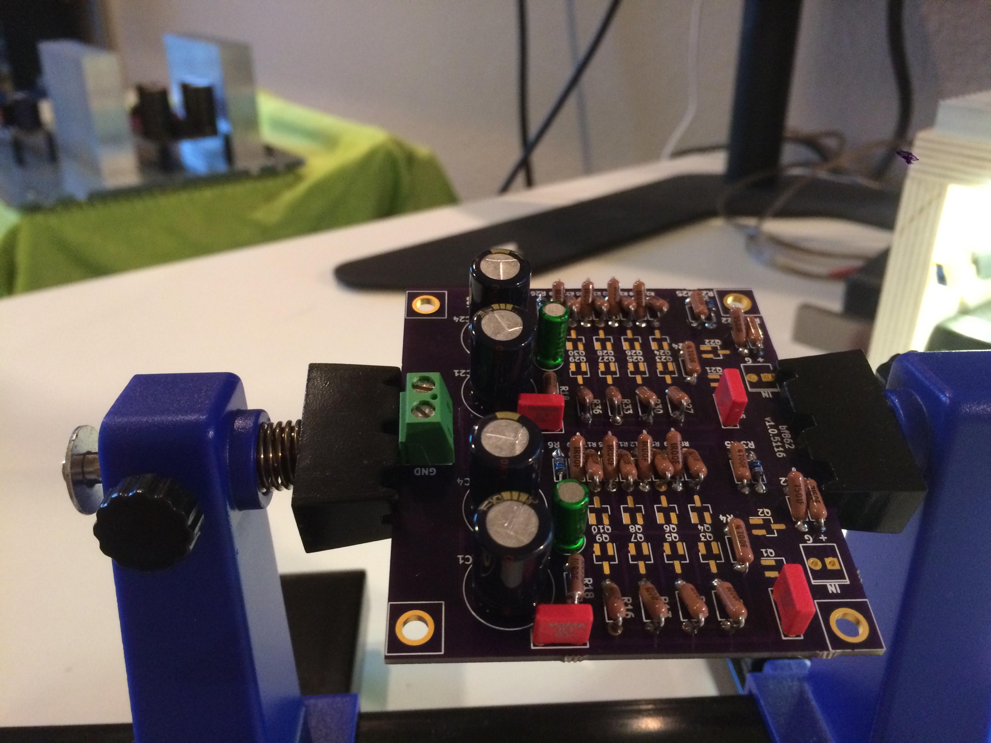

Update on the thermal issue with the resistors. It's no problem now - in fact I think I found a good way to make very low inductance precision power resistors. Just use a PCB with two wide copper pads (bar shaped) and solder the needed 1% SMT resistors across them in parallel to achieve desired value and thermal rating. And as I found out, bond the bottom of the PCB to a heatsink with a thin layer of silicone RTV and the whole things stays fairly cool to the touch. What was too hot to touch is now just warm.
In my case, I made a precision 1% 1.5w capable ultra low inductance power resistor for cost of 5 x SMT resistors ($0.04).
