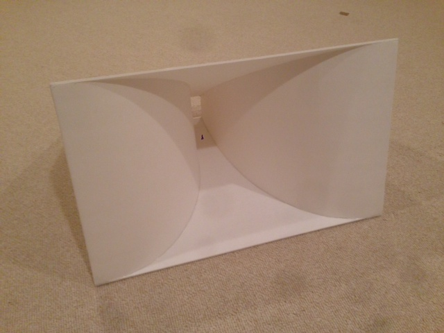

175Hz tractrix horn spreadsheet
Here is the spreadsheet with values that I used for the full sized 24 in wide horn with the 5MR450NDY. Scale this by 0.70x and you have the horn used in this thread.
It's the tab called "Rect. Horns by Throat & fc"

How to build tractrix profile in foam core
In case you missed it, the steps to making the tractrix are detailed starting here:
http://www.diyaudio.com/forums/full-range/259293-prv-5mr450-ndy-fast-applications-post4033907.html

Cut plan for full scale 175Hz tractrix for 5MR450NDY
Note that these directions are for full scale horn. For 0.70x scale tractrix synergy, scale pdf dimensions by 0.70x and flat panels by 0.70x. The scaling should be such that throat dimensions are 2.00 in x 2.00 in square.
Assuming you are building this using standard 3/16in thick foam core panels. The flat top and bottom panels (before trimming to follow curved walls) are 22.4 in deep x 28.0 in wide. At the centerline of 14.0 in mark of 2.78 in/2 or 1.39 in line on each side of the centerline - this is where the throat will be glued. The mouth is glued tangent to the front edge for the first inch or so.
Start by gluing the throat section along a 3 inch long segment. Then glue a 3 inch segment of the mouth. As the hot melt glue sets, force the remainder of the edges of the curved wall to be flush with the flat panel. The anchoring of the throat and mouth and edges forces the tractrix shape to form automatically. Then add a bead of hot melt glue on inside and outside of joint between curved and flat walls. Repeat for opposite curved wall onto same flat panel.
Once both curved walls are glued onto one flat panel, repeat process by adding the other flat wall and start from throat to mouth, then middle. Note that the dimensions of the throat are the *inside* dimensions so shift foam core accordingly by 3/16in.
Before gluing the curved panels, use a long straight edge and razor to score cuts that just pierce the top layer of paper on the *concave* (outer side of horn wall). Make parallel cuts every 3 to 5 mm spacing perpendicular to horn axis. After cuts are made place scored piece on soft carpeted floor with cuts face up. Use a 4 to 5 in dia cylindrical object to roll on top of panel while gently using hands underneath to bend panel along the curved cylinder a little at a time to form it into a curve - to pre-bend it so it easily forms to the tractrix shape when glued.
Print the pdf to a full scale drawing by using the "Tile" function in Adobe Acrobat. Select the scale so that it prints the final drawing with exactly 1.00 inch shown on the grid. I found that I had to apply a 0.95x scale in Adobe Acrobat to get 1.00 in full scale with most printers.
Thus for the 0.70x scale horn, use a 0.95 x 0.70 = 0.665x scale in the Adobe Acrobat "Tile" print. Then tape the tiles together using the grid marks. Lay the drawing template above foam and use a pen to pierce little holes and leave divet on the foam every inch or so. Now hand sketch the curve on the foam following the divets. Then use a razor to cut following those lines. i find an xacto best for these curved cuts. Go slowly just enough to pierce paper on first cut then slowly apply more pressure. I use 4 to 5 strokes before going through the foam. I find laying foam on Berber carpet makes a great cutting mat.
Good luck!
Good luck!

I made the throat diagonal match the dia of the cone Sd. Which geometrically gives something closer to 64% of Sd. This was my attempt at making it as big as possible to allow HF through but not physically larger than active Sd diam.

Yes, there is a slight constriction before expanding - it is important to keep. I have that captured in the sim. The construction will have a very slight angle to constrict after throat. Thanks for asking as I forgot to mention this is post 94 above. When gluing the initial throat anchoring angle the wall or taper to get the constriction. Maybe 1.5 degrees or so - not much.
- Presenting the Trynergy - a full range tractrix synergy.
