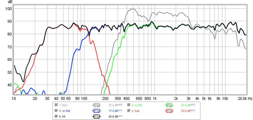

The Faital's arrived. Nicely made and perfect gasket for horn mounting without need for spacer to prevent surround rub. The 3FE25 has a huge magnet about same size as cutout dia. The 3FE22 has a tiny Nd magnet but is supposedly same Bl. The latter has Qts of 0.36 and rising response so I will try in horn first.
Initial setup shows raw response is about 11dB more sensitive than TC9FD. This allows me to use low shelf cut to balance with mid woofer rather than extreme boost on HF. Here is initial EQ and raw (grey). Still very rough but initial listening impressions are very good. The HD is very low and vocal clarity is excellent. I think there is some residual ringing at 15khz that may need to be dealt with.
Since the EQ is mostly a negative cut, the cone movement is extremely small and HD correspondingly is smaller. This horn can get very loud now with any power applied to it. The tractrix horn does an amazing job of loading this cone. At uncomfortably loud SPL I can barely feel the cone moving - almost have to ask myself is the wire even connected. You know it is because you hear it but you can't feel the cone moving.
Only had time to listen to 2 songs and both sound very nice. The quality of the sound is very clear and with lots of headroom for dynamics due to the high sensitivity. My mic clipped at 1m away and same voltage applied as TC9FD. Had to reduce excitation by -5dB to stay out of clipping.
Going with this driver the horn is $60 now. :)

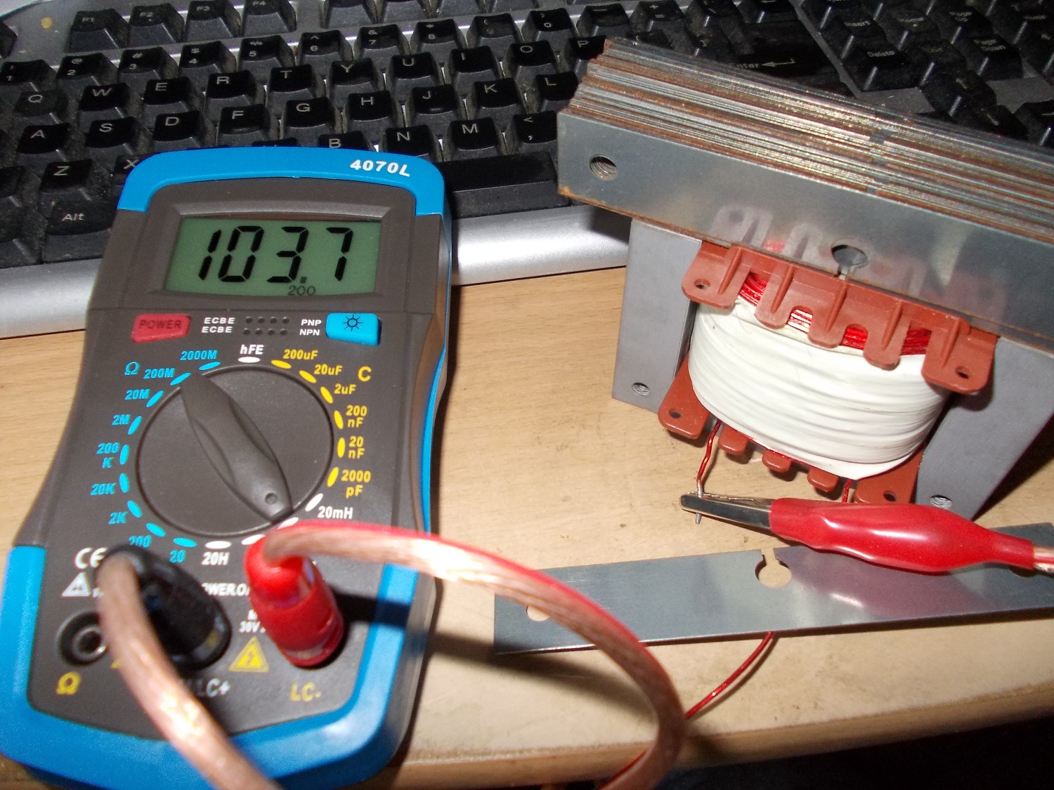

I do NOT use a dsp, everything go analog, only tapped horn has own amp, this is possible when woofers are lower in efficienty then high
then I can use L-pads, analog can be a pain in the *** nut i do like to go on with that, I have nice transformers made
who have adjustable induction..
regards
kees

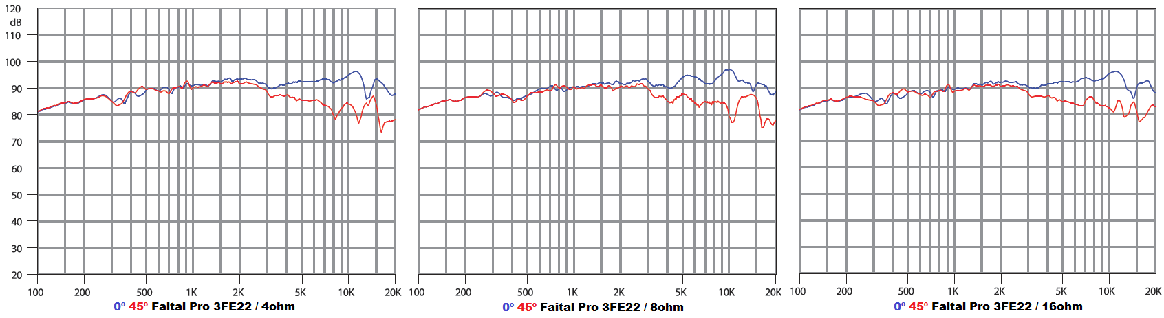

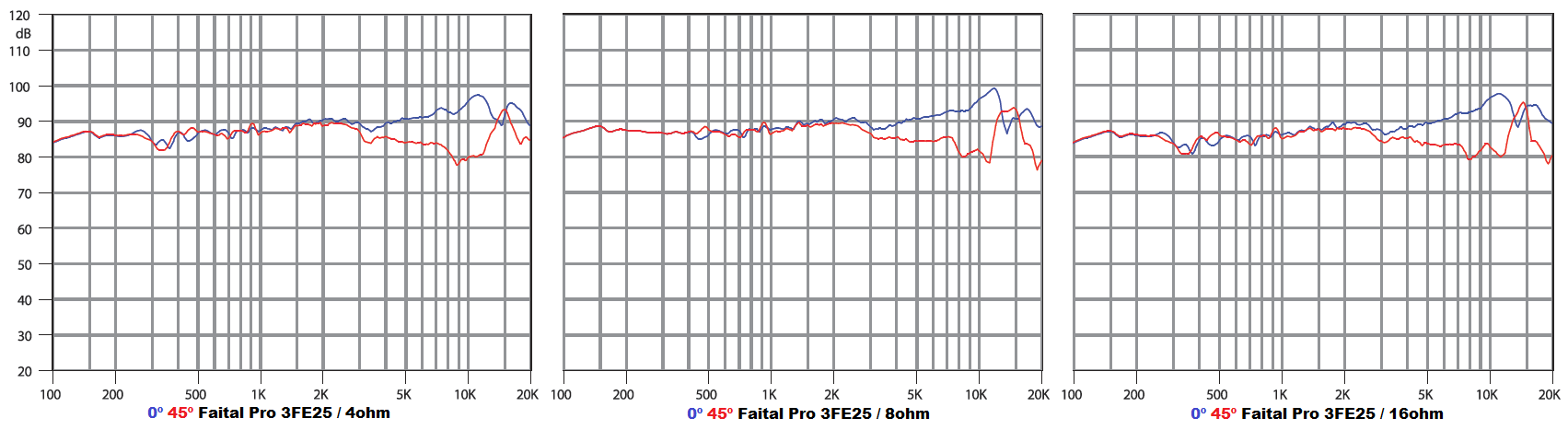

Taken from Faital Pro datasheet 4/8/16 ohm side by side frequency domain 0º/45º 0,1-20Khz both 3FE22/3FE25 i made for own info, attach here if interest.
