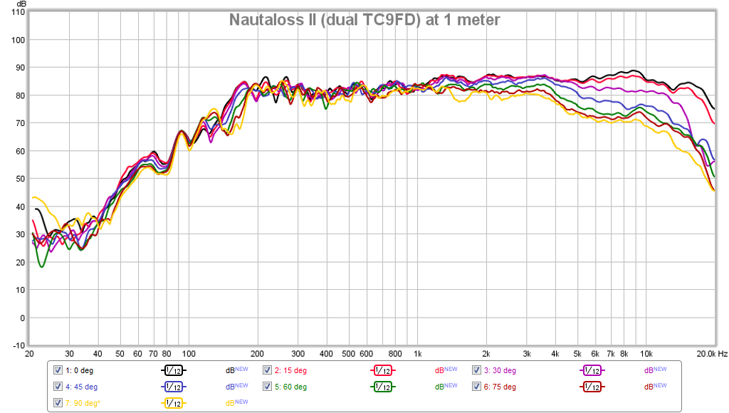

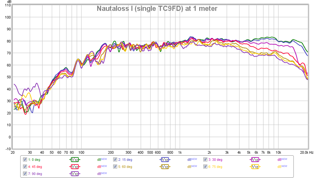

Polar data for Nautaloss I & II
This is posted in a different thread but for completeness I am putting links here for polar response data from 0 deg to 90 deg measured 1 meter away for both the Nautaloss I and II.
Nautaloss I:
Nautaloss II:
