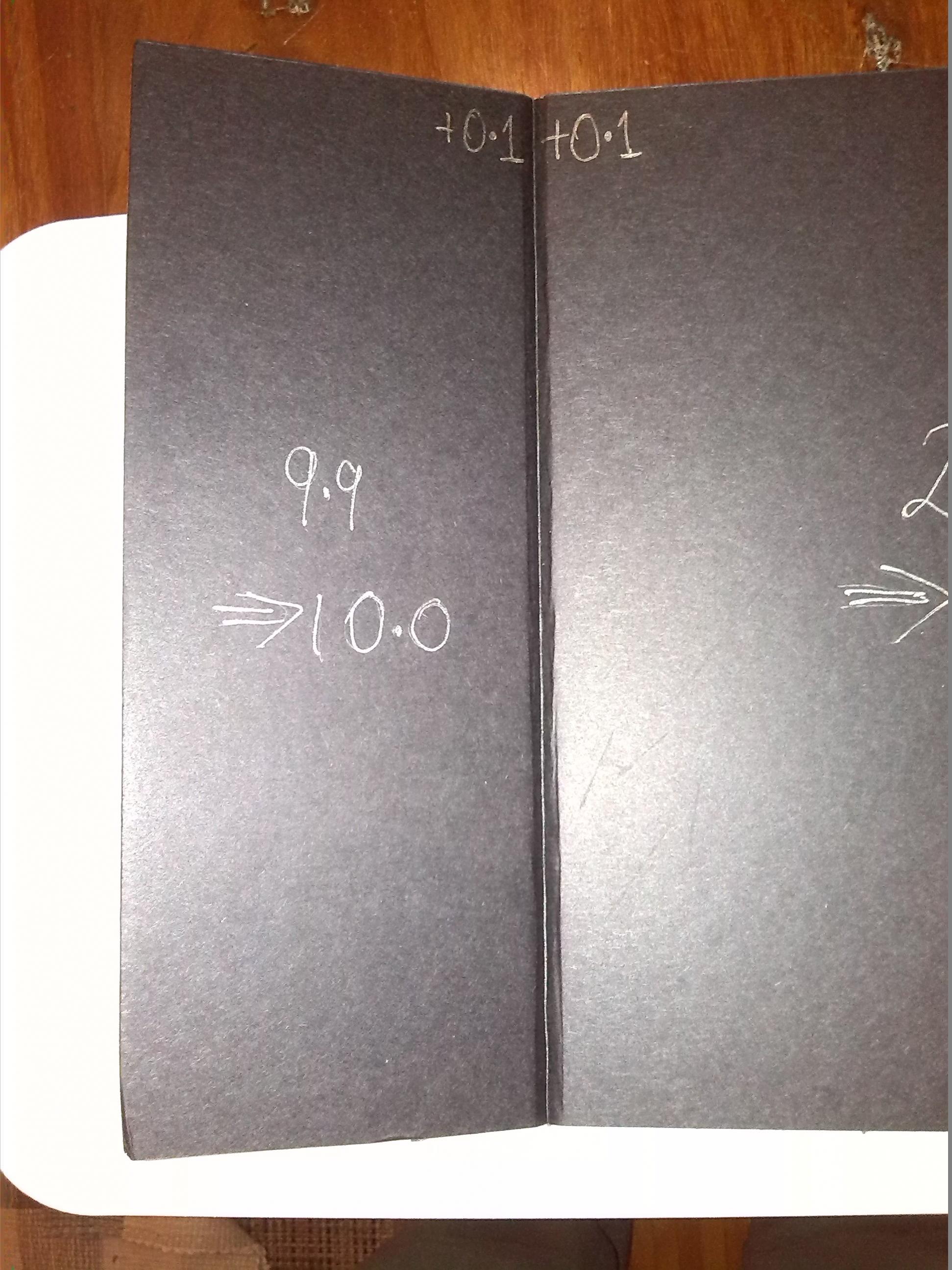

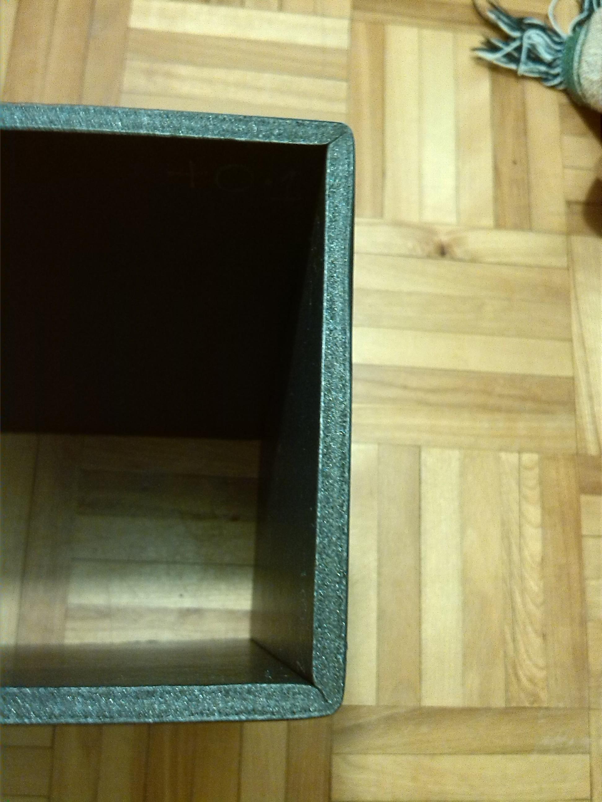

Grandcalmar,

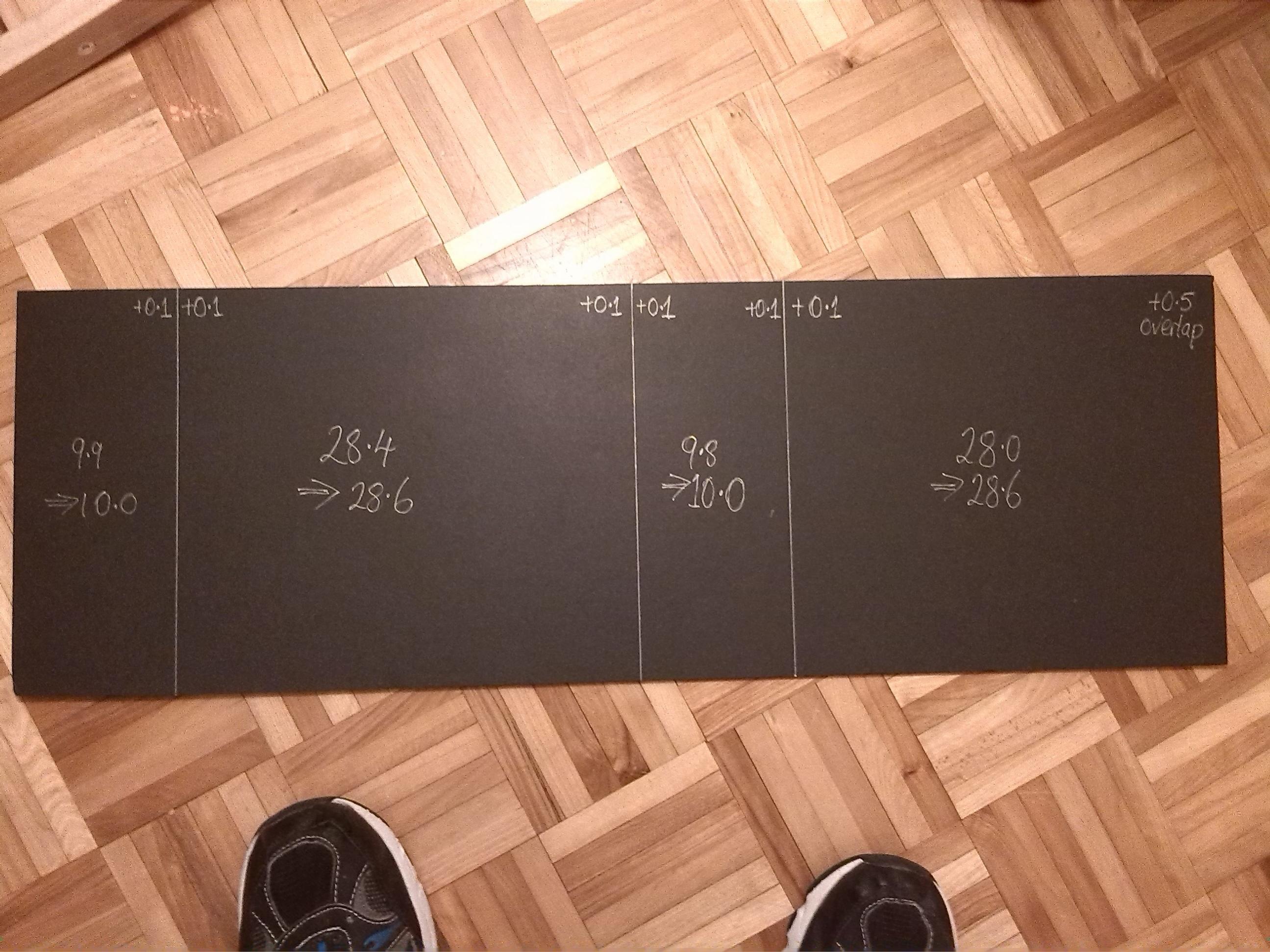

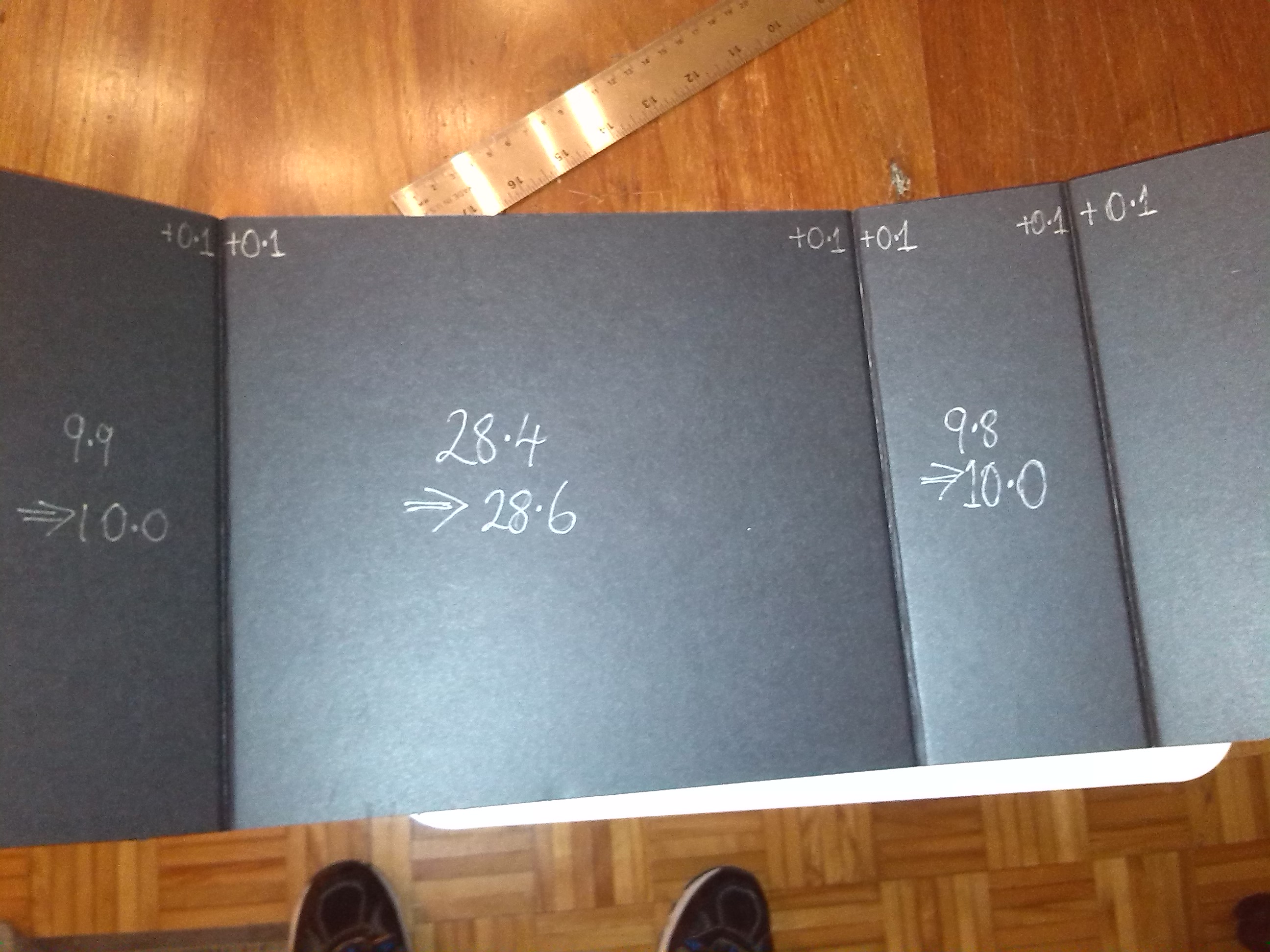

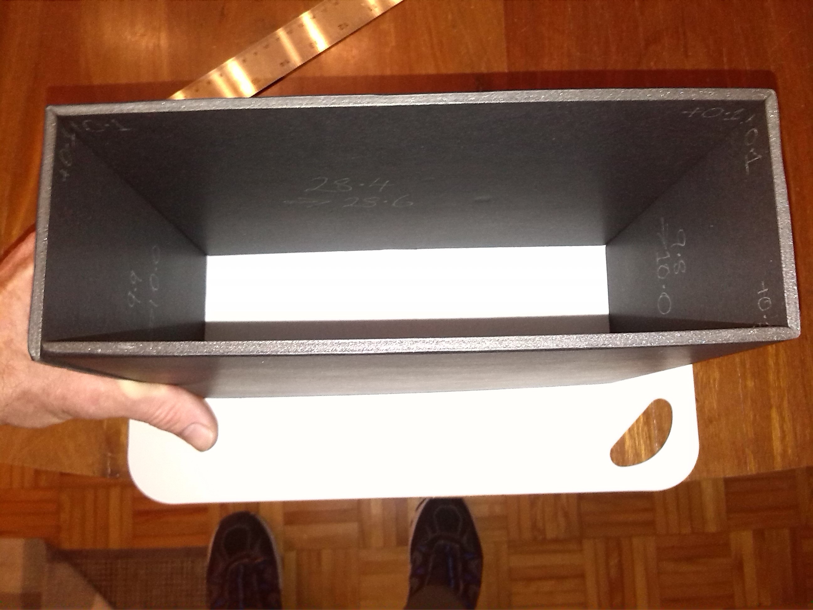

Can you show a picture of just the side with folds? I think I see it but not totally clear where the scored line is.
X,
Please see the attached - I hope it makes it a bit clearer. The first photo shows the marked-out cut-lines. The FC is nominally 30 inch (or 76.2 cm) long, but I've seen some small variations, so my cut-lines assume a total length of 76.1 cm (and I trim the length if required). Each fold adds about 1 mm to the outside dimension and, depending how the one glue joint is configured, the thickness of the FC (5 mm) needs to be taken into account. I quite like this way of making "the box" - only one glue joint (for 4 of the sides) to worry about and nice rounded corners, but it's obviously limited by the length of the FC board - perfect for my Nautaloss though

Thanks for the photos - much clearer now how you did it. Nice technique and saves on a lot of gluing joints. I will try it on my next box.

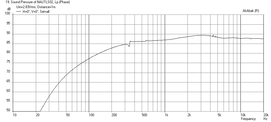

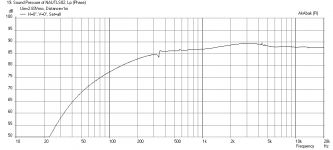

Unrolled Nautaloss - the "Dagger" with FE103EN
Here is a design for an unrolled Nautaloss called the Dagger for an easy build using flat wood panels. This design is for Cradeldorf who is interested in using FE103EN's.

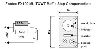

The sim ended up with a 8 in tall x 5 in wide baffle where the drive mounts and the Dagger is 35 inches long. This driver will need a BSC (0.9 mH and 6 ohm) to keep the XO below 1 kHz. Without the BSC, the roll-off starts too high and the woofer will be expected to go up to 1kHz. Maybe this is OK but I was thinking more of a FAST-style alignment.
Okay cool, I'll give it a shot this weekend and then report back. Thanks Buddy.
I'm gonna screw it to the outside since all I have are Erse super q inductors. gonna need to source the resistors though. wouldn't the crossover that's built into the subwoofer do this?
