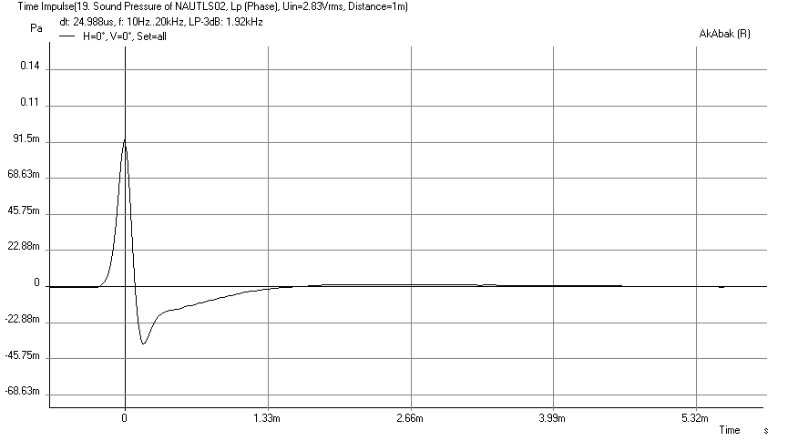

Here is the impulse response - you should get very clean dynamics with this speaker. Looking forward to seeing the Dagger in action - maybe another Youtube vid?

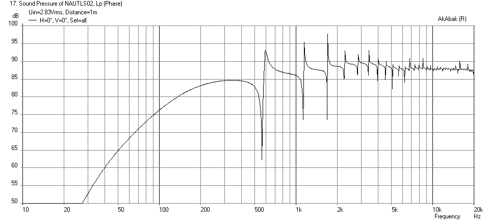

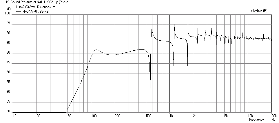

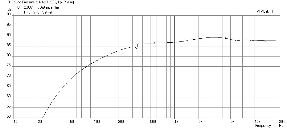

I think you may want to at least try building a Dagger to compare - it's just a few glue glued joints and a little bit of lumber. The performance difference between the Dagger and your PVC pipe speaker, according to the sims is substantial - there are a lot of back wave reflection issues. Here is the predicted performance of 4 in PVC pipe that is 12 in long with 0.5 Q with 0.9mH+6R BSC. The second plot is what happens when you add 68uF in series with BSC - not the smooth roll-off you want and not occuring at the 300 Hz you want.
4 in x 12 in PVC:
with 68 uF:
Compared to the Dagger tapered sealed TL design (without 68 uF):
